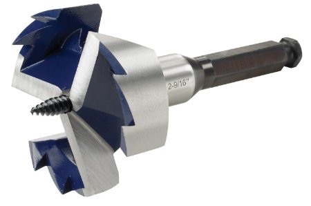

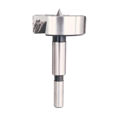

a forstner bit will work, if they make them that large. i know wood furniture people use them all the timeView attachment 428138
Yup, I looked into that. But since I can't use a drill press I would have to make a piece of wood with a hole in it to screw onto the post to get the Forstner started into the post. They can be wicked until you get them going good. Plus, I can run a hole saw with my battery powered drill, and the Forstner would need added ummppp and the associated wear and tear on the person horsing the drill. Most of the Forstners are fairly short, so I would have trouble getting thru the 8" post, don't know if they would put up with me predrilling a guide hole, either.... :)
i use a 1-1/2" forstner alot to mske holes when running 4/0 ser cable in houses. Drills thru double 4x4's like butter. Spits all shavings out. I use a 6" extension bit with my milwaukee hole hog set to low end. The self feed tip pulls it right thru.

Flatten the side of the post. Get an extension. Lots of room. Then drill.

I " plan " on setting the end posts... probably concrete them. Then run a line at the height I want to run the pipe. Set the interior posts, probably just in pea gravel using the line. Putting up three sections, two level runs about 24' and one downhill about 35' or so... Going to snap a line at the rail height, then try to get the pilot holes line up best I can. Maybe shoot a laser from the first end hole I start with. Then drill the 2 1/2" holes using the pilot. 2" pipe is 2 3/8" O.D. which will give me a little slop up and down, and I can turn the posts in the pea gravel a little if I am too far off in that direction. I have some normal 2 9/16" holes saws, and could go bigger on the holes if I find it is not working. Little flex in the PVC pipe, and tiny bit in the old well pipe. Even the couplings on the 1 1/4" well pipe will fit inside the 2" PVC. Worst case, I can hog out the holes a little more. Then cut off the top of the posts to the right height and probably cap with something. I usually use pieces of old aluminum lic plates or some scrap aluminum to keep the top of the post dry, but have not come up with what I am going to use on these yet. Want to make it fairly presentable since it is out by the road. That's why I am running the old well pipe in the PVC, don't like to paint... :) Another option is to dig the holes, predrill the posts, assemble the fence, and then level the posts/fill in the post holes last. Kind of like some folks put up split rail fence..
