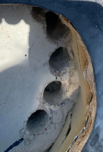

I glad to say, I got the vent in. I used a 1 inch drill to make the perimeter and a 1-1/2 drill for rows in the field.
With large holes, my drill on chisel mode fit in the holes and busted the webbing.
All was going good until I hit a 1/2 inch re-bar. But I exposed it and cut it off.

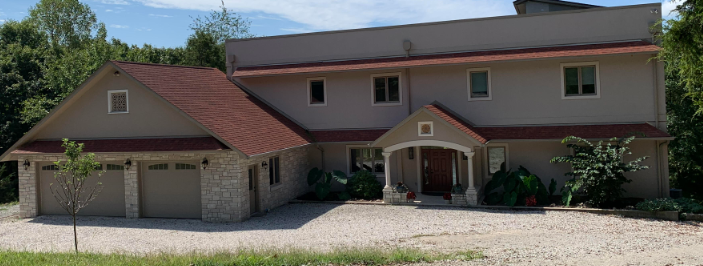

Yes, our house is made from ICF blocks. walkout Basement and two floors above. Flat roof with a staircase to it. Future roof top patio over looking a large Indiana lake.
All but some interior walls are ICF poured concrete, 450 cubic yards of concrete. All floors including roof are poured concrete on steel bar joists, Hambro steel joists from Canada. (we went to the World of Concrete in Las Vegas and got hooked) Heat is radiant in slab.

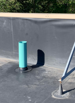

Photo of ceiling before drywall went in. Glad my wife took a zillion photos as we built. But 4 vents in a small place, to close for all the boots. Combined the 4 in and 6 in bath vent. Moved the dryer vent to be straight up above dryer. So just two boots made in this area, 6 inch bath vent and 2 inch sewer vent
I drilled a hole from below to get exact location on roof

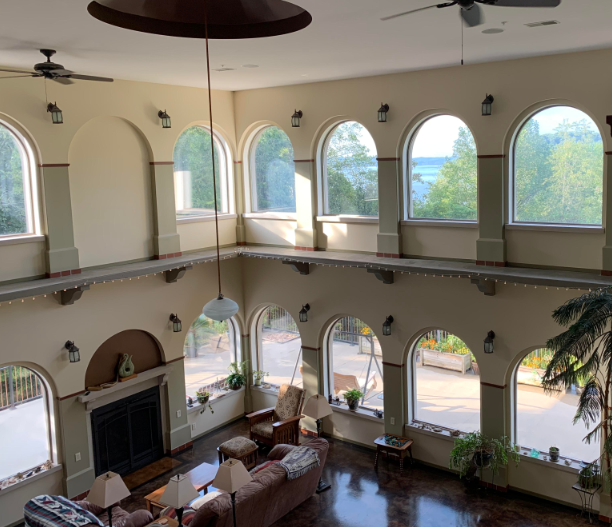

view from inside. Arches are 8 ft tall, 5 ft wide. All formed in concrete. 30 ft by 30 ft, 23 ft tall

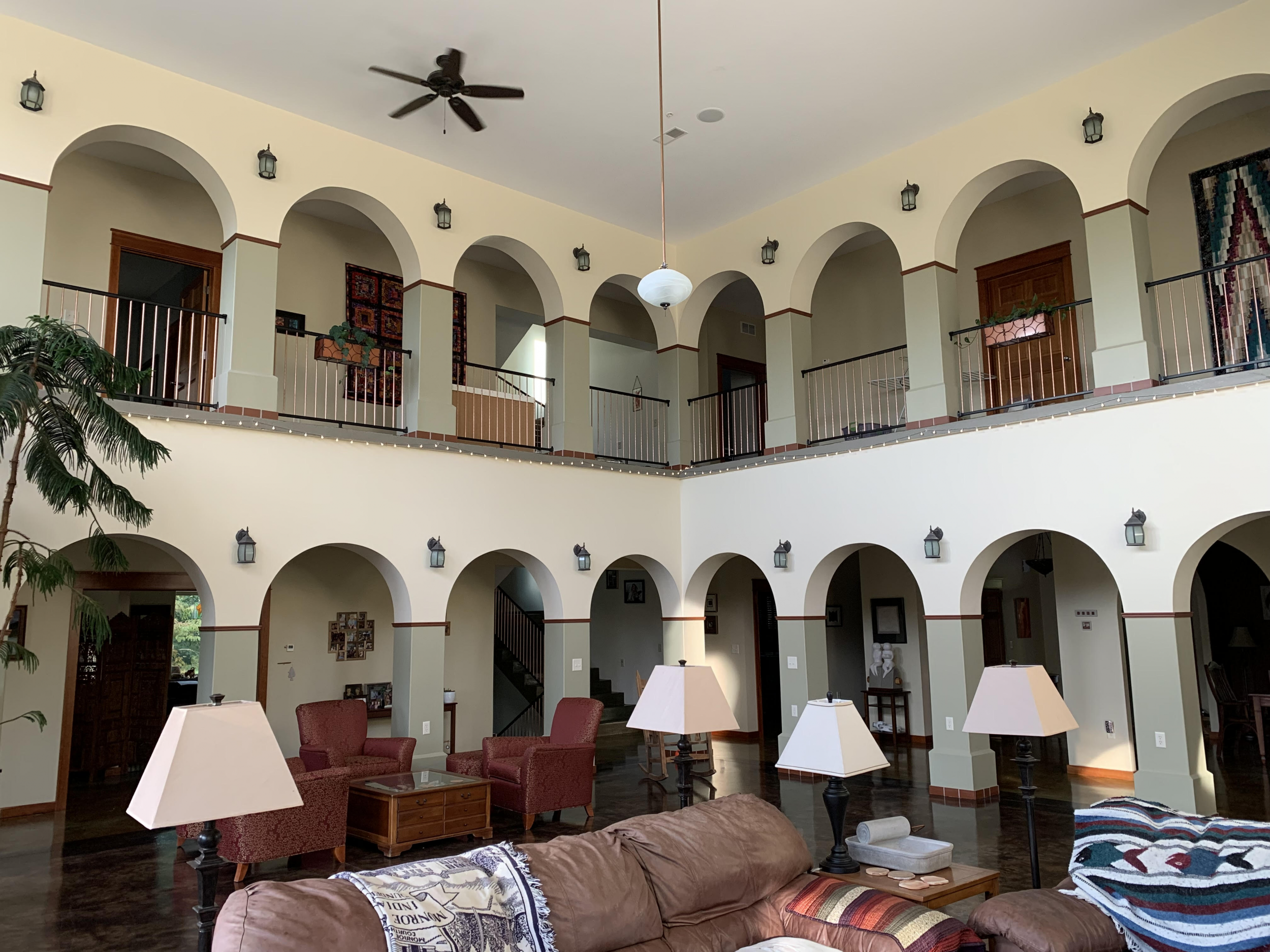

View facing lake, stained concrete floors throughout the house
