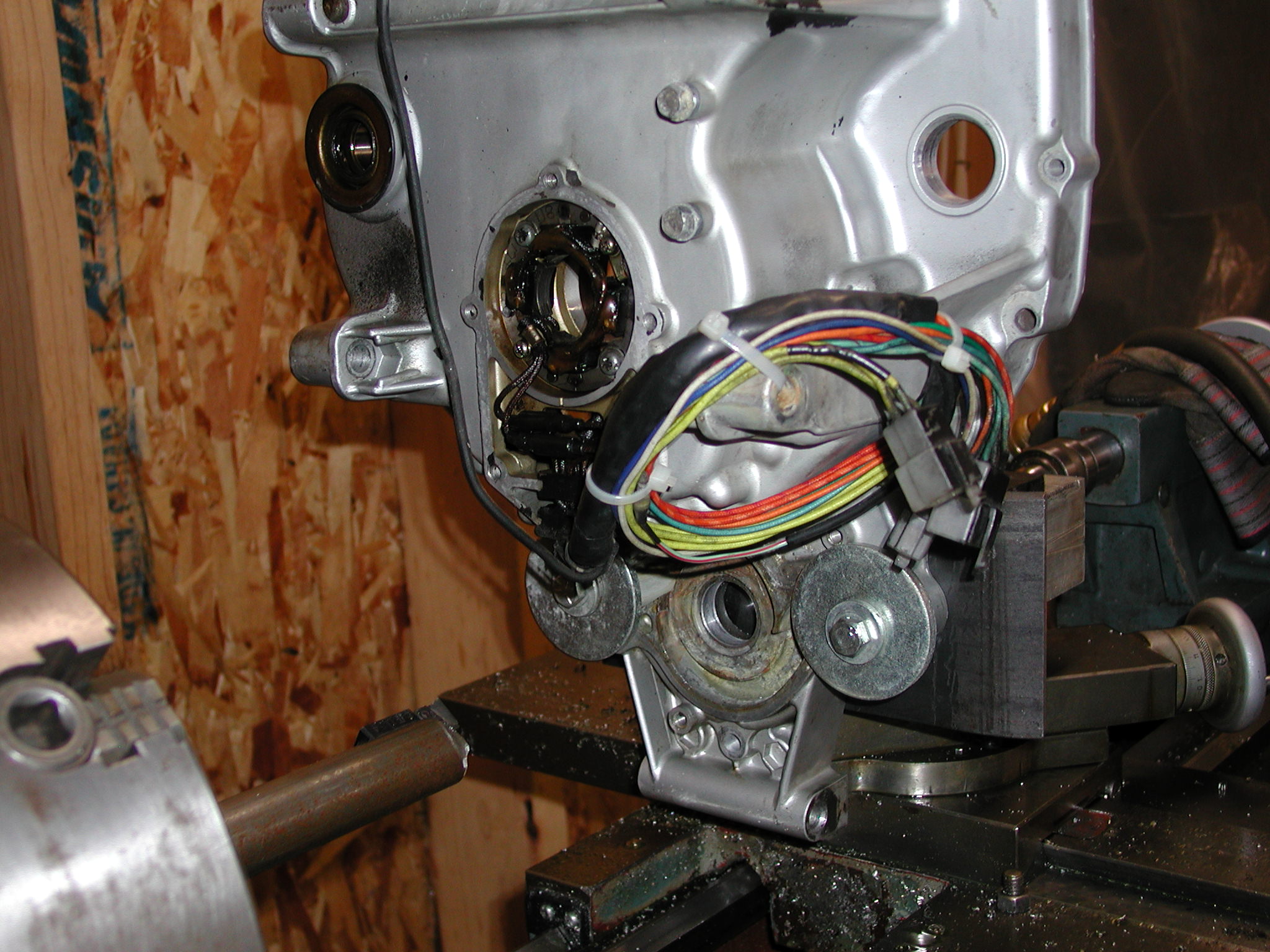

Here's a picture of me boring out a motorcycle engine cover for a different size water pump seal. It's bolted to a makeshift angle plate, and the boring bar is in the chuck. The engine is in my garden tractor, so maybe it's ok to post it on a tractor forum. Image016.jpg
