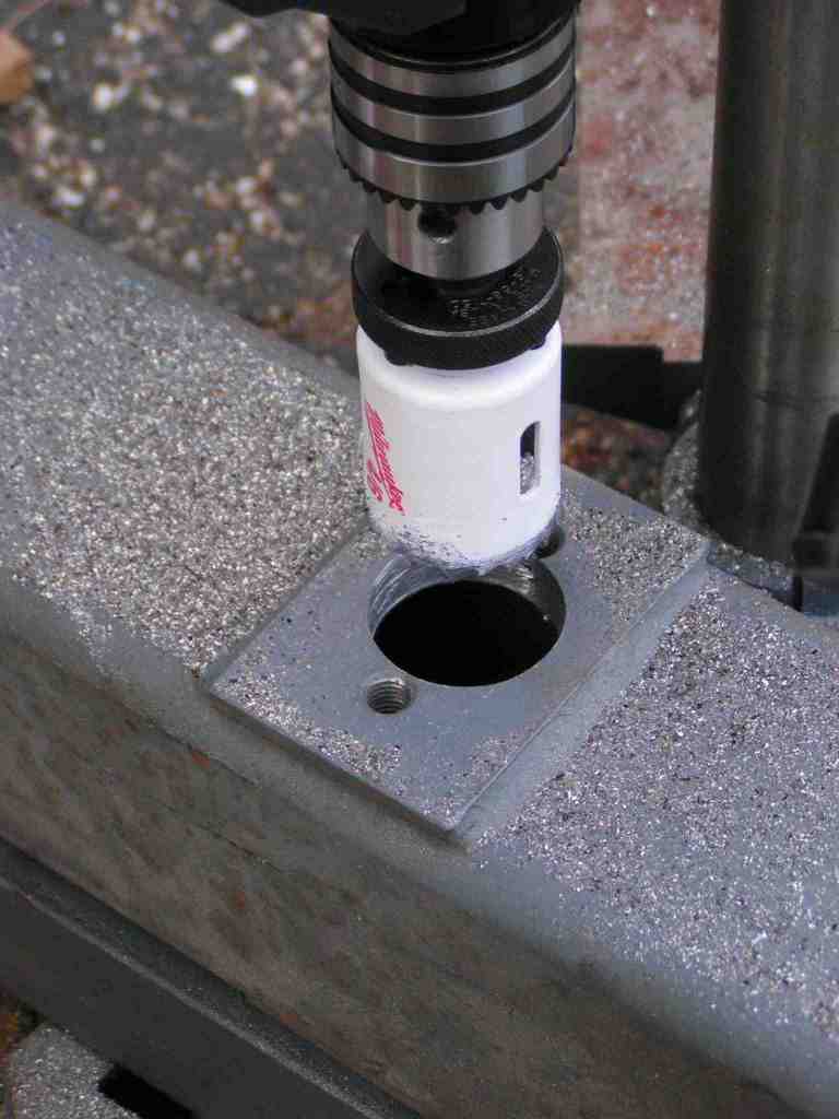

I have that same drill bit set from H.F. It is O.K., but you need a beefy drill press to work those big bits. The $39.00 drill press from H.F. does not work well for this. The reason? When you put any significant pressure on the lever to lower the drill, the table supporting the work piece flexes! This results in an off centered and angled hole.
I have had great success on my backhoe project using Milwaukee bi-metal hole saws. The arbor with pilot bit was $14.00 and the hole saw blades are about $9.00 a pop for the 1.5" hole(see picture of 1.5" hole through aobut 3/8th of steel here). The arbor for the 1" blade was under $10.00 and the 1" blades are about $6.00. I use them in the crummy drill press and they don't take much pressure at all. Another advantage is that when you get to the bottom of the hole, it goes through with no trouble. With a normal drill bit, there is a tendancy to grab that last bit of metal and it takes some work to get through. I find this is especially true if you are using a hand drill instead of a drill press.
