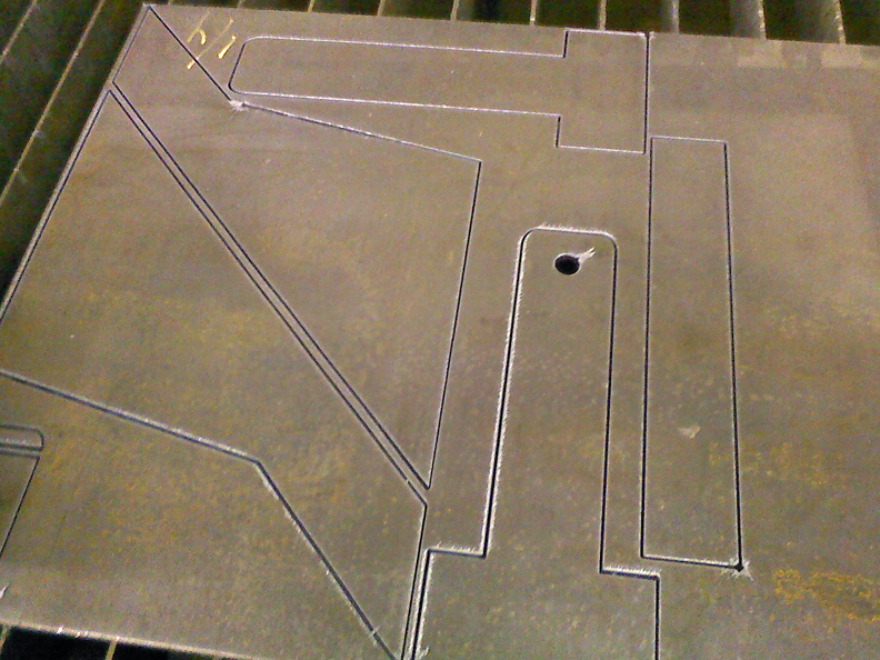

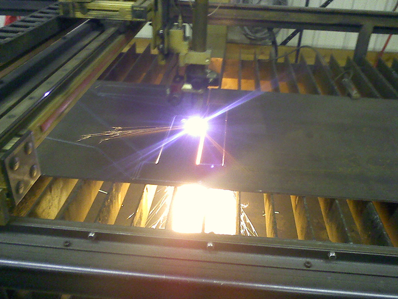

I don't drill many holes anymore......since I put the cnc plasma in my shop. On very small holes I will cut them undersized and then drill (ream) them with a cobalt drill (due to the nitride hardening that an air plasma creates on the face of the cut).....but on most holes 3/8" and above the holes are acceptable for use as bolt holes...and are accurately positioned by the cnc.
A few pics of parts/holes cut on my cnc (a PlasmaCam cnc machine with a Hypertherm Powermax85 plasma, also have a TorchMate cnc with a Hypertherm Powermax45 plasma).
1st pic, 3/4" steel with 1-1/2" hole. 2nd, 1/4" steel with holes from 3/16" to 3/4". 3rd 3/8" steel with holes from 3/8" to 3/4" Last pic, a bracket cut from 1/4". The tapped holes were plasma cut to .188 then drilled with a .201" cobalt drill (to remove the hardened surface), then tapped 1/4"-20.
