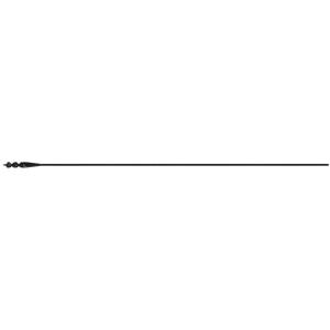

Homedepot sells an electrical drill bit attached to a 5 - 6' piece of steel drill shank for about $38.00 as i recall. i have several if them myself, but have never drilled thru that thick of a log. i use them for drilling from either an electrical outlet or a switch box inside the wall and thru the plates.
Klein Tools 9/16 in. x 54 in. Screw Point Flex Drill Bit 53718SEN at The Home Depot 3da8087a-c711-4bab-ac92-d48c702ead1b_300.jpg
