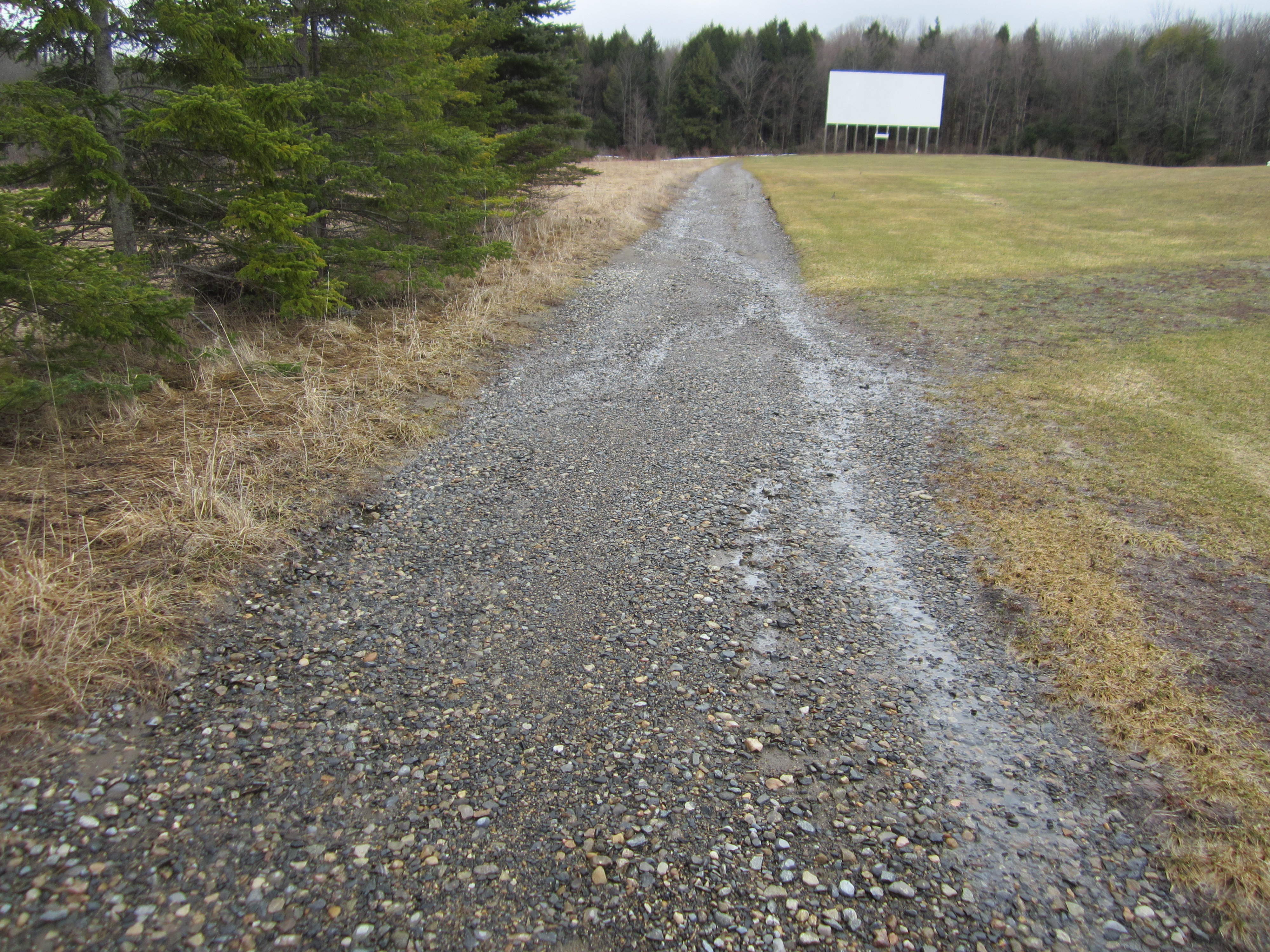

be careful if drive in is old lot, and rock lot is worn down, you may be at higher risk, of snagging a wire or like going to individual speaker locations to each car spot. get your lots marked out for were all the wires run. and then take some video and lots of pictures. so you can review them a year from now, and remember were the wires are.

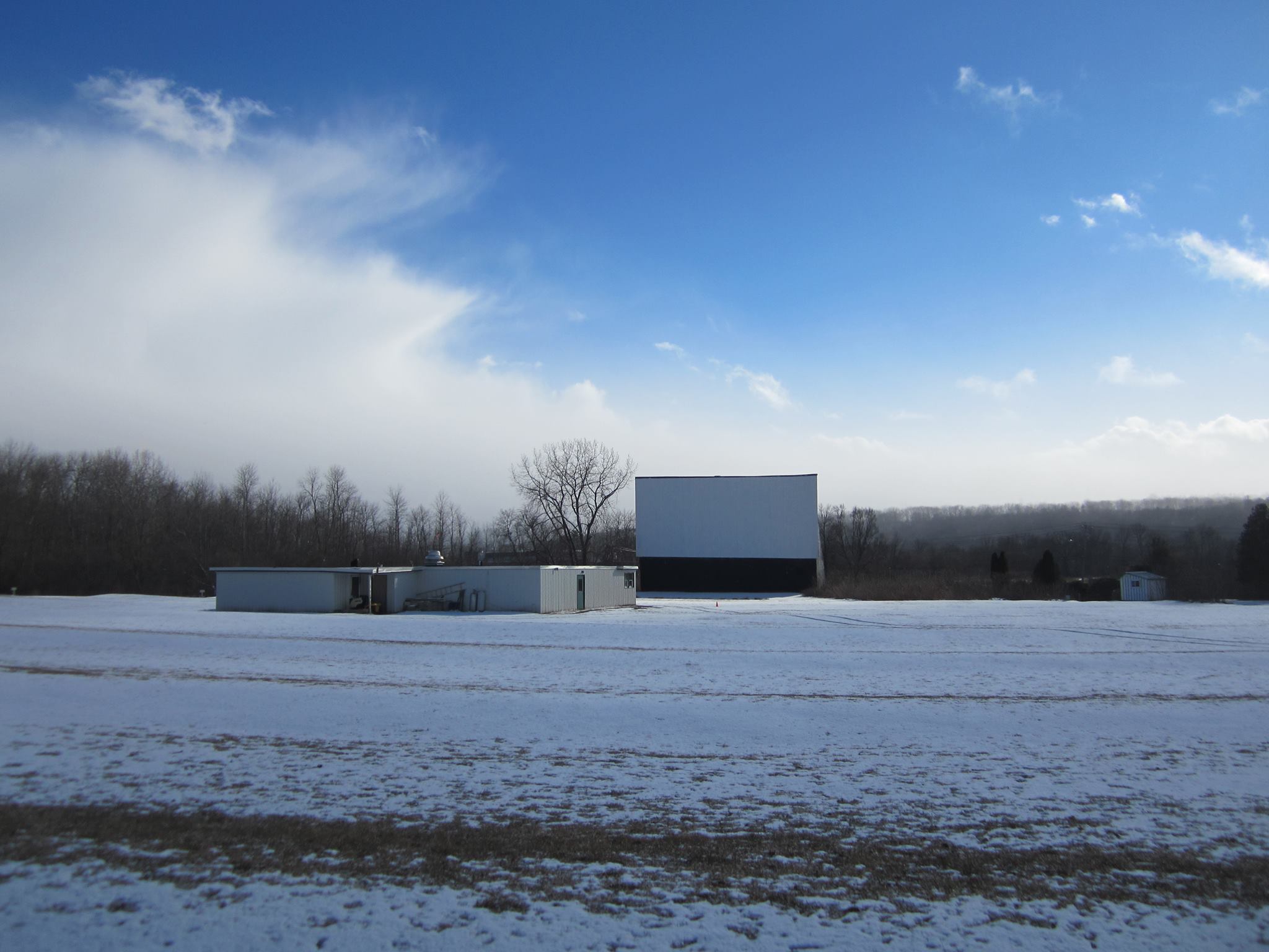

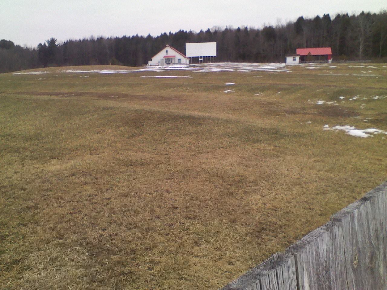

Thank you very much for this helpful info. I will attach some photo's. Both locations have about 9 acres cleared. The single screen "El-Rancho Drive In" has slight downgrade towards screen and highway. The twin screen "Ozoner 29" has much more grade between front and back screen 900' apart and 40- 50' difference in elevation. Great for stadium type viewing but bad for wash out. The lower screen and marquee area need drainage it has become a pond area the last few years. I can't mow it and have to wear hip waiters to change letters on marquee. The twin is a new build in 2002-2003 and we put a whole lot of tile line in to dry up most of the field, but not the lower flatter portion. Both drive-ins are grass with gravel roads no speaker posts, for radio sound is what is now used. I will get some better pictures later to show washout and water areas. Here a few I had on file. The newer build with the most washout is the twin screen with peak roof snackbar in center of feild. 17797077_10155985575424951_1397116710_o.jpg17797489_10155985575429951_900471819_o.jpg17821534_10155985575339951_181276432_n.jpg17838621_10155985575544951_722110882_o.jpgOz29June13DronePicJW.jpg

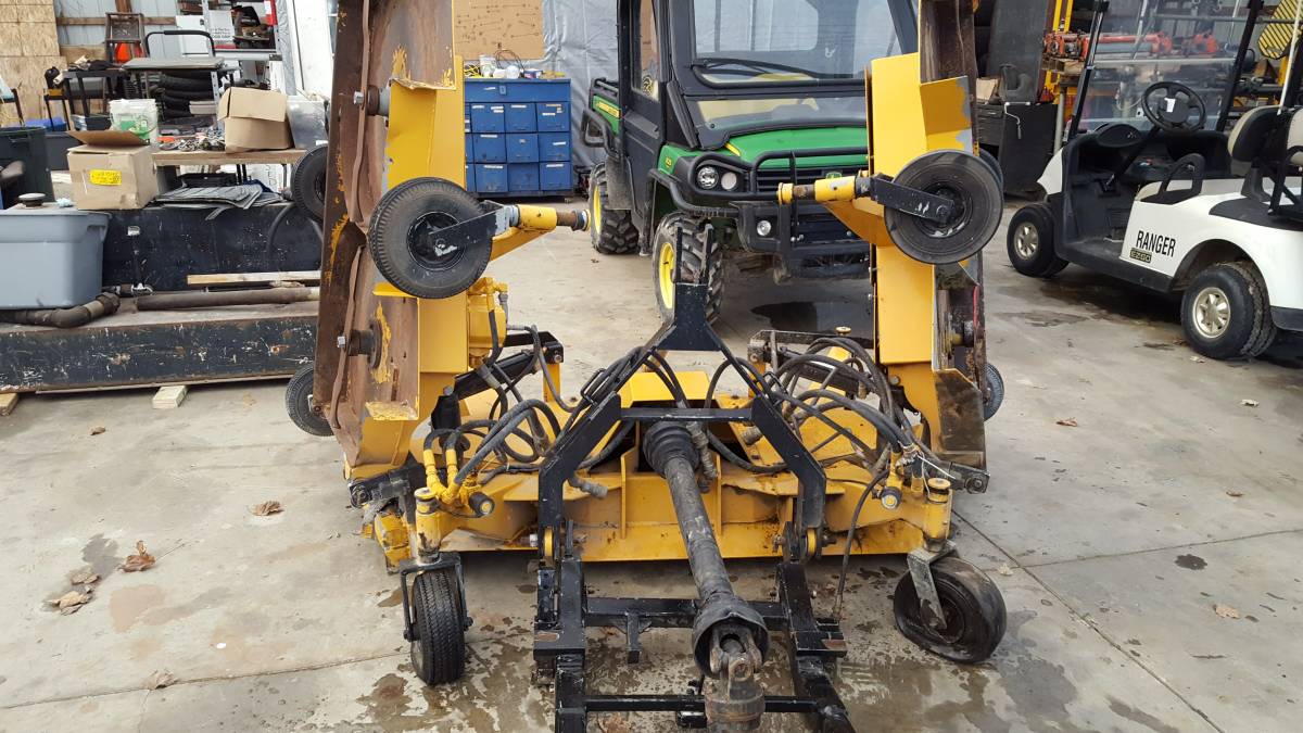

you might look at a "bat wing mower" as in a generic rotatory mower (bush hog) with a couple wings, and pulled behind tractor. more likely see state running them along the highways / express way ditches. a rotatory mower normally has 1 or a couple blades, but they do sell and make better "finishing mower" blades for them. pay attention to underside of the deck though. some rotatory mowers do not have a U shape or circle shape that wraps around the blade, to create better "suction" to pull the grass up into the blades to cut the grass. fail mower may work as well with correct blades / hammers attached to the drum of the fail mower. fail mower may actually be better, and not create "clumps" aka "wind row" of cut grass. normally would not suggest above. but you have for most part virtually nice constant slope singe large areas. and the larger width of a rotatory mower, should not have issues with finding a high spot scalping it.
I would not get a batwing for finish mowing. If he needs a large area mower, I would look for a Turf Batwing such as BAT WING MOWER

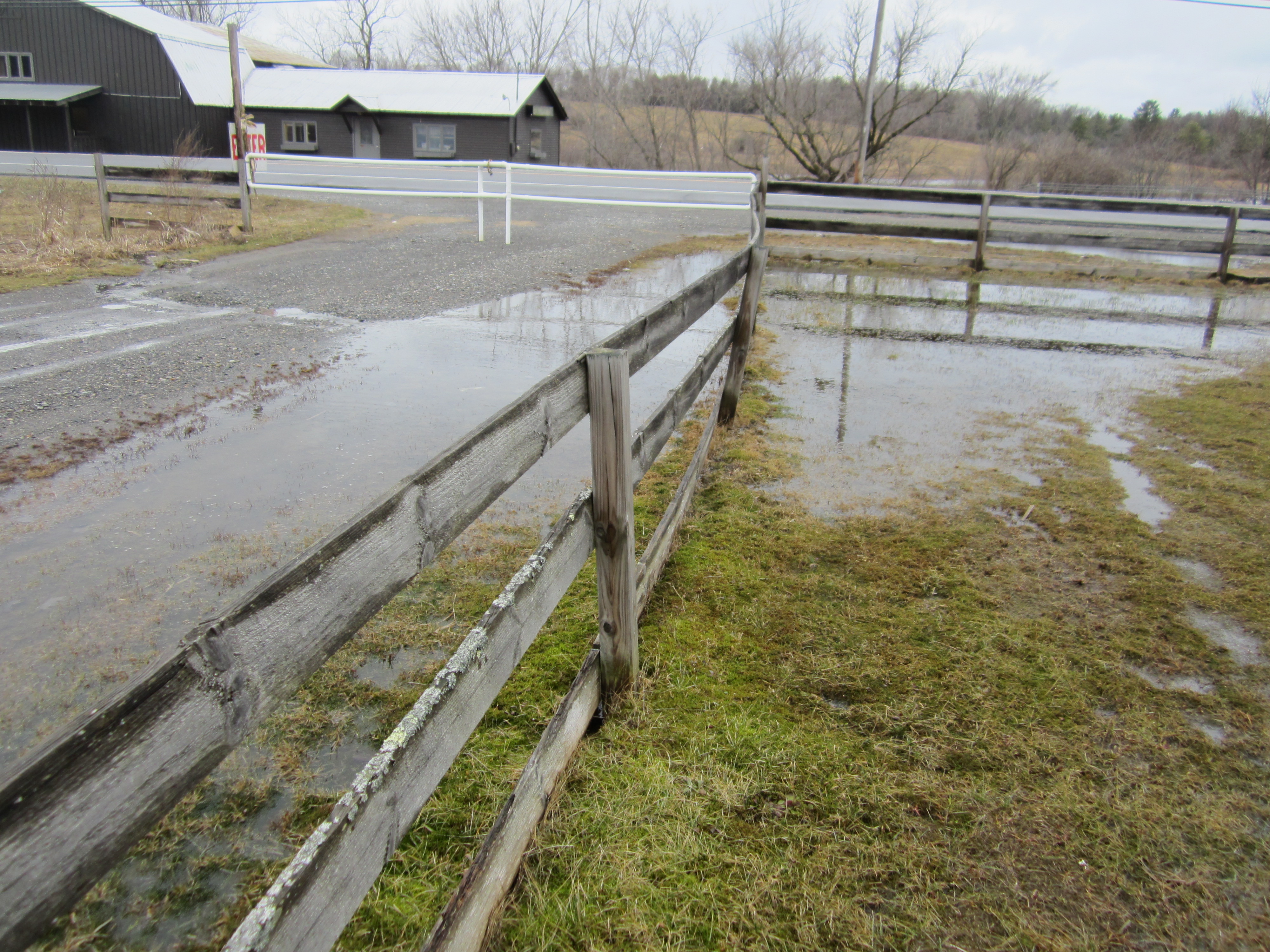

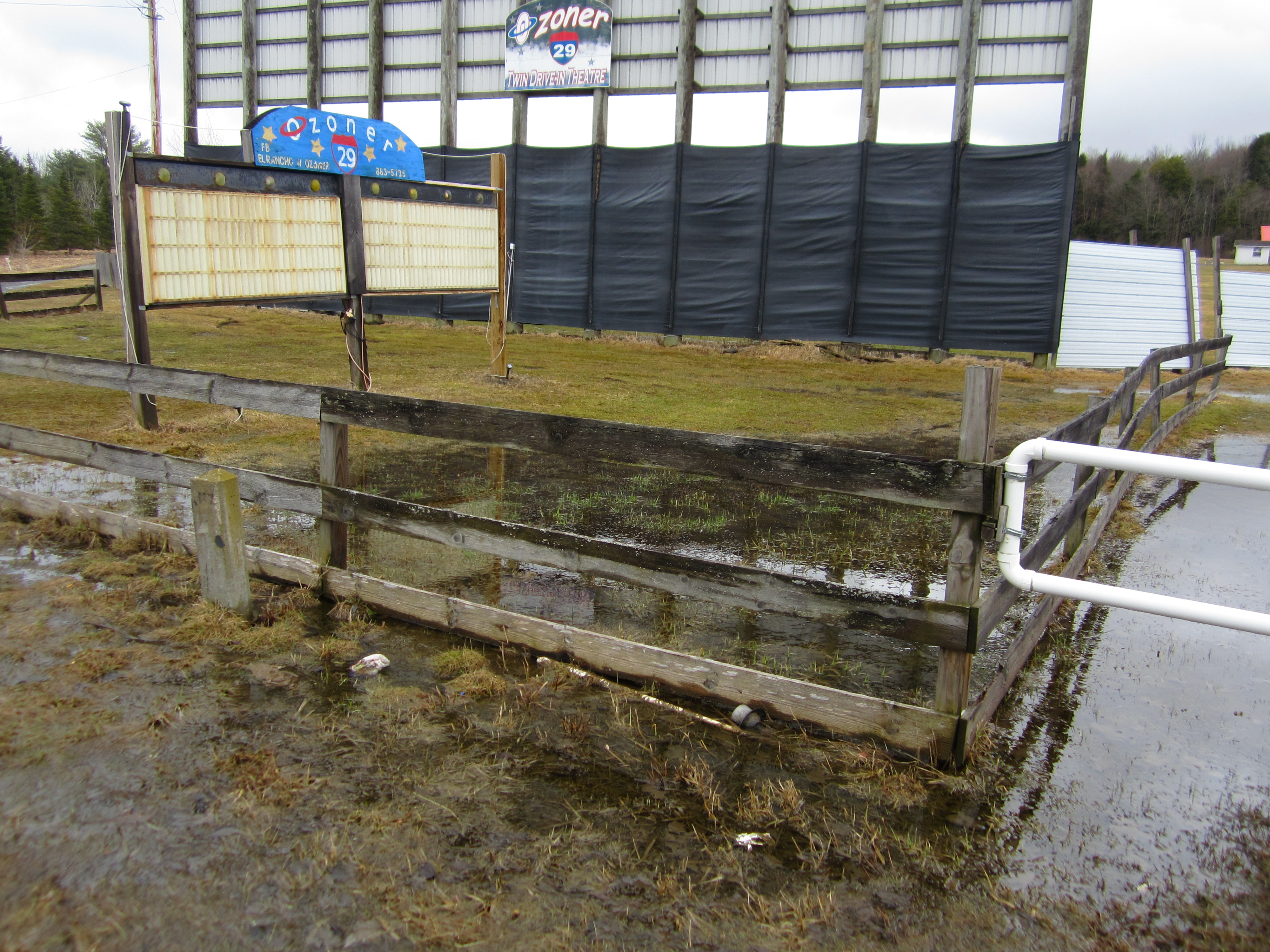

All good points. This is what I deal with a lot of the summer.....yuck!!IMG_1533.JPGIMG_1547.JPGIMG_1536.JPGIMG_1538.JPG

Depending on how permeable the soil is, i.e. does the water stand for days or does it soak in a a day or two? You may want to consider building a retention/infiltration pond, it will increase the short term capacity and reduce the surface pounding. Your perimeter drive would benefit from a drainage ditch or swale along the outside edge, then pitch the drive so that it drains into it. The less distance that water has to travel to get off of the road will result in less damage.

I'm going to see how well a couple sump pumps will do to help dry things a bit. I only need tile line on lower portion near screen where cars don't travel. The upper portion has been tiled and drains nicely. That lower screen is the bottom of miles of slope way up beyond the drive in. I'm just confused to why I never had this problem a few years back .

It's always fun spending other peoples money:) Last year it took a few weeks to mostly dry, then it would rain and pond up again. It seems the soil has changed the last few years, very slow perk.

I wonder if the issue you're seeing is from somebody downhill of you who has changed their drainage and now the water does not flow off of your property and onto theirs like it used to ( either from surface runoff, or from it percolating through the soil).

it does look like you have rock down through out your lots between the (enter/exit) roads on the sides. land plane / grader scrapper. might do well for you. in pulling the rock back up on top. and removing the grass/weeds growing up through the rock.
hard to tell from pictures and google earth. but on...
832 NY-29, it looks like you need a culvert placed in between the road sign and across both roads (enter/exit) it looks like the road side ditch on right hand side(standing in front looking back into property) needs to be dug a little to allow for better drainage so you can drain water from were the road sign is. and get proper drainage through culvert.
would agree with mapper, and in that putting a ditch on the outside perimeter would help. it does not have to be deep. just something to let the water run off go into. and drain the water away off the surface. as it looks now. (hard to tell) looks like portion of the (enter/exit) lanes are slightly below the surrounding grass areas. resulting in water staying on top of the driveway vs running off someplace else. it might be enough to due more of a "french drain" setup. were you dig down i don't know (purely guessing) 6" or 10" or so. drop down a holed pipe / drainage tile pipe (corrugated pipe with holes in it, or pvc solid pipe with holes in it) and then run a fabric sock on pipe to keep rock and mud from getting into the pipe. and then back fill with say pea gravel or like around pipe. get entire length of pipe so it all slops down hill some place so it can drain. (if that is an option), if not drop a sump, with trash pump on a float switch. to pump the water out. i would think it would really help dry up everything. to point of running more movies.
trying to get away with a pipe, and simply dig a ditch and get the ditch looking all nice and smooth and perfectly graded so it hardly noticable. not sure if you could do without removal of a lot of extra dirt. and really working the dirt to get just the right amount of slope. most likely cheaper (no rock / pipe) but may not drain water as good.
other option is get say a middle buster for 3pt hitch / potatoe plow. and drop it down as deep as she will go (run over spot a couple times if needed to get it down) and run it on the outside perimeter. to open up the ground. so water can drain down and out. more of a band-aid approach, but might get you started to see if it is worth it or not for extra expense. other folks will do this in there pastures and like were water is standing. to help dry the areas out.
trash pump = able to handle solids up to a certain size. example grass clumps, leafs, acorns small size rocks. the specifications will state size solids it can handle without clogging up.
sump pump = most likely not able to handle any sort of solids if so 1/4" if that maybe.
the sump (hole in ground to place the pump) while a plastic sump you can pickup at local hardware stores may work. it will most likely crack/break. and or become a hazard if someone drives over it. and most likely you will need some sort of "metal grate" over it. so no one can fall into it. so you are looking at some sort of concrete walls. from 8x8x16" block walls, to poured concrete, to possibly calling up a local concrete place and seeing if they have some "round" concrete short pipes or like you could buy. and have them deliver and install it (drop into hole for you) but you back fill around it and connect pipes up to it. there are some internet websites that sell "septic tanks" and do just that search for "septic tanks" and then once on there website look for other storage containers to find something to use as a sump. i say septic tanks due to trying to search over years for anything else generally bad search results. and septic tanks generally brings back places that sell other tanks.
maintaining the driveways and rock. double check the tractor width and recommended width for various attachments (rear blade width, box blade width, land plane/grader scrapper width) if you need to make 3 to 4 passes per width of your driveways. it is going to take some extra time to get stuff done. vs going with a tractor and implement widths that allow you to take 2 passes.

I dug a hole in front fenced in marquee area and dropped a sump pump in and she dried up some. The pump ran for 4 hours till she stopped pumping , but the stopper was hung up a bit. I'm going to make a bigger hole tomorrow so the sump will have room to start and stop proper. I also hand dug some trenches across the driveways and dried some other areas. This is what I usually do all summer when rain comes. I shall fix most problems when I buy my tractor. I'm going to post a link in the New Holland forum and ask a WIW question on a tractor in my area for onsite auction next Saturday
