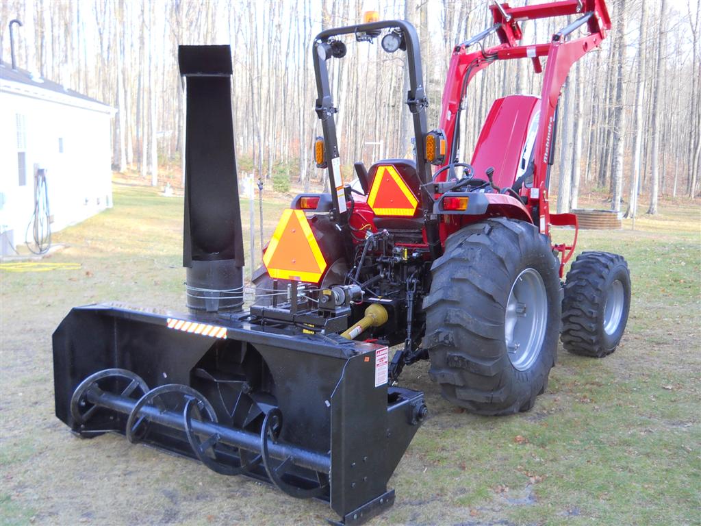

I heard that Mahindra had a similar engagement problem when they first came out with the 35 series tractors. They ended up putting a small round hyd surge tank in between the PTO clutch pack and the elec hyd valve. Takes a little snap out of it. I broke a bunch of pins when I first got my blower. Some from everything brand new and tight... the others from the idiot operator working the clutch on my John Deere. Now, everything is loosy goosy... and I spent a lot of effort making a huge stash of new shear pins. So, now I just about never need one.... :(
