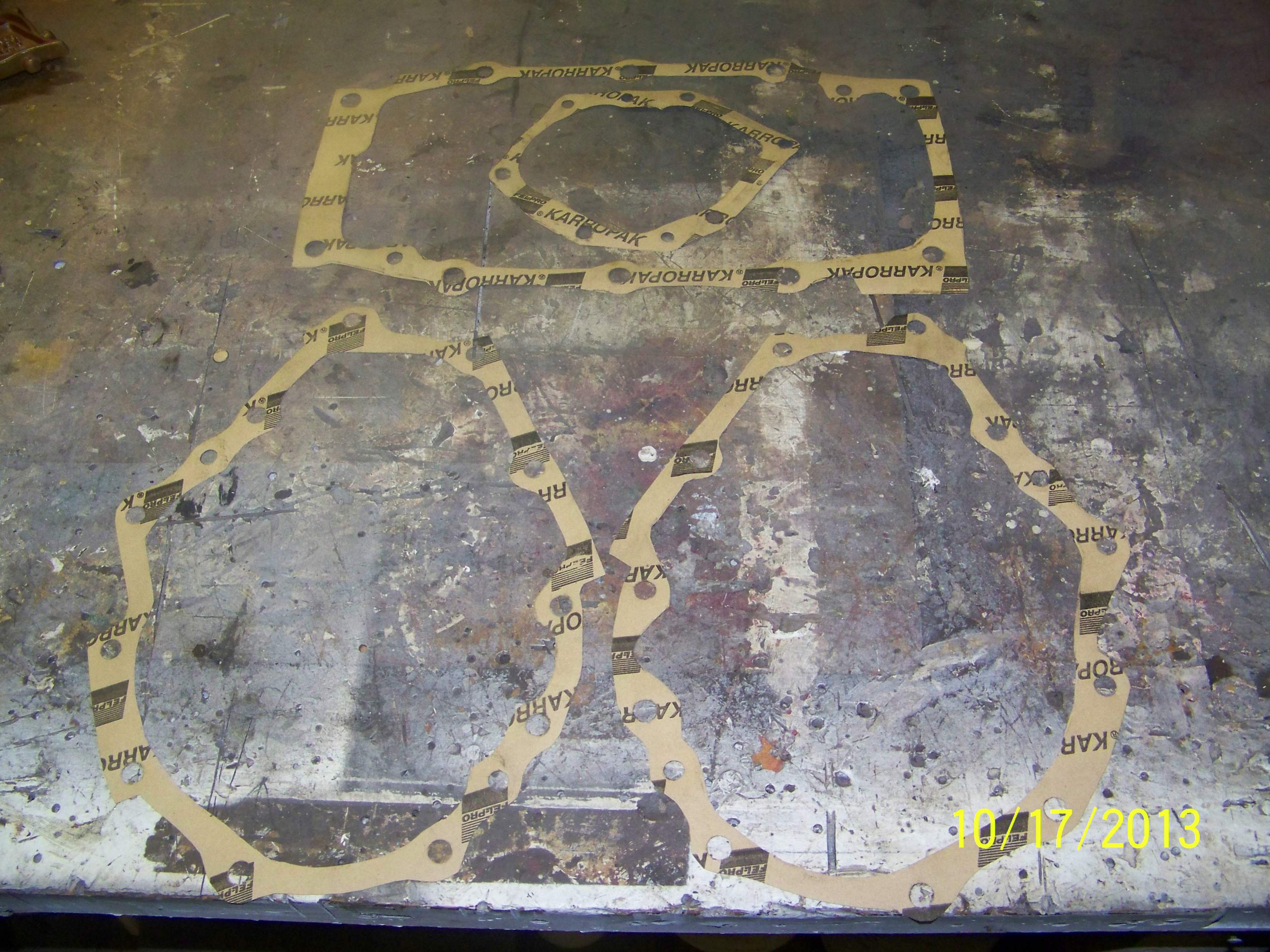

Just a short update. We are working with Mr. Sheaffer obtaining parts. Sheaffer's Town & Country Tractor Hopefully, this next week we will have them in hand. Here is a picture of the cut gaskets. I micrometered the material and bought it at O'Reilly's Auto in sheet form.

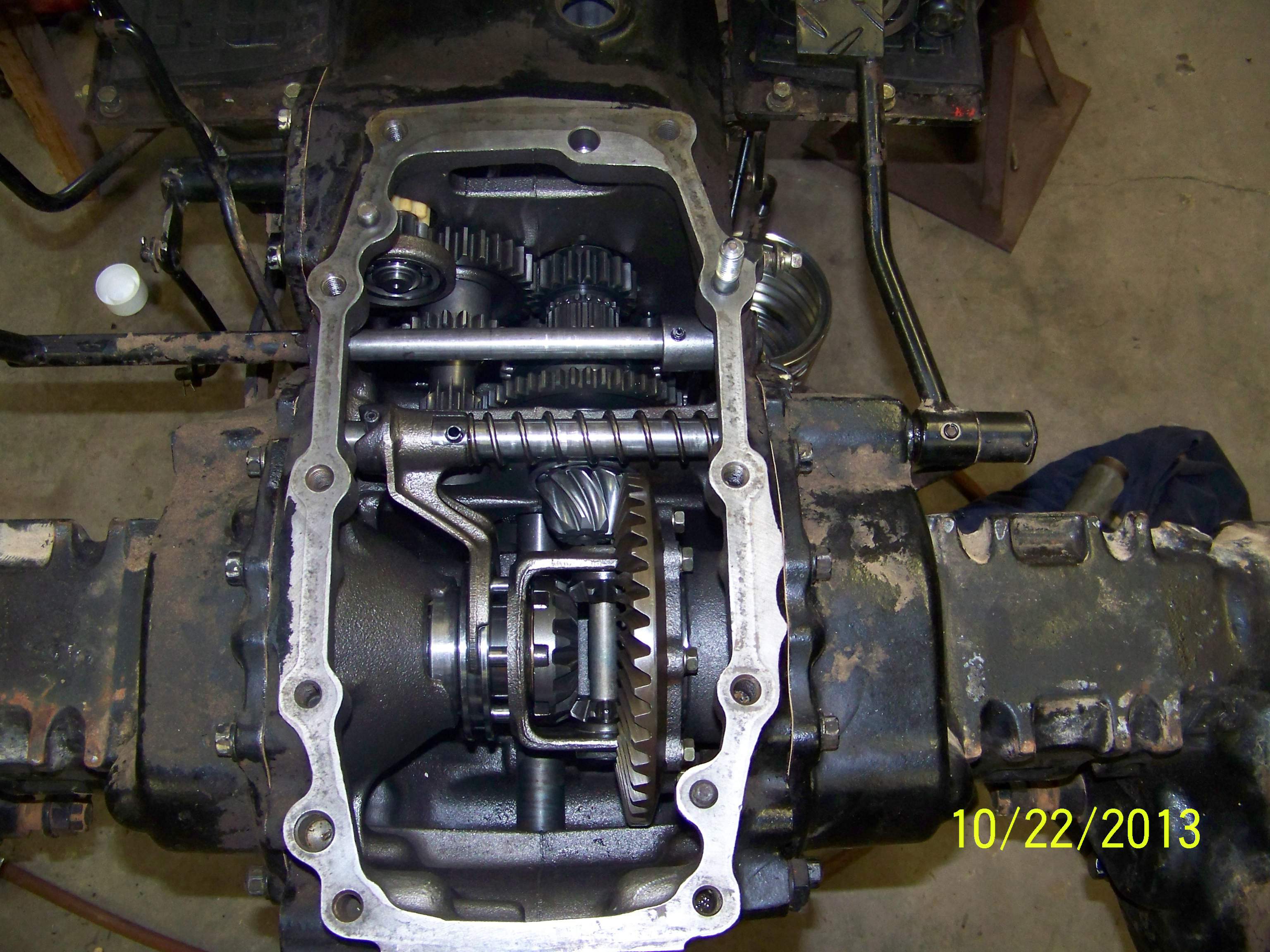

Make a little progress on the FX24D this afternoon. This picture is of the new ring gear installed.

This one with the axle housings installed.

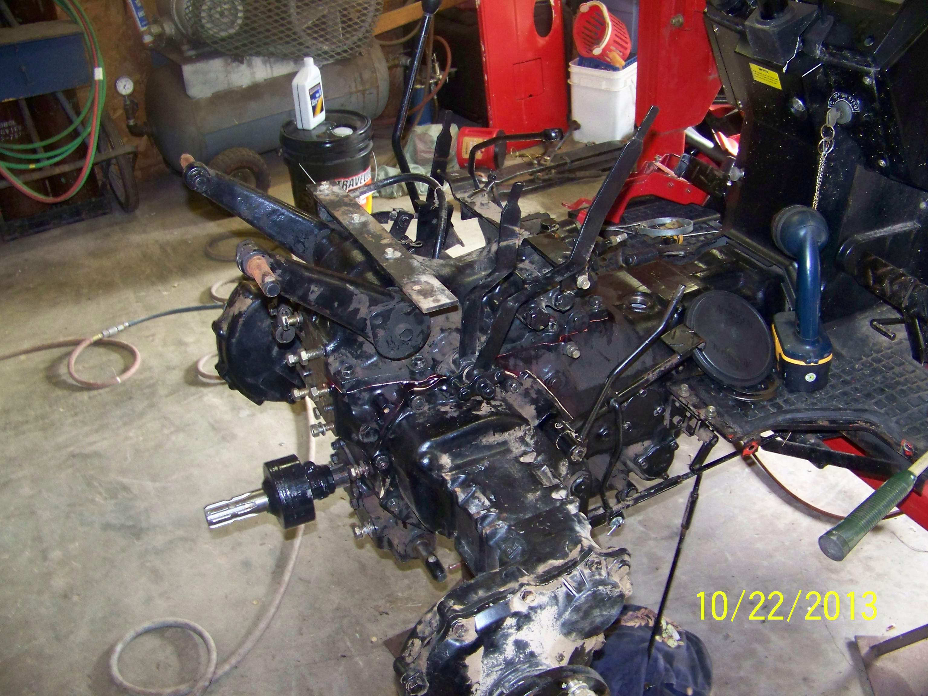

Lastly, one showing the hydraulic unit installed. Notice the new over run clutch. We are going to try and prevent this from happening again. Probably be next week sometime before I get back. We are going to have a little R&R.
