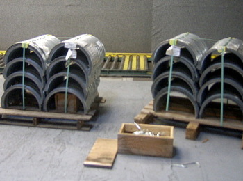

So the other day I purchased some military surplus culverts. They come in two halves and are connected together on site. This allows for easy transportation/installation. So as I was thinking about what I was going to do with all of it amd I came up with an idea! Please feel free to poke holes in my idea.

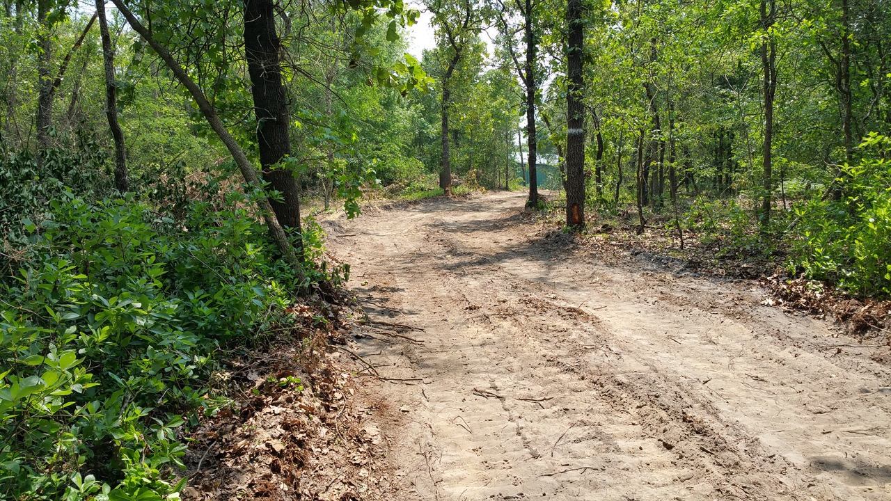

We have a road on our property that is unimproved (dirt/sand) and is pretty steep in one area. When it rains the water gets moving quickly down the road and washes/erodes it away.
What if I placed the 1/2 pieces of culvert on an angle across the road and filled it with pea gravel? That would catch the water as it begins to flow down the road and would divert it off to the side. I could do this at maybe three or four locations along the 1200' drive. What do yall think? Am I wasting my time?

I wouldn't do it. First, the rain will wash under the culvert and create an impassable ditch. Then the pea gravel inside the culvert will either wash out, or get splashed out as you drive over it.

Honestly, you need to build that road, you have it cleared now but you need ditches and a crown. Also, a plan to divert water away from the road where you can; BEFORE it gets onto the road. The crown will push the water to the ditches. Then you need to get gravel, crusher run, on the dirt asap... compact it in. Watch the road when it rains, and see where you need fix any issues with water.
If you need to run water from one side to the other, then use the culverts, both halves!

We are having a house build and they are still working on the road. They should start cutting in the ditches next week. We have just had so much rain lately that it had me thinking if another solution was necessary. Hopefully after the ditches are cut and the road is crowned we wont have the severe washouts.

Ah ...the rest of the story... So you are looking for a temporary solution? How heavy duty are these things? can you drive over them without crushing them? Use them like a speed bump (maybe half buried) angled to the side? Just to divert the water for now?
this idea seems most plausible

I have two concerns with your idea........first is that the pea gravel will wash out......it's amazing what the force of moving water will do........i have problems where it washes 3/4" stone out....the second issue is where the road meets the 1/2 culverts.......when you install them it will be fine but after the first couple of storms that edge will start to wash out and then you will be left with a raised edge of the steel culvert which will play havoc on tires........Jack

I got them from an auction and they are still safely secured to their pallet!! I may use them on another part of the creek or I might just sell them. The road is in and crowned. I need to get some vegetation growing to stop erosion, but after that takes root I should be good!
