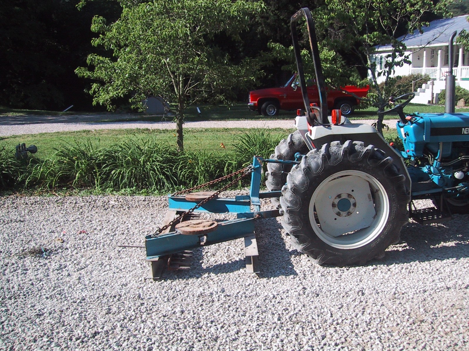

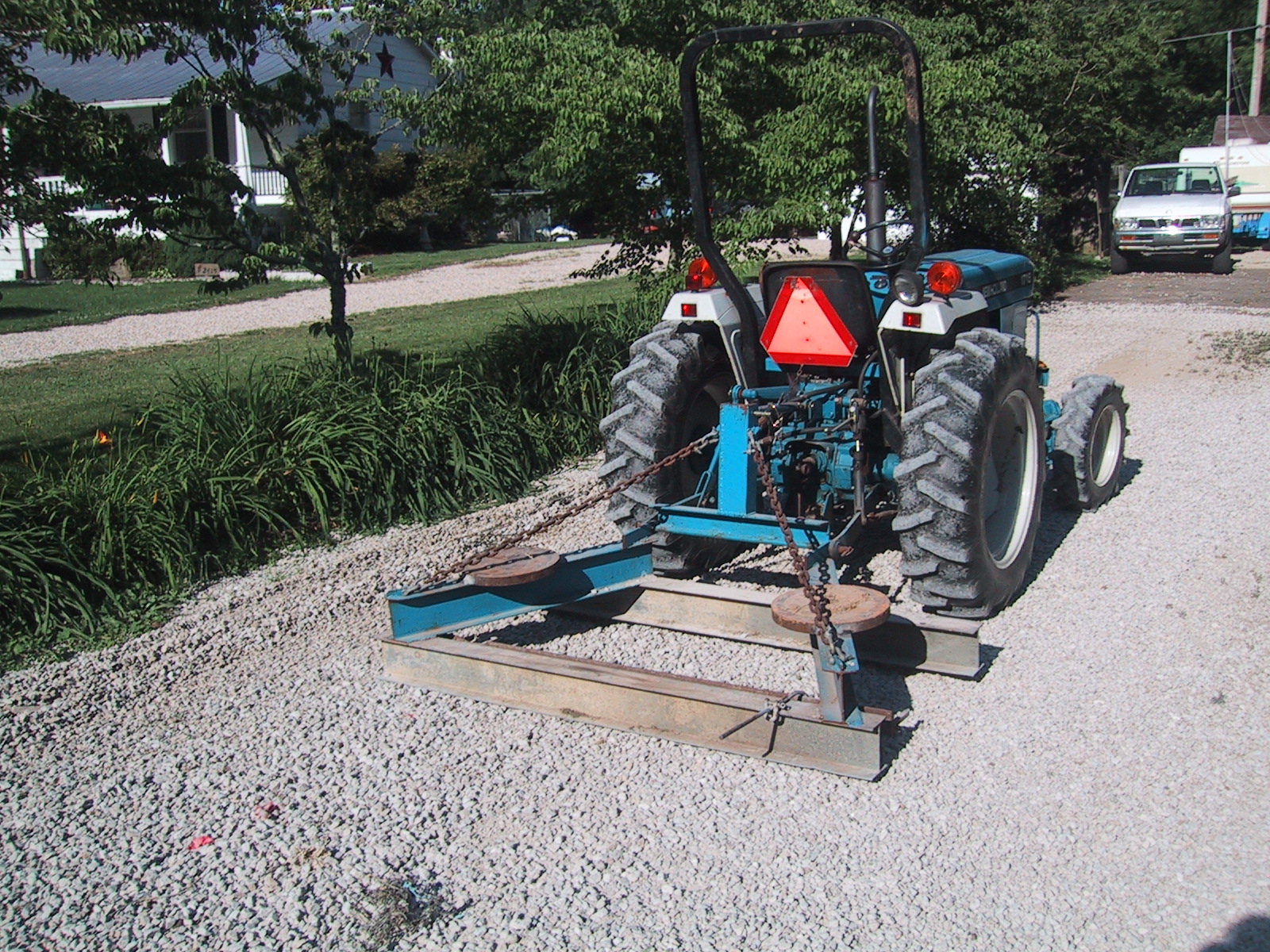

I have a 25 hp Kioti tractor & I am looking to build a 3 pt driveway drag. If any one has any ideas please let me know
/ driveway grader/leveler #2
my dad made one that he pulls behind his bobcat that is 3 grader cutting edges bolted to gether in a triangle and pulled with a chain but you could pout a 3pt mount on it.
/ driveway grader/leveler #3

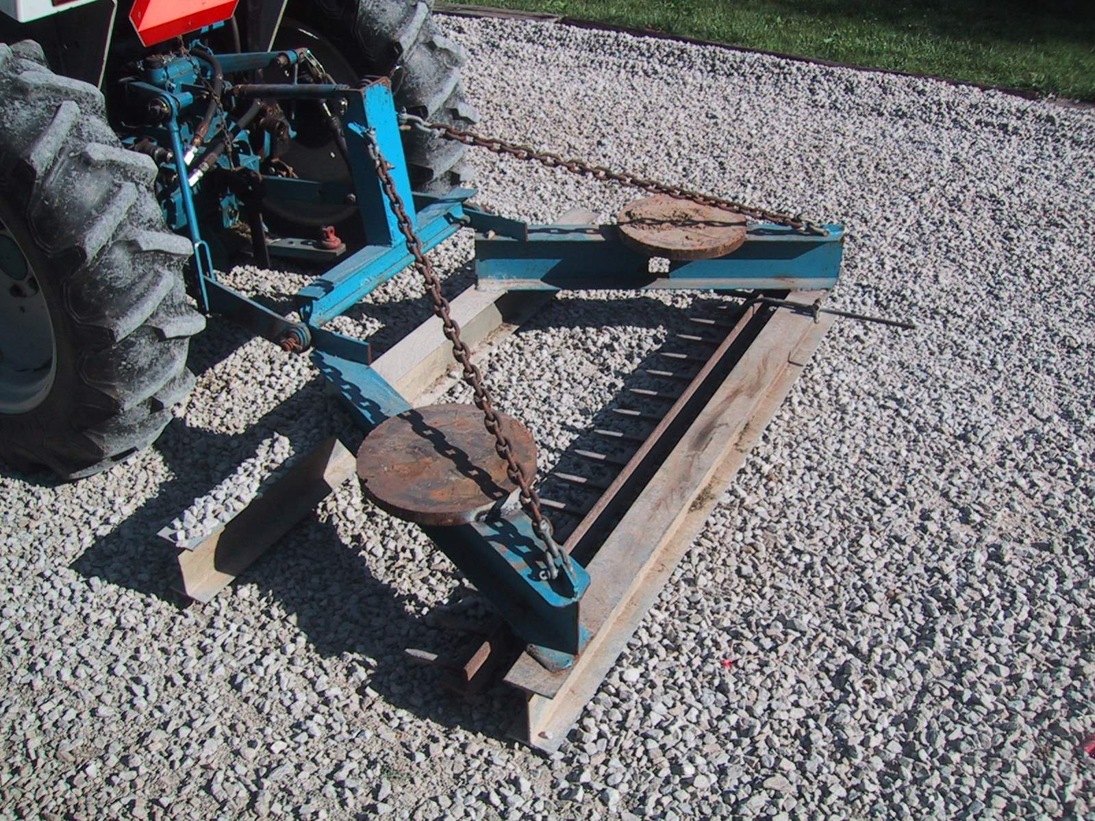

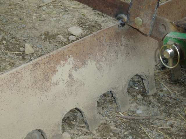

This is a drag I built out of some scrap steel I had laying around. The sides are just under 5' long and are 8" channel Iron. The blades are from a piece or 10" wide flange I beam that I cut the web out of making 2 flat pieces. The remaining web section (where it flares out at the flange) acts as a reinforcing rib. The front blade I cut teeth into which I ended up reinforcing with some 1/2x1/2 square bar stock (not in picture) to break up the gravel surface. Both blades are set about 1" below the sides to allow it to cut a little. The rear blade is smooth and will hold a good bucket full of loose gravel as I am dragging. The 3 point piece is hinged and attached with chains to allow me to lift it up and also allow it to float with the driveway. I have a grader blade, box blade, and rock rake and none works as well as this little baby. I have over 1500 feet of driveway to maintain and if this thing went down I would order the steel and build another exactly like it the next day. My only complaint is that a certain size rock will stick in the front teeth every once in a while and keep it from cutting well. I don't know if tapering the teeth would help or not. I intended to add a weight box to add weight but it cuts well enough, and carries enough gravel that I think with weight it may not work as well.

I've seen a lot of driveway grading posts here, but I don't remember seeing one with a toothed cutting bar yet. After reading the previous post twice, I see that you cut these teeth. They look so uniform that I thought you had found a used grader off a motor grader that already had teeth. That's a pretty cool grader.
Mr. Mowry, are you already using something to grade your drive and just want something better?
/ driveway grader/leveler #5
Thanks for the compliment. I used a beer can. Trace the radius, set the can down, cut the piece, drink another. Took me two days. LOL There was a lot of torch work in that baby, I will admit.
/ driveway grader/leveler #6
tessiers, I did not realize you cut the teeth with a torch either. Just by looking at the pictures the width of the grader seems to be 5'-6'. Is this correct? How well does your 790 pull it. How much wider do you think one like yours could be made and still be pulled by a 790?
/ driveway grader/leveler #7
It is a little over 5' wide like 5' 4" or so. When the driveway is hard and dry I could haul an 8 footer because it doesn't seam to hold as much gravel in it. When the driveway is soft in the spring I could probably get away with a 6 footer. I actually try to drag the driveway shortly after a rain (no standing water) because the gravel is a little looser and it seams to level off faster. I made it the size it is because of the materials I had on hand. My grand total investment in it was $0, at least the day I built it. I obviously had some gas, rods and electricity in it but all the steel was off my scrap pile.

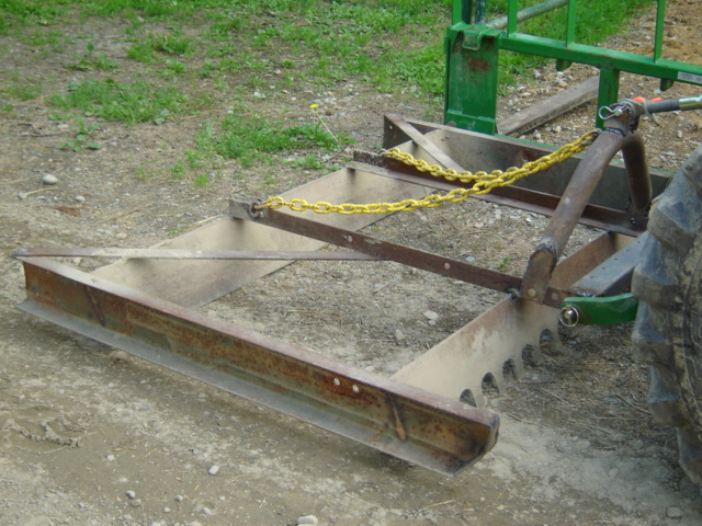

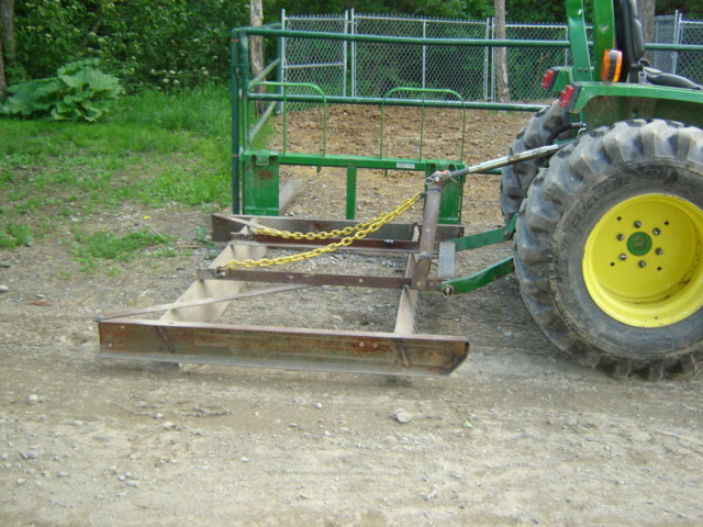

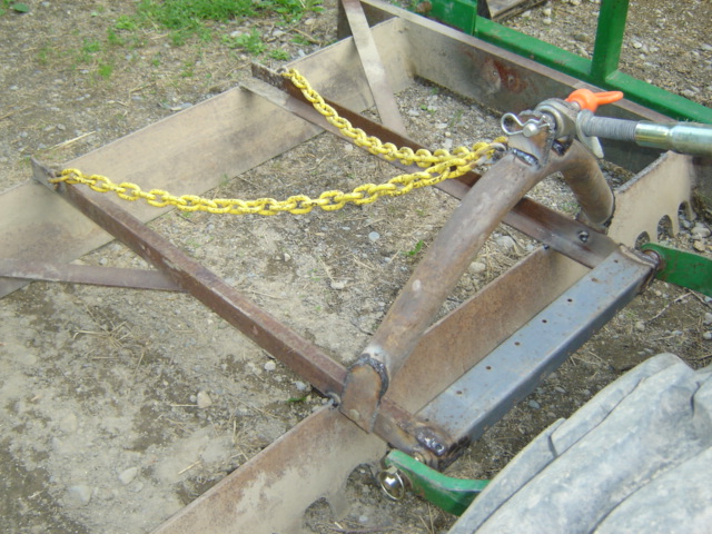

I made mine from three Guard rail post that the state road left on my farm, and some rail road spikes. with some junk collected from a local junk yard. I think I had about $40 in it.
Is for gravel drive way.

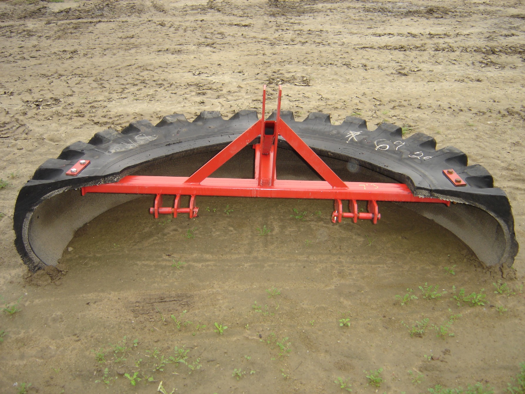

I found this on the net, If nothing else it's interesting:)

They use those for pulling manure out of cow barns. Ive seen them in action. They are made out of an old tire cut in half so it wont bust up the concrete floors. For driveway grading, I use my rear blade and boxblade.
