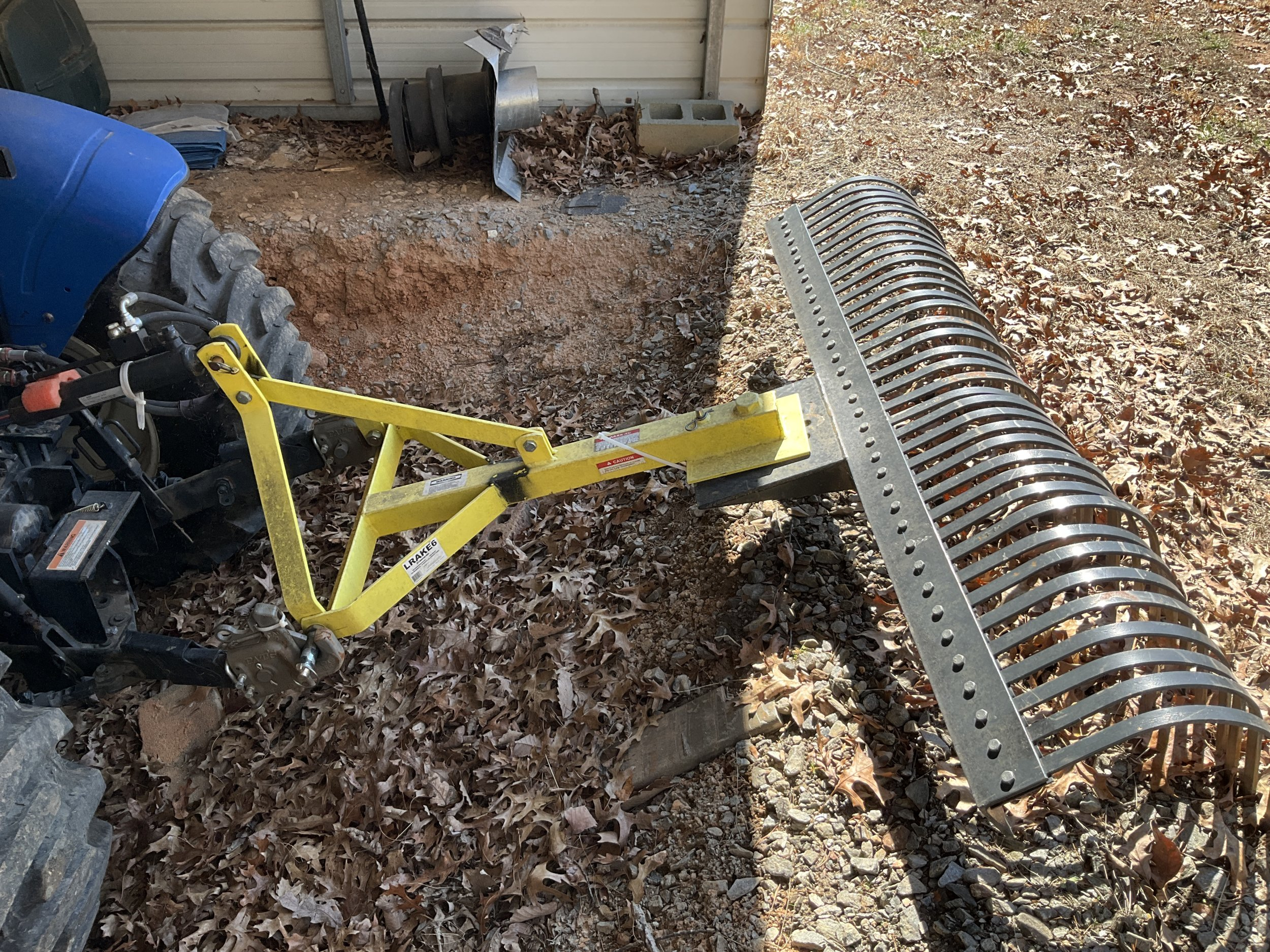

I use a landscape rake angled for my 1/2 mile driveway and just try to get them the best I can. That is mostly 1-2" crusher stone so they are larger pieces. My parking area near the house is smaller gravel and I just started using the broom/sweeper attachment for my Stihl Kombi system. It puts it al back in the driveway in about an hour or less and keeps my grass where it was.
If the snow was still mixed in you could move the pile back to the driveway and let it melt so the stone ends up back on the drive.
Smart Smart Reply. It works like a charm on your gravel driveway to raise packed gravel back to the surface. Saves me from buying gravel a lot of years. I do 45 degree angle scrape rocks from side to middle. Then no angle and level center from 45 degree scraping. Creates a nice crown effect for rain water run off. Get a 7 or 8 ft width so at 45 degree it will cover tire tracks.

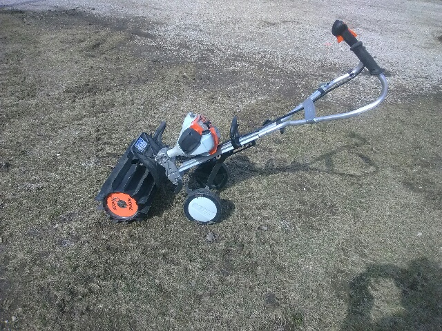

My neighbor use to Leaf Rake it in piles, on and off, for weeks. He bought this attachment for his Stihl power head and now it's a few hours on a 400' driveway. Of course the best way is to plow high in the beginning of the season until you get a super packed base of snow. The rest of the winter your stones are covered. If the snow piles are still there and not too icy. Backstage them onto the driveway and let the stones melt back on the driveway.
   / Driveway gravel #27
I bought a Stihl Yard Boss power sweeper a few this years ago to clean up the grass around my gravel road. I know they are a little pricey, but I have tried most everything and they work the best!View attachment 735794
This is what I mentioned in my Post. They truly work wonders on #2 stone (about 3/4" to 2" sized stone)
