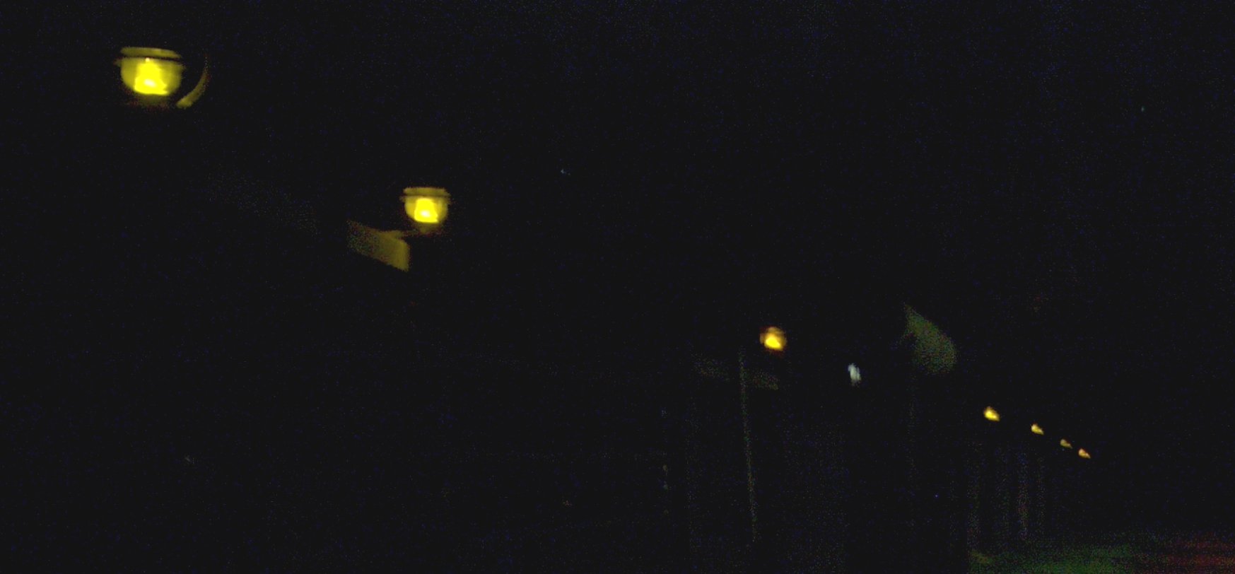

Howard, sounds like a lot of money to me. I guess I'm just a cheapskate. We put up some malibu hanging solar lights and I thought those were expensive! We're in central Illinois and ours will be going on their 3rd winter without a hitch. I haven't changed a battery or taken them down at all. Believe it or not they have never blown off their hooks either like I thought they might. We have them on every other fencepost along our driveway. They stay on till around 3am in the middle of winter and till daylight in the summer. Heres a picture of them at 8:30 this evening, after about 4hrs of darkness. They only give off enough light to mark the fenceline.
Kevin
