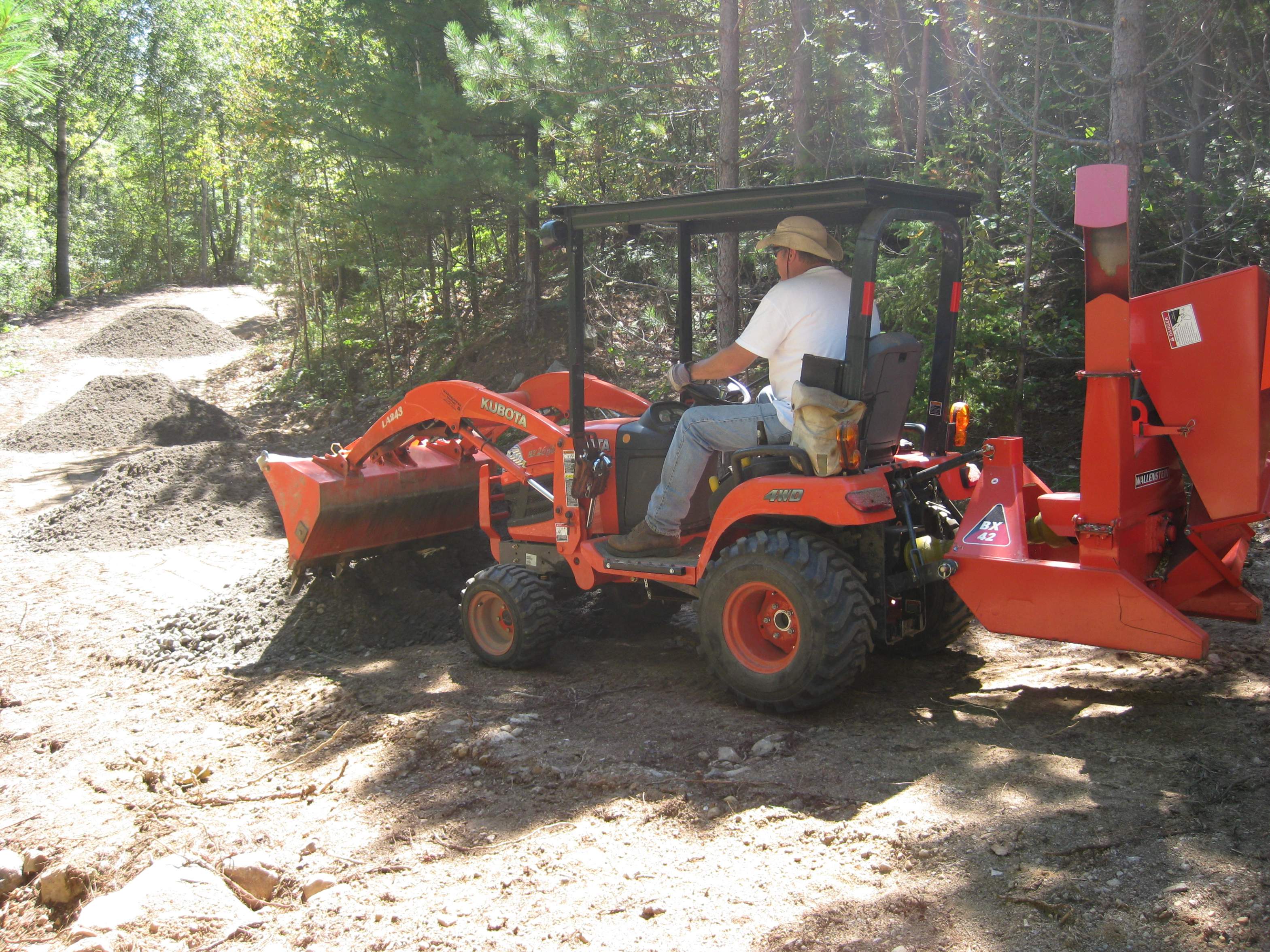

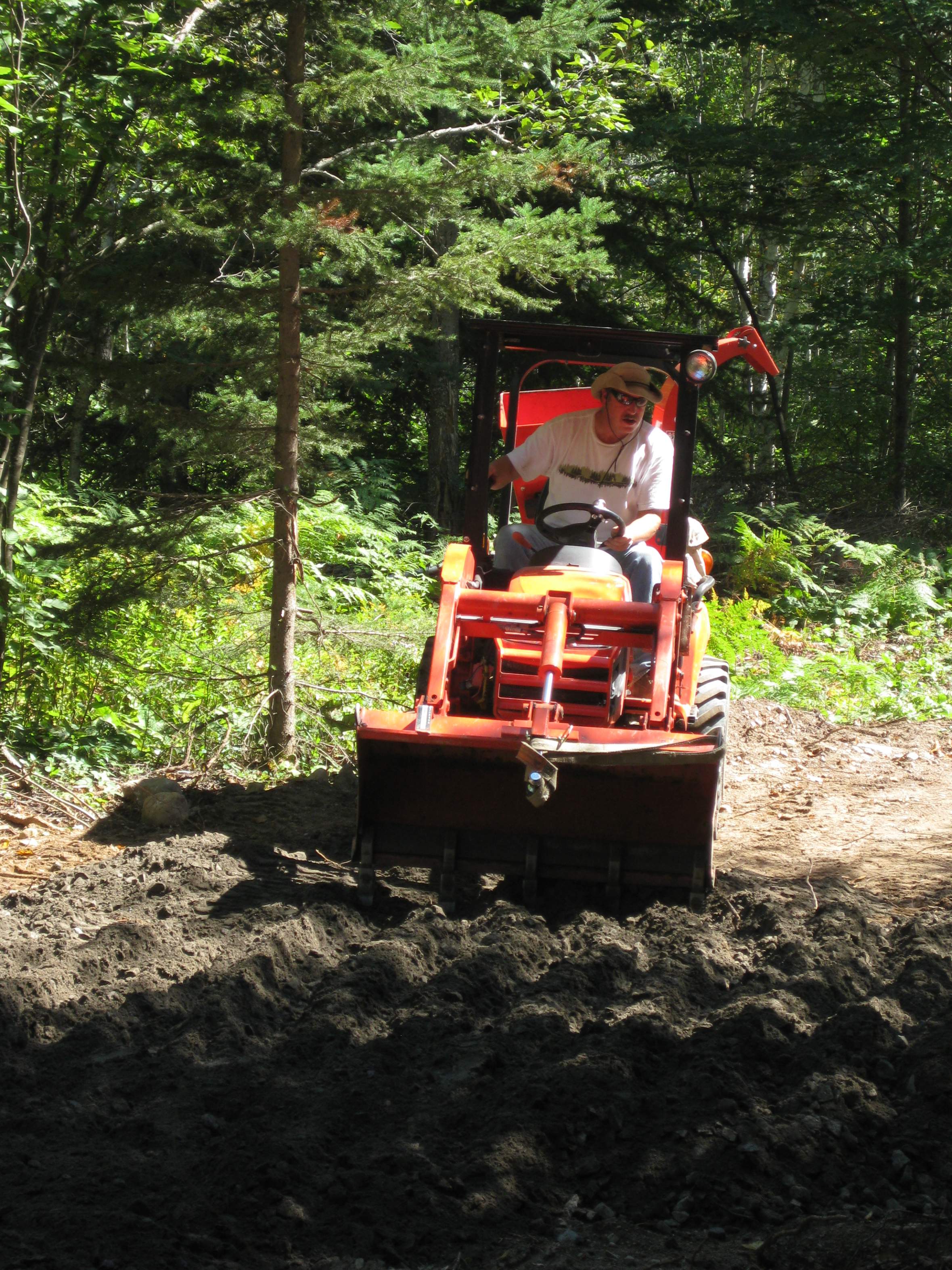

Of note : because I do not own a box blade , I have used my toothbar to spread gravel by using it by pulling backwards to spread the gravel the thickness of the teeth (that thickness I can vary by tilting the bucket somewhat even)
It works to get the gravel generally in the right location and thickness and can be fine tuned by hand or by using the smooth bucket back (again by pulling in reverse)
See pics of me doing my son in laws rural driveway.
