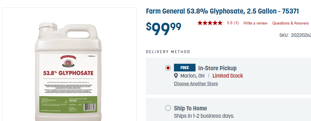

If you really want to be frugal....you can buy a quart of diquat, and 2.5gal of generic glyphosate and make your own roundup "quickpro" for less than $100 vs the $150 quickpro. And that "less than $100" will make almost double the mix. So its a good 3x cheaper.
That is what I do. Generic roundup spiked with diquat on areas I dont want to use mojave because of runoff concerns....or around the electric fence encircling the garden, etc. But I already buy diquat normally.....in 37% form. (takes 2/3 of a teaspoon or 0.1oz per gallon) for mix. But I already have it on the shelf for treating pond weeds
At the end of the day, there is alot of playing with numbers and science and marketing involved. IF whatever you are using is JUST glyphosate with no other kickers......there isnt one better than the other if they are mixed at the SAME ACID rate. Any differences you may see with generic vs name brand, or promax vs pro vs powermax vs regular, etc etc.....those differences are either in mix rates no being the same or some having surfactant and others not.

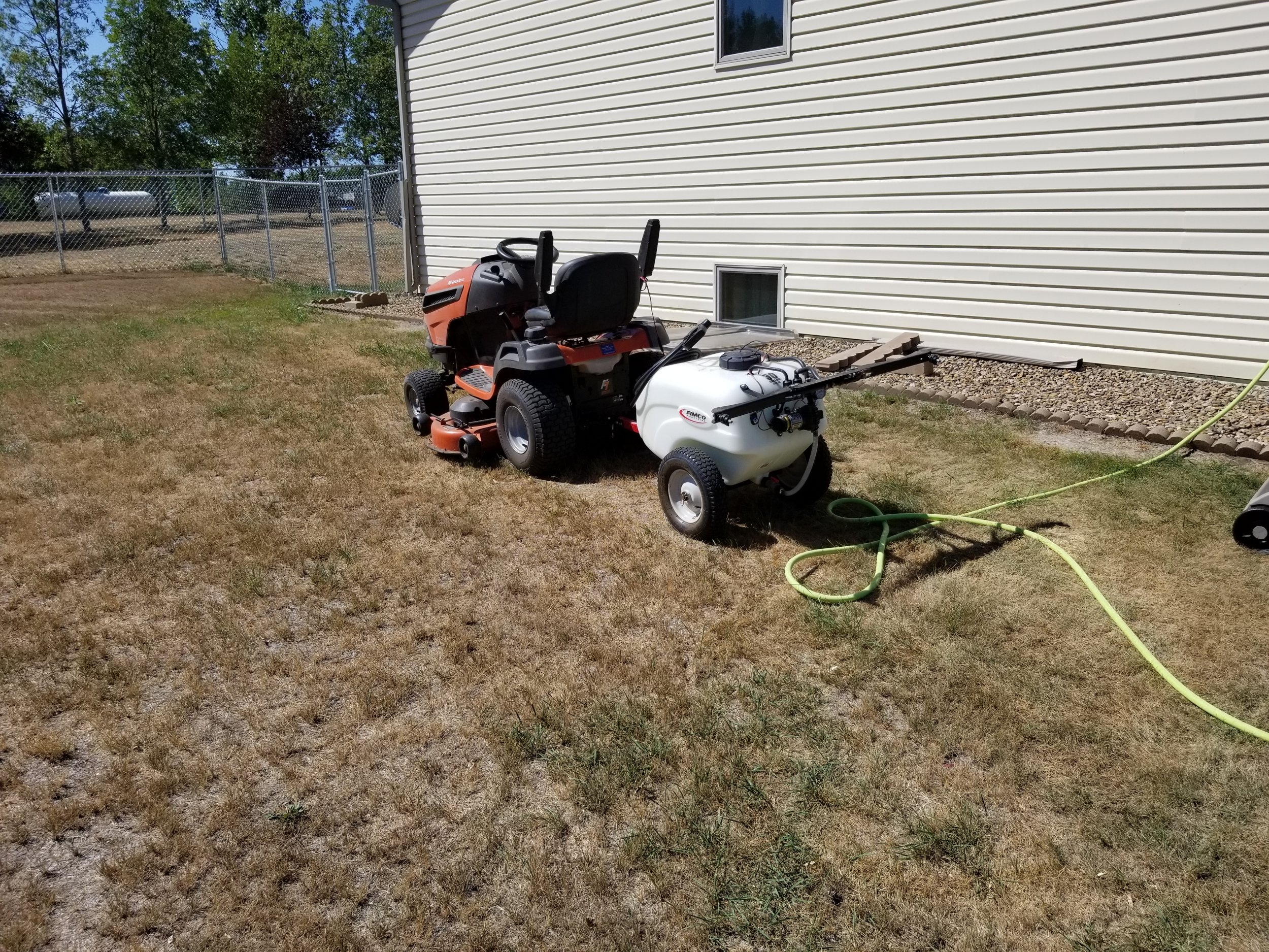

I don't know off the top of my head which variant of Roundup I have but I can say it's a 2.5 gallon concentrate that recommends 20z/gallon for maximum effectiveness. It sounds like the best recommendation is glyphosate and a pre-emergent mix to kill both what's growing and the seeds. I have a 15 gallon sprayer and just need to figure out a mount for the lawn tractor. I've seen a number of options for hitch mount on lawn tractors. I'm leaning towards this one (or similar):
I'd have to mount a platform to it somehow. Options are either a couple L-channel and perhaps a bit of plywood or maybe a 2" reciever adapter and a platform of some kind.
I'm really surprised that there isn't a carry all already available as a bolt-on option for common lawn tractors. I really want to have something that's easy to attach so I can remove and install the bagger as needed. Maybe that's why most people just use a trailer style sprayer.

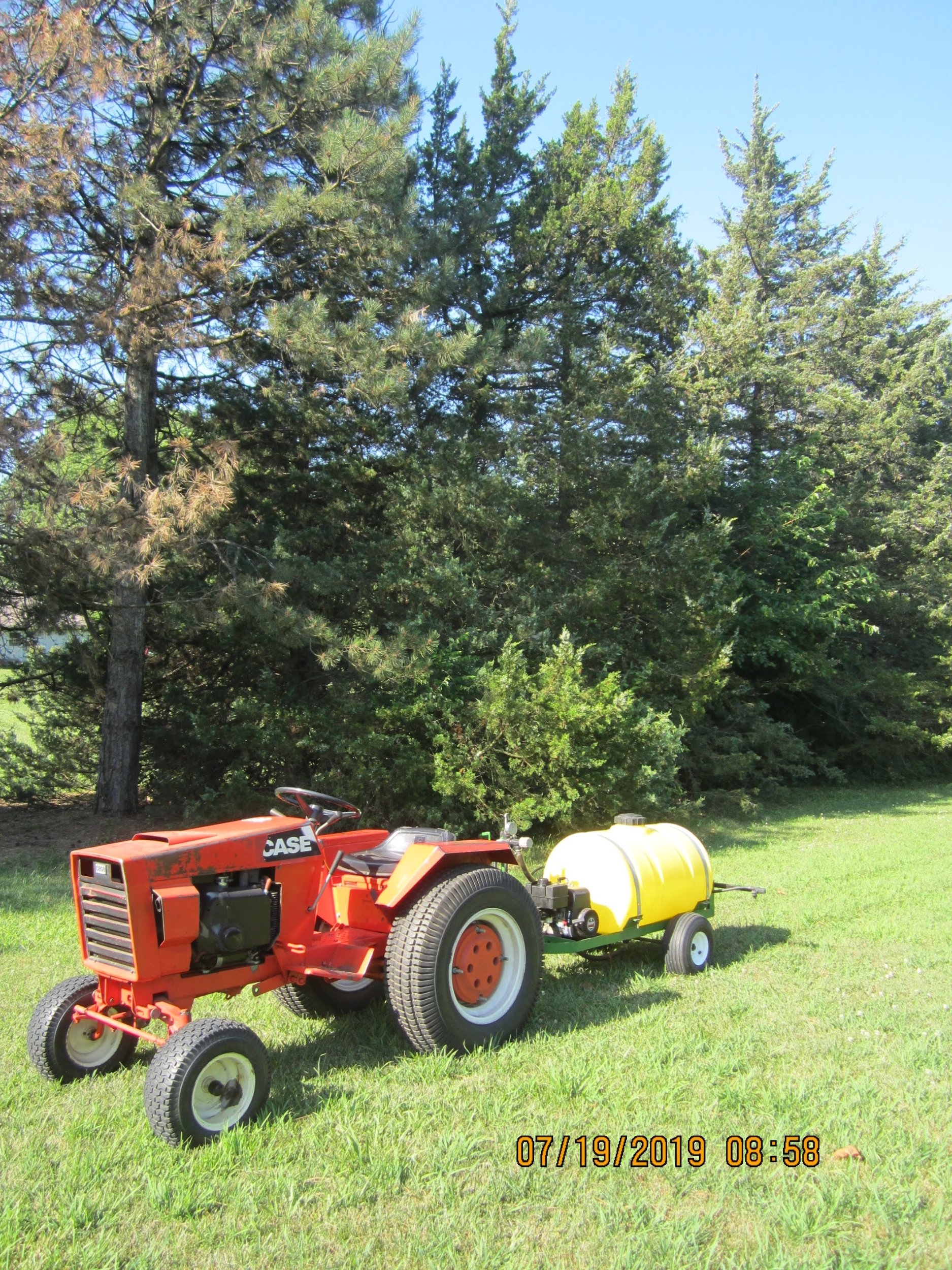

I guess I use about 1.5 oz. per gallon of the stuff you can buy at Rural King in the 2.5 gallon jug. I use a 35 gallon tank sprayer on a cart behind the Kubota G6200 GT. Works out good, kills it pretty well. The one thing that doesn't die from that mix is the mares tale. Have to use something else (Enlist) on them.
jug.

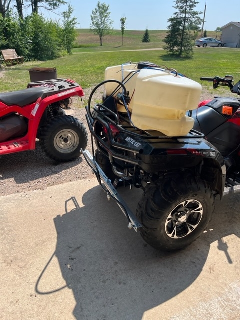

You can build a spray bar with parts from Tractor Supply. Total was about $55 . I mounted the bars to a 2” receiver hitch by welding a bolt to the ball and using a fender washer . I already had the tank with a pump . Just hooked up the hose and spray . It covers about a 60” wide path .
