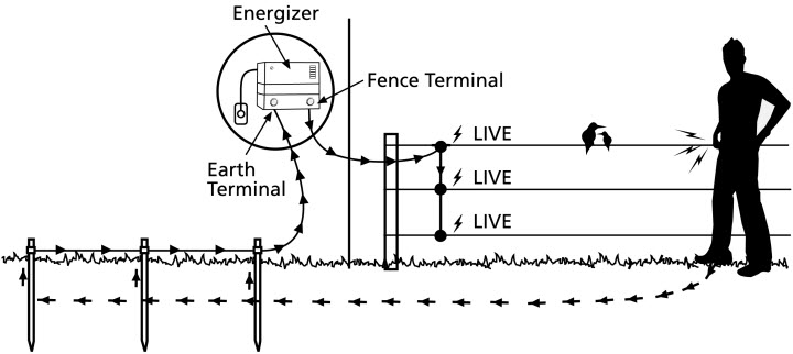

Setting up the electric fence in our new place tomorrow, got about 1800' to eventually hot wire so stepped up our ground rod game a bit and grabbed 3 6ft grounding rods to drive tomorrow.
A much more effective way to "step up your ground game" would be to skip the extra ground rods near the fencer and run a conductor (strand) from your existing ground rod to fence posts along the 1800'. This grounded conductor is actually connected to, not insulated from, the posts.
Remember, the way the fence works is an animal/person only gets a shock when the circuit is completed from the hot terminal of the fencer to the "other" (grounded) terminal of the fencer. Normally, this means the circuit (current) has to complete the LOOP from the fencer's "hot" terminal, through the fence wires, through the object touching the fence, through the earth all the way back (1800') to the ground rod, which is connected to the "other" fencer terminal.
Wiring the fence posts to the grounded terminal means that the circuit:
- Doesn't have to use 1800' of earth as part of the circuit. Only uses "earth" to travel to nearest fence post then back to fencer.
- Has a lot of "ground rod area" (i.e. fence posts) in contact with the ground = good connections.

/ Driving ground rod with bucket? #31
This pictures shows the "normal" path that "shock" current takes in its LOOP from the fencer's "hot terminal" to it's "earth terminal". Using earth for a major part of the loop circuit. When the ground is dry and a poor conductor (with high resistance) the current is reduced.
Now imagine if a grounded conductor (connected from the fencers "earth terminal" and nearby ground rod is connected (not insulated) to every steel post. The arrows representing current flowing through the ground only needs to travel to the nearest post (in actuality would travel to many of the nearest posts through multiple paths). Thus dry ground or poor soil isn't that big of a deal.

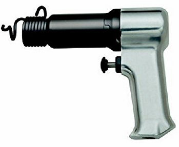

/ Driving ground rod with bucket? #33
With 1/2" ground rod, going into sand, within 50' of my compressor, I've used one of these (no bit, the end slips over the 1/2" ground rod):
Walked it in like nothing. Your soil conditions may vary...
