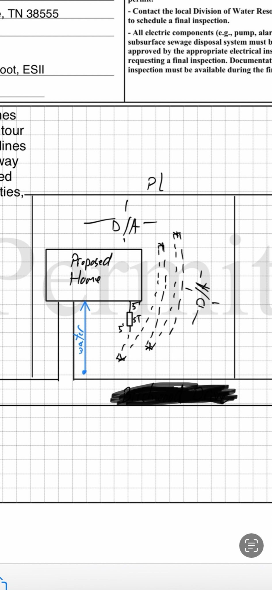

Here’s a picture of a pretty standard septic permit for my area. The leech field is dug 18 inches deep. The pipe is installed on top of 3 inches of gravel so it’s really 15 inches deep. The outlet on the tank is 13 inches under the top of the tank. Code requires the first bed to be at minimum 4” of slope from the tank. Digging the beds deeper isn’t allowed and that’s non negotiable terms. The only way to get more fall to the beds is move them farther down the hill but septic systems take up a lot of room and we’re frequently fighting for every inch of ground possible to get the required footage in while maintaining the property line setback, the structure setback and maintaining the duplicate area so moving down the hill 20-30 ft to get more fall just isn’t possible. So what I’m saying in more words is the septic tank is frequently set with just a dusting of dirt over top and that’s really the only option.
