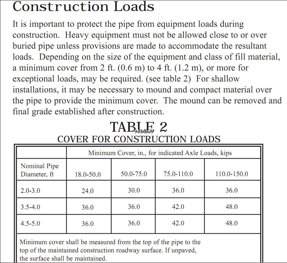

Here is a quite conservative description of what is required for really heavy construction loads when installing culvert pipe.
That is for multi-foot diameter thin-walled culvert pipe. The PO is talking about 4" thick walled PVC, so take those 3-4' results and divide by roughly 10.
Incidentally, I have a 3' culvert pipe bridge that crosses a stream in my driveway with roughly 2' of cover. I had 35 fully-loaded tri-axle dump trucks (24 ton loads - and in all cases with their third axle raised, even though I begged them to lower it) cross the bridge this summer with no problems. I will say that after the first couple of loads, even though everything looked just fine, I remained nervous about the culvert - I dug down a half foot, and poured 3'x6'x4" reinforced concrete pads over the wheel tracks on the bridge to help spread the load. All was good.

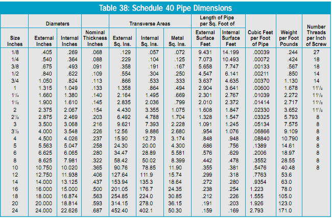

Jay 4200: Actually, the table I posted is for double walled HDPE...sorry if I confused you; I am confused about 4" thick Sch 40 PCV, which you reference.
The attached table shows Sch 40 dimensions and four inch PVC has about 1/4" wall thickness ...even for the bigger diameters, wall thickness gets just over 1/2" ...but, maybe I didn't understand.
My reference to "conservative" was that the info was for HEAVY CONSTRUCTION LOADS, and much less would be required for normal traffic, including tractors such as those normally referenced on this board.
Properly bedded, it is very difficult to deform a circular cross section ...and, of course, pneumatic tires spread the load so that even a heavy truck running, say, 100psi in its tires, only puts 100psi on the ground, as I recall.
Anyway, sorry if I misled anyone
