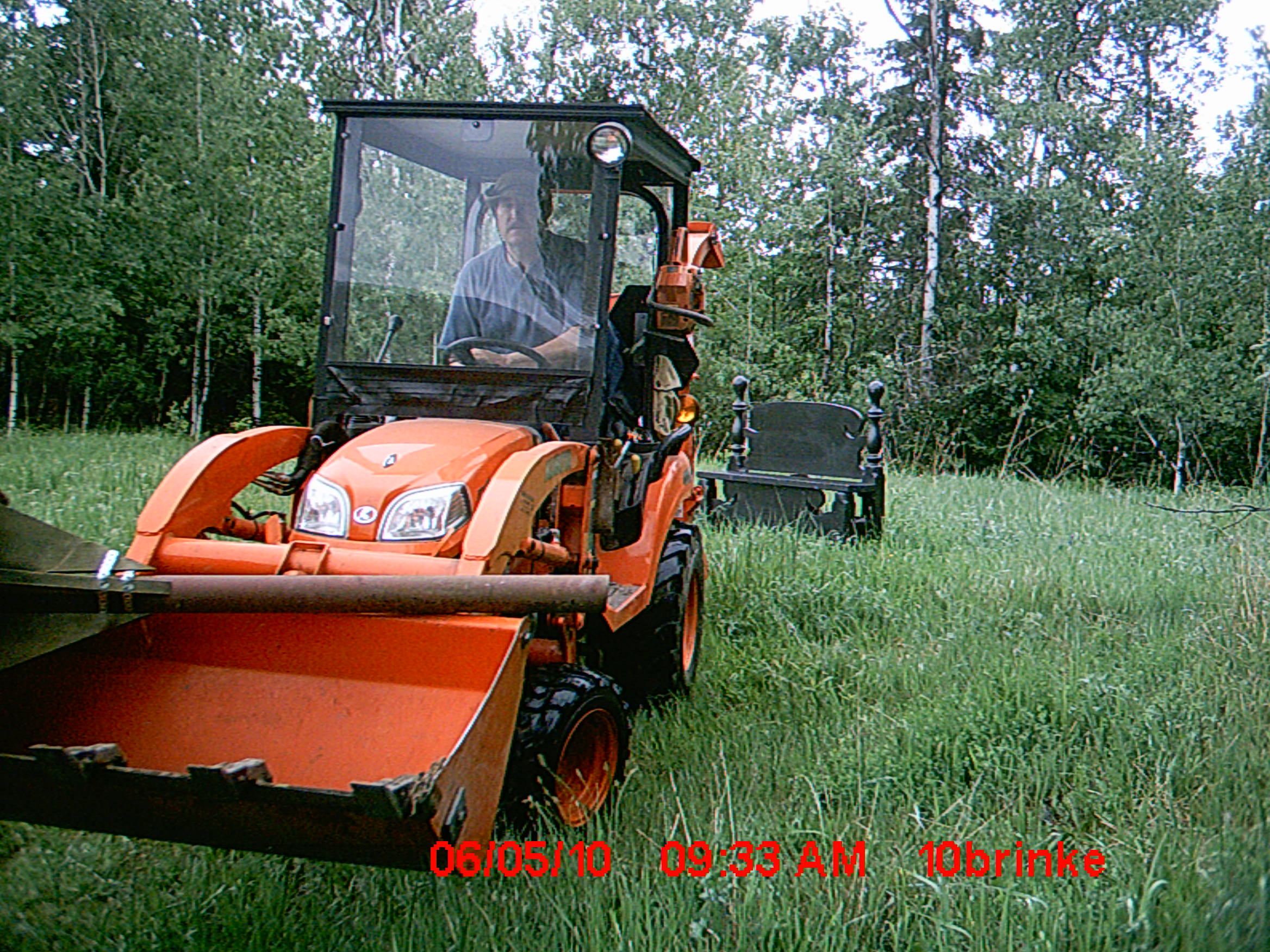

I use this a piece of pipe 4ft long mounted on a wood base with hole in middle. It becomes a one man job, place post holder where want T post to be, slide t post in pipe , 3 feet will stick out , then place bucket on tpost and push down, (using underside of toothbar works good ) may need to adjust by moving forward or back as I am pushing down. Bucket stops at top of pipe.
Works for my clay in spring and fall ............(forget mid summer clay to hard)
Interesting...seems like that would work pretty good
