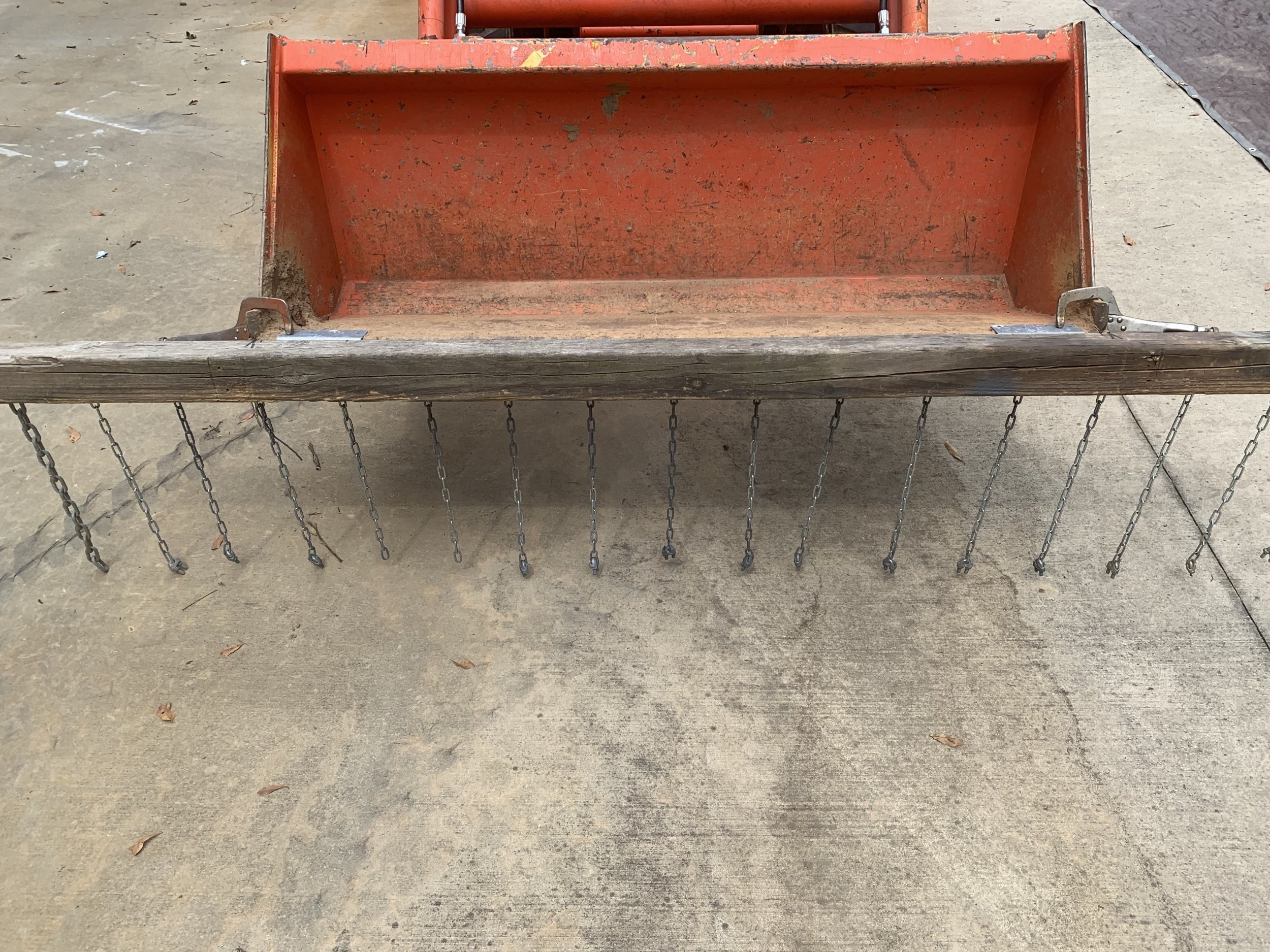

Attached to bucket with 2 welding vise grips on angle iron screwed to 4x4 post. Since chain was just on hand, it was too light so I put cable clamps on end of each chain for weight.
Has worked well.
As a Christian, I don’t believe in killing any of God’s creatures unnecessarily—especially if the reason is just because I was too lazy to spend an hour with a cheap and easy fix.

Agree-see my earlier post on what I do to avoid this. A friend mowed over a 1 day old fawn and has never gotten over it.

I like your design but do not see how this device would help in the case of a day-old fawn. The ones I have seen don't move if they consider themselves well hidden, even when machinery gets closer and closer. `
