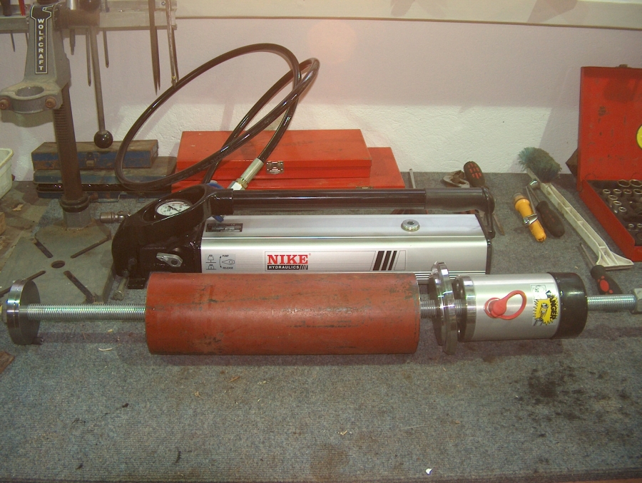

Dident mean to brag, just satisfied with the reasonable prices, not often these days!
Went to a friend today, he is very good with the lathe. Together we made an hydraulic extractor for the cylinder linings. (friends hydraulic) I am really looking forward to test the "thing"
