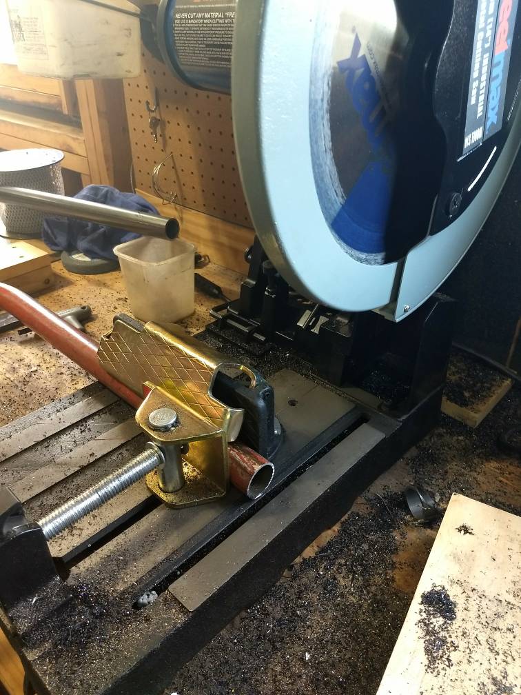

This is one tool that I cheaped out on when I bought it in 2014. I got the Northern one for 239$ The first one I got they sent me a new one as it wasn't cutting anywhere near true. The replacement wasn't too bad but has become out of square (perpendicularly) and there is no adjustment. Now, it cuts perfect when I'm just relying on a 2" square tube on the bench and the edge of the saw. Short pieces that rely on bed, not so much. It is aluminum based. It has cut a lot of 1/2", 1" and even 1 1/2" steel bar over the years and is still cutting strong though. 12" is just too small in my world and if there was a compound cutter that was a 500$ bill I'd buy it in a heart beat. I picked up an Evolution blade at Airgas and they had the better one at $375. The wheels in my head were going, new 100$ blade or give an extra 275 and get one with a better base. I didn't see where that one was able to be trued any better than what I had, so I bought a blade. Thought making a new base that could be fine tuned , make something up to cut angles for gussets would be doable.
