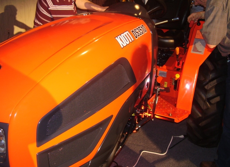

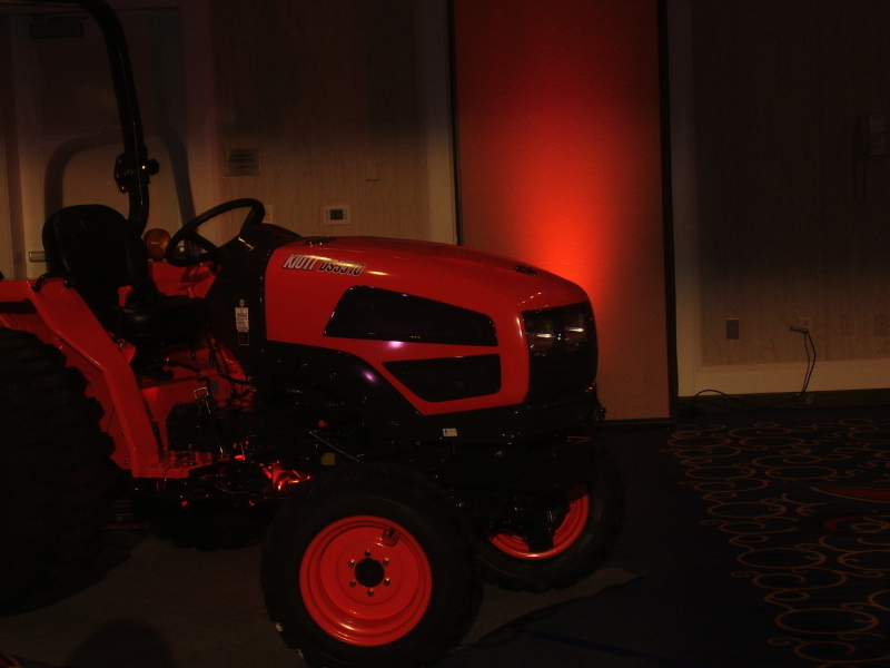

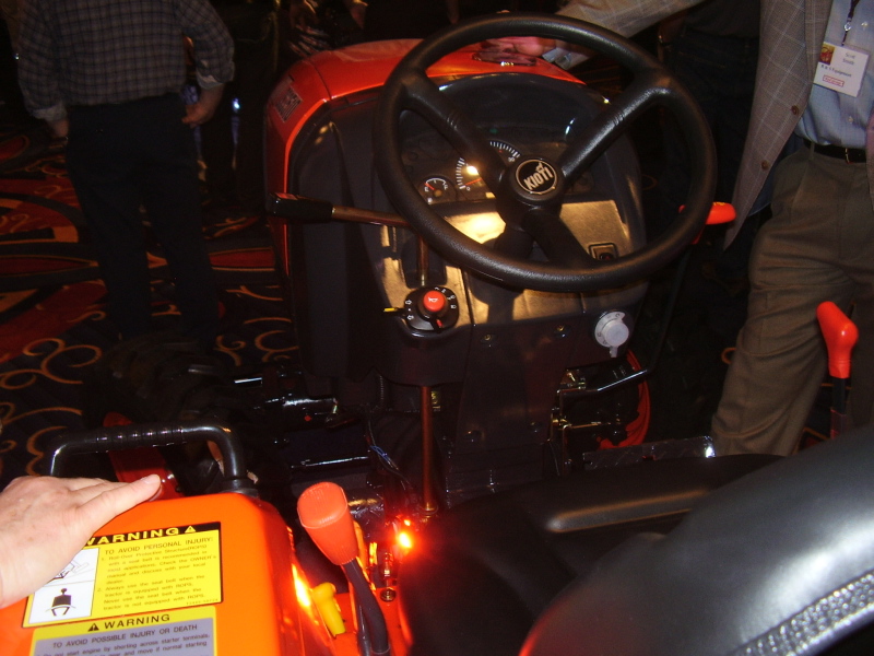

Just drove in from the airport coming from the meeting. The PTO is manual, the chassis is one of KIOTI's oldest designs, tired and true. the 4wd engage is also manual. This tractor is the replacement to the LK30 and has the same chassis, but wiht more HP and CK style hood. it will cost less than a CK30 and have more HP and a stronger loader. the loader is comparable to the loader on DK35SE except with the joystick mounted to the loader frame. I will post some pictures.
/ DS3510 2011?? #11
OK, these are not the best but here they are ds3510 first look at dealers meeting reception. I now realize I didnt take any of the whole tractor in teh daylight during the ride and drive..
/ DS3510 2011?? #12
THE LOADER MODEL FOR THE DS3510 IS KL352 THE LIFT CAP/IS 1155LBS//BREAK OUT FORCE IS 2046LBS
those figures seem to be from the CK loader KL130. I would think the DS3510 would have a loader almost identical to the KL351 which has lift capacity in the 1400lb range as I recall.
/ DS3510 2011?? #13
Looks to be a nice basic tractor. I like what Kioti is doing there.
/ DS3510 2011?? #14
Hey thats 2 tractor in 1!
That is the CK35 hood on an old LK tractor frame.
/ DS3510 2011?? #16
So its a STEALTH tractor!?(refer to pics). Meant to be used at night only so as to not burn up daylight?:laughing:
