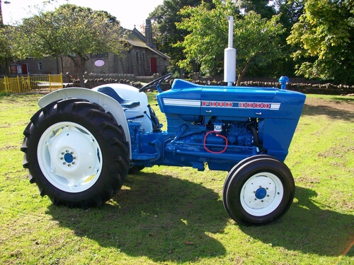

1968 Ford 3000 w Dual 195 loader
Hi Folks,
Total rookie here. Picked up a 68 Ford 3000 withe a Dual 195 Loader. Seems self contained and hooks up to what I am guessing is the front PTO via Pump with spline. Anyway, Used it for a bit , small loads as I learned, and seemed to work fine it was working ok. I unhooked it for about a week while tilling , reattached and it seems like its groaning, a lot slower as well. Drained the oil and the operators manual doesn't recommend fluid type nor can I find a filter I just assumed would be a part of the system.
Any assistance is appreciated . Fluid was greyish / black on draining. Where can I find specs for proper fluid drain/refill unless anyone here knows. Thanks much .

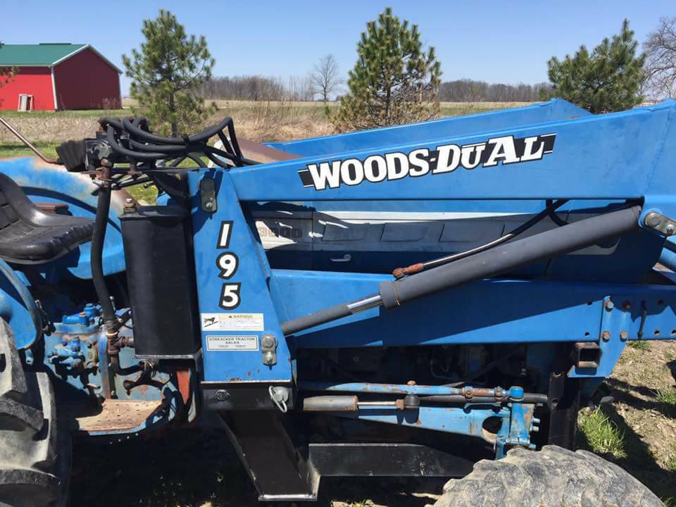

Thanks for the quick reply. I cant find a filter in the system or on a parts list. Its a self contained metal box with the joystick mounted on the frame of the Loader. No filters visible and no idea on how much oil to fill it with. No dipstick either. SIGH......

I知 assuming your knowledge level is low, so I apologize if I sound condescending. Your tractor shares it痴 transmission oil with its hydraulics. So you won稚 find any of this stuff on the loader itself. I just did a web search, and it looks like the filter is on the right side below the fuel filter. It痴 a large spin-on. There may also be a smaller cartridge filter inside the transmission case under ther seat. The filler hole should be at the back by the 3-point hitch.
   / Dual 195 loader #6
This is where the filter should be.
   / Dual 195 loader
LOL !! You assumed correctly !! Rookie is probably overstating my level of knowledge. I'll have to get some pictures of my unit on here . No filter on the side .
   / Dual 195 loader
Thanks ! I do have an owners manual but no pic of any filters or screens that might need to be cleaned. All hoses are connected to the frame as well as the pump and joystick.

Thanks, I found all that as well , but nothing addresses the issues of the filter if there is one . I've searched Missicks and no filter comes up for that model. Im going to have to break down and call a dealer I think . Drained the fluid , not sure as to how much to fill , I've refilled , same issues, ran at 1500+ rpm and still groaning, drained a second time, refilled, same issue though I did get quite a blast of oil from the relief valve :) . Well, my bro in law did , not me. Thanks much for the help. I do appreciate it.
