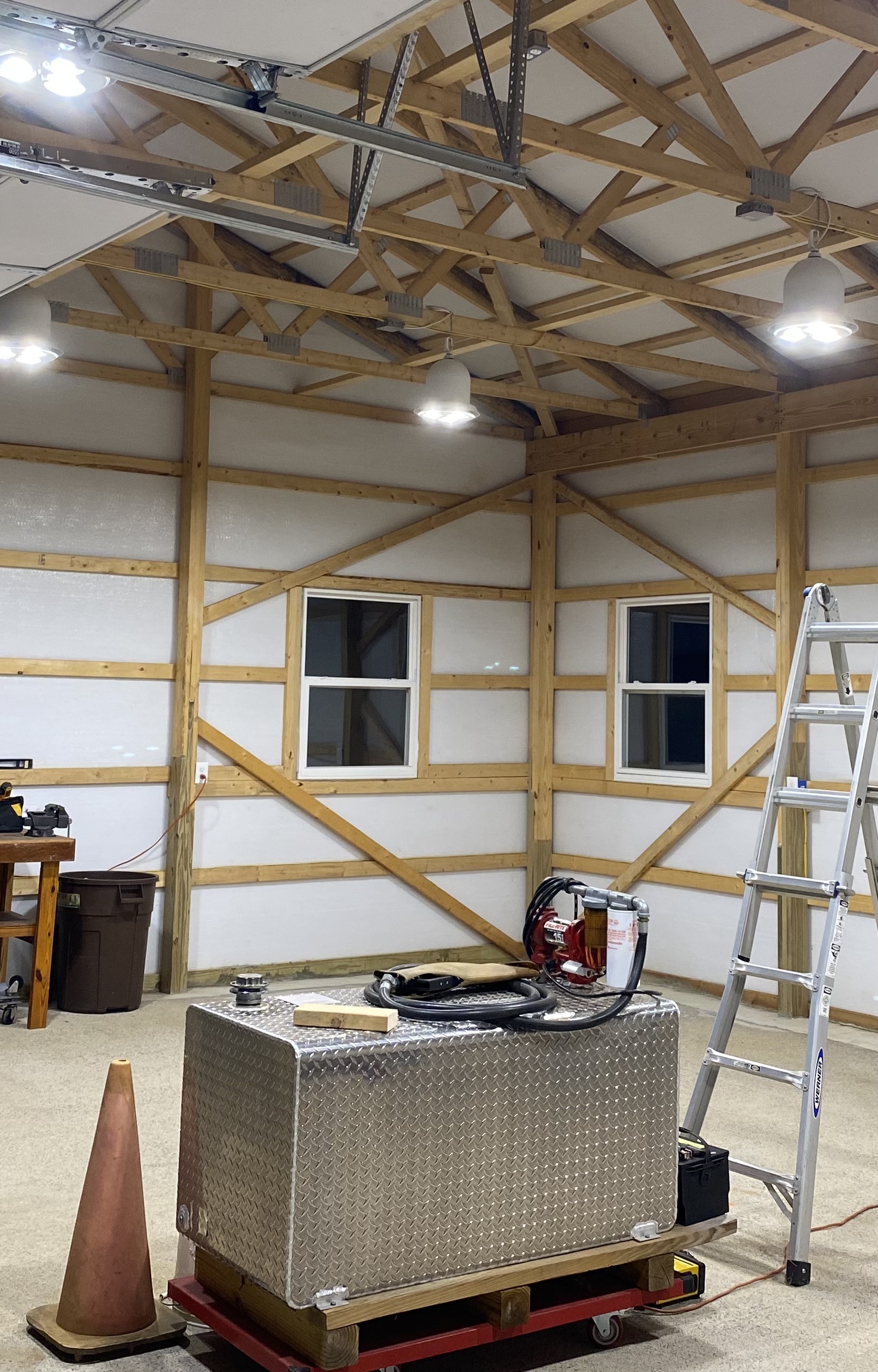

Been thinking about adding filters to my transfer tank. The tank is 50 gallons and came from a reefer.
Seems two filters would be ideal. Water and particulate.
I have a cheap 12v pump that sucks the fuel from the top of the tank. The tube is about 2” from the bottom of the tank. I could take fuel from the bottom as well
What would you guys recommend?

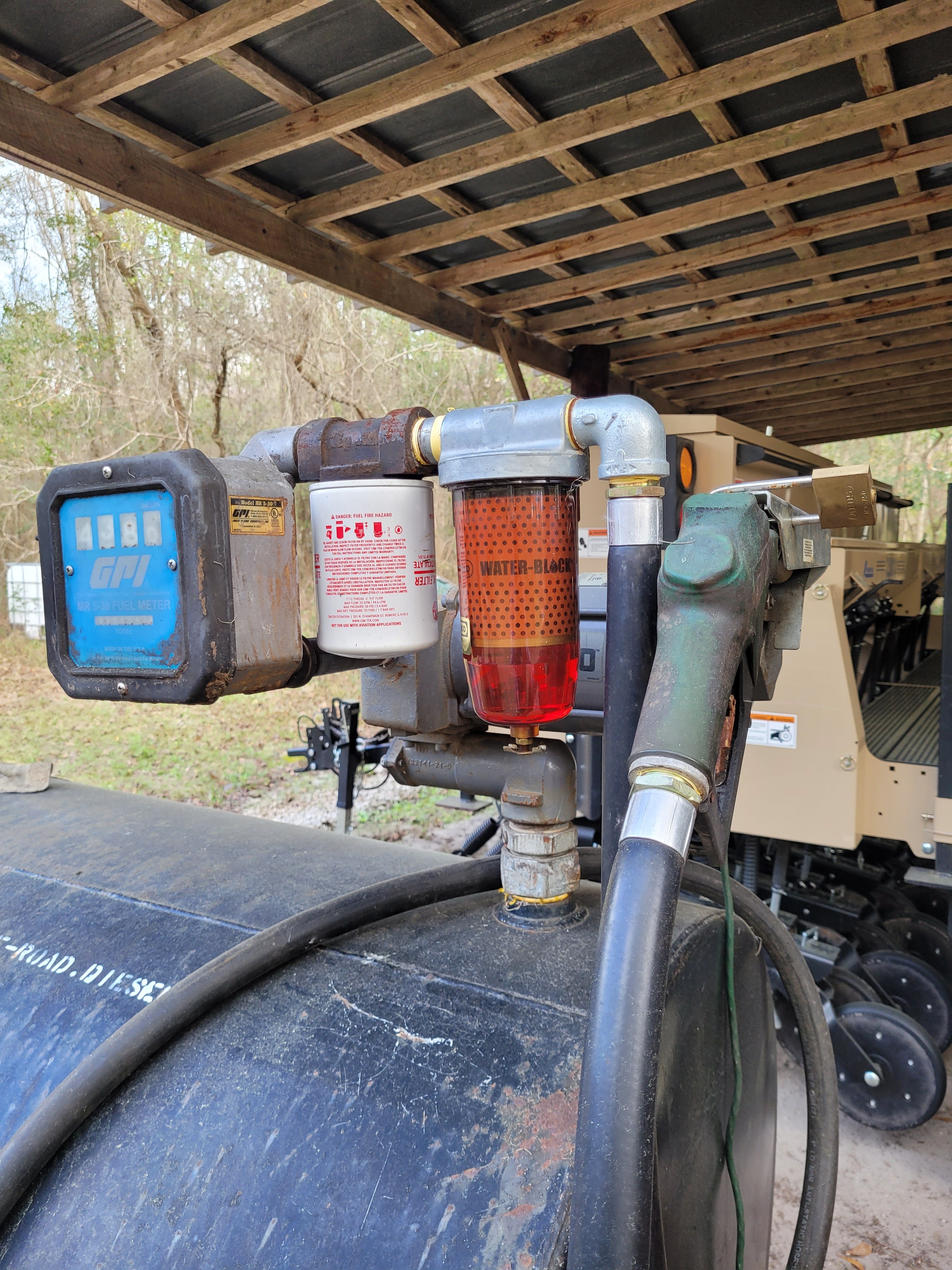

I use a goldenrod water separating bowl filter with a 17u filter first in line so I can see any contamination, followed by a 2u final filter.
   / Dual filters for transfer tank #4
Goldenrod filter water separator and then a 2 micron final filter.

I use a particulate and a Goldenrod water filter on my 500 gallon diesel storage tank and I am a firm believer in more filtration is better, especially with today's common rail systems on diesel engines , they claim just a little water can be fairly detrimental to your wallet.
