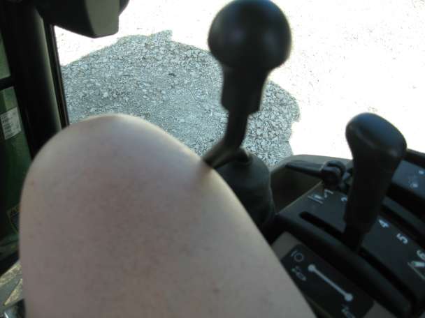

In short is there a straight up Dual Selective Control Valve (SCV) Lever available that can take the place of the shaped Dual Selective Control Valve (SCV) Lever?
I have a cab 3520. The Dual Selective Control Valve (SCV) Lever is bent toward me the operator and my leg rubs up against it. I wear shorts during the summer and I got heck of a blister from my leg rubbing against the lever after a particularly long day of mowing. Now that I have the blister healing its still a little sensitive and I still find the leg drifting over and rubbing against it. I guess I could put a pad on the lever, but I'd rather find out if there is another Dual Selective Control Valve (SCV) Lever available that goes straight up. My leg banging into the current one occasionally affects the bucket position too.

I had the same problem on my 2350 I was constantly bumping the control valve and lowering my mower. I didn't check with John Deere. Since I am handy at fabrication I decided to make my own. My original lever was fabricated out of a tube, I made my new one with a 3 foot piece of 1/2" cold rolled rod. The hardest part was making the endpiece that attached to the control valve. Bending it was easy as long as you have a torch. I just reused the rubber knob on the old one. It works super, I no longer have it rubbing the back o f my leg, or side of my thigh. I applied a good primer and two coats of flat black paint. The best thing is no one can even tell its not original! If you want I will take a picture later and post it. I think the whole thing cost me under $5.00. I am now looking to fabricate a step to make getting on and off easier. (got to keep the wife happy, She loves to mow with this new machine)

It's been two years with my cab and I still have my rose colored glasses on. I'm 6"3". This didn't happen last year. I wonder why it is this year. Maybe another tractor model...yeah a 4720 might work...wait..you meant lever from another tractor, darn. A 90 degree clockwise would let my knee not hit. I don't have any welding gear. I suppose a vice could straighten it.
I lifted the boot off and there is a tee like offshoots to three valves, so it is not possible to 180 it with the current lever. The 4x20 series uses the same lever and part number as the 3520. I don't want to fuss with the lever, a straight lever drop in replacement would be desired.
Attached is a picture with my foot on the pedal.

Per your picture you are not hitting the scv levers as they are located beside the draft lever. You are contacting the joy stick for the loader. The only thing to do is take it out and heat and bend. The bend in the lever was put there to prevent contact and it does for most people. If you do not have the equipment to bend it just take it to your dealer and they can do it for you.
