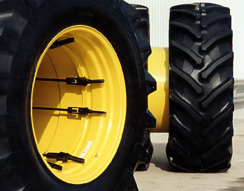

I've been contemplating increasing the width of my tractor to the widest setting, which would correct one of two issues. I've thought also about adding dual wheels to the rear. I understand it is much more expensive than simply swapping the wheels to get a wider stance, but in addition to a wider stance it also draws the center of gravity down on the tractor by putting more weight down low, and it puts more surface area on the ground for improved traction and less sinking going over soft ground.
I've found a couple solutions to add dual wheels to a tractor, but I was wondering what sorts of experiences folk here may have had with such additions and what was used.

We ran band style duals on our 5000 & 5600 Fords. 5000 was 13.8 x 38's 5600 16.9 x 34 if I remember correctly. We did this for floatation and traction more than stability. A word of caution, run the duals at very low PSI to help prevent breaking the axle.
/ Dual Wheels
Are the band style the ones that use the "T-Bar" type attachment system? Basically a rim with no center and use connectors that connect them to the outer edges of the main center?
I was not only going to run them a little lighter on the pressure, I was also planning on using a set of tires that are worn down a little compared to my main tires so they wouldn't make much contact on hard ground. The only time they'll make good contact is once the original wheel starts biting into the ground.
/ Dual Wheels #9
Yes, that is what I call band type. The only problem we ever had was mud packing in between the tires turning them into one long slimy mess.
If you get this style, tighten the clamp bolts, drive around for awhile, retighten bolts. May have to do this two or three times before everything gets seated and the bolts stay tight.
Installing them, we ran the rear tire up on a 4x plank and then just rolled the dual up in position. Hooked one of the bottom bolts, tipped the dual up and hooked one of the top bolts and started tightening them down.
removal, loosen the bolts and drive the dual over the 4x, 99% of the time the dual pops loose and you can roll it to the storage area.

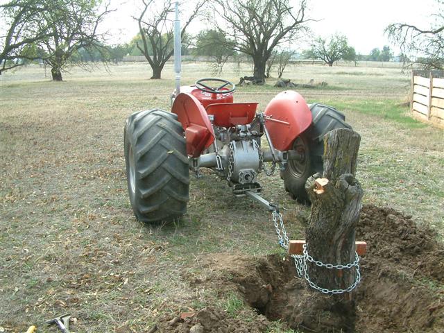

Duallies are one way to go. Here's another idea
That's my 1964 MF135 diesel -- a field tractor that's been modified for orchard work. The usual 28-32" dia rear wheels have been replaced by 16" dia wheels carrying BF Goodrich 6-ply 18.4-16A rubber (18" wide, 16" dia rim, 40" tall overall). The front axle spindles have been shortened to keep the tractor level. The rears are filled with water (no problem with freezing here in the North Sacramento Valley). Result: low CG and large track width = high flotation, stability on slopes. Those rears are stocked by many tire retailers that supply the agricultural market.
Good luck

Sweet ride, I've seen some of your pics of it in other threads. I bet it's a stump puller and a half. Those are not mods I'm willing to attempt on a brand new machine, and that's even before beginning a discussion about what would be involved in doing such mods to a 4WD. I'd rather the modification be a bolt-on of some sort.

I have driven tractors with this style and they require that the axle be long enough to support another hub. These allow for the option of "row crop" duals where you can straddle corn rows with duals on.
