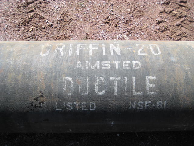

I was wondering if anybody knows if I can weld this?? or to it. I have an idea of what I want to do, but if I can't weld on it, it changes everything. Thanks
Not very well, youmight try using cast iron welding rods, but if strength is required forget it. You might put a saddle around it and work off that.
   / Ductile pipe ??? #5
Ductile iron is not cast iron. Ductile iron pipe is the standard water main used for 12" and larger pipe around here. It can be welded with standard rod, but I don't know which would be best. Because of "hot soils" here in the desert, we do not use any saddles (they corrode very fast - even stainless) and all tee's for hot taps are welded to the pipe.
Ductile iron pipe is commonly coated with an asphalt based material so be careful of fumes.
   / Ductile pipe ???
Thanks for the help. Turbo36 thanks for the link, I'm thinking I brought home a 20'- 2000# culvert :( :eek: I'll have to think about it some more.
