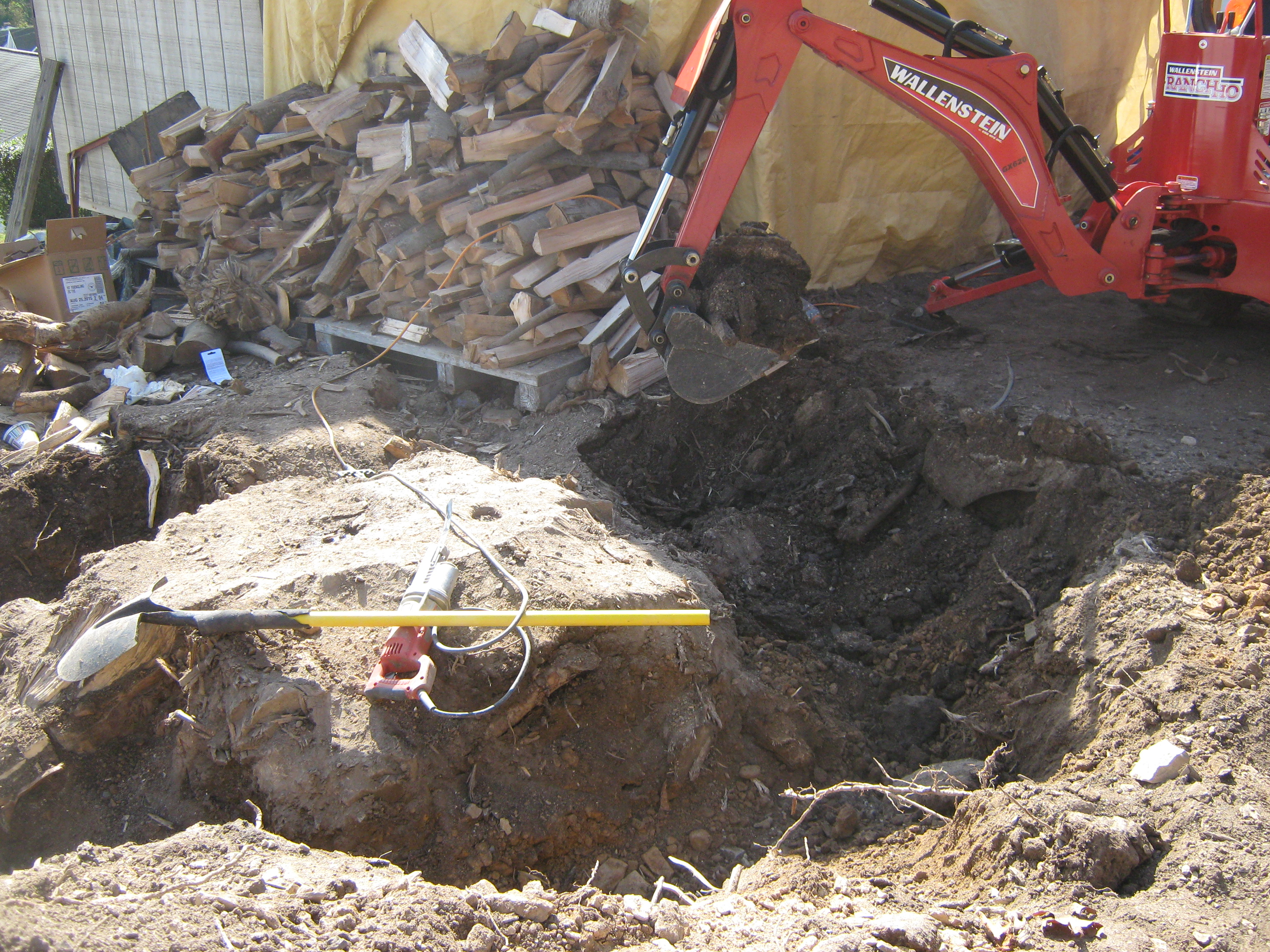

Dug up an old stump that's been annoying us for some time and drawing termites too close to the house.
This took approximately 5 hours on the tractor's gauge to dig up and drag away. It was heavy enough that the FEL wasn't able to lift it, even after spending some time clawing the dirt off the rootball. I was unable to roll it out of the hole with the BH too. I ended up just pulling it out of the hole and off a way before pushing down a hill to other stuff to be burned.
Stump's on it's side. Paused while clawing dirt from root ball:
Pulled out of hole:
I'll be paying somebody to grind the stumps in the front yard.

Soft white poplar stumps that size that I dug out took days, since they were fresh-killed and the roots too much for the mini-BH. Wish I'd had the ripper tooth back then, but I'd have been switching to/from the std bucket a lot. That said, it'll shred some rotted roots/stumps.
Different approach, but I just got the DR 14hp stump grinder and did a dozen from 4"-~14" (across) at three locations, on < a gallon of gas, and in one afternoon. As much or less hand digging on the stump grinds as stick twiddling with the BH IMO, and the awesome <200lb grinder trailers/travels a lot more easily. (IMO decaying roots may settled more over time that a typical post-dig back-fill.)
Anyway, nice work on those stump(s), guys. :thumbsup::thumbsup: You never know what you'll get into.
btw and a little OT, the 'ripper' gets roots up pretty well w/less ground disturbance than BH bucket on say 4" & smaller trees and most shrubs (IE: overgrown autumn olive with 1/2 doz+ arm-sized 'trunks'.) Stuff the Brush grubber can't just yank (saplings) comes out after a few strokes to loosen roots. (Often times I'm just tamping vs back-filling a hole, too.) The big guys, esp in the yard, well .. they're gonna be a mess no matter how you get 'em out, but won't be missed.

I've dug up a few to large for the loader or the hoe to lift out of the hole .... used a chain and drug them out. Once out, most can be shoved along with the FEL if you are careful .... otherwise, just drag it behind with a chain or burn it where it sits.
