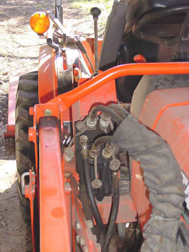

I've got a B-2910 2001 and would like to know answer to a few questions that have been asked to me.
Is my tractor hydraulic system closed center or open center?
OEM Top link length?
How does side link mount on the top & bottom?
What is the length of the fixed side link? (mount to mount)
I have front-end loader. Does the control valve have a power beyond port on it?
Picture attached of FEL control.
Does it have exterior rear couplers?
Thank you one and all for help with these questions.

I take it you are trying to order a C & C Top N Tilt.
You Operator's Manual will tell you about the open/closed center. My B7510 is Open center.
OEM top link length: Take top link off and screw in as short as it will go and measure length, then screw it until it is long as it will go, making sure you have about 6 threads engaged and measure length.
Fixed side link will either be a "ball" like the ones on the end of your lower 3PH arms where you attach a box blade or other implement, or a "clevis", looks like a fork that goes over the lower arms. It is "probably" a clevis type on both ends, if so measure from center to center of the pins that hold the link on.
The fixed side link is on the left if you are standing behind the tractor and does not have any adjustment to it. The one on the right side should have threaded rods with an adjuster that you turn to lower and raise the right side of the 3PH.
My B7510 has a power beyond port. The Operator's Manual for your loader should tell you if it is power beyond. My loader valve looks a lot like yours so I would "guess" the answer is yes.
It does not have rear couplers unless you ordered them as an option which I seriously doubt that you (or the original owner) did. If it had them you would see 2 quick connectors like you have on the loader valve and they would be behind the tractor seat.
I am about to order the same system for my B7510, that's how I knew what you were asking about.

Here is a thread that list dimension and other information for Top & Tilt for B27-2910. If you check out other post in the thread you will find answers to your questions. Click Here
B2910's have power beyond.
The thread will help if you are going to install the system yourself.
