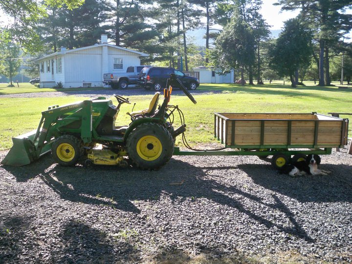

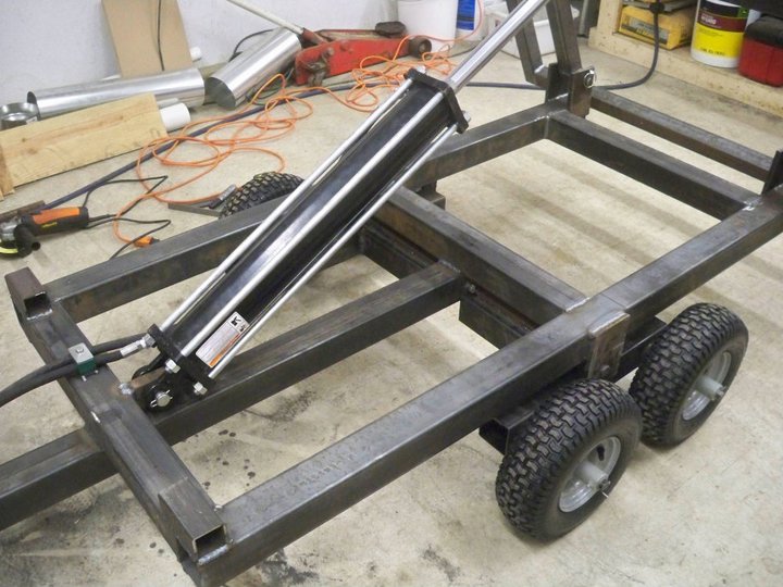

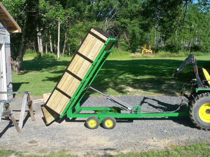

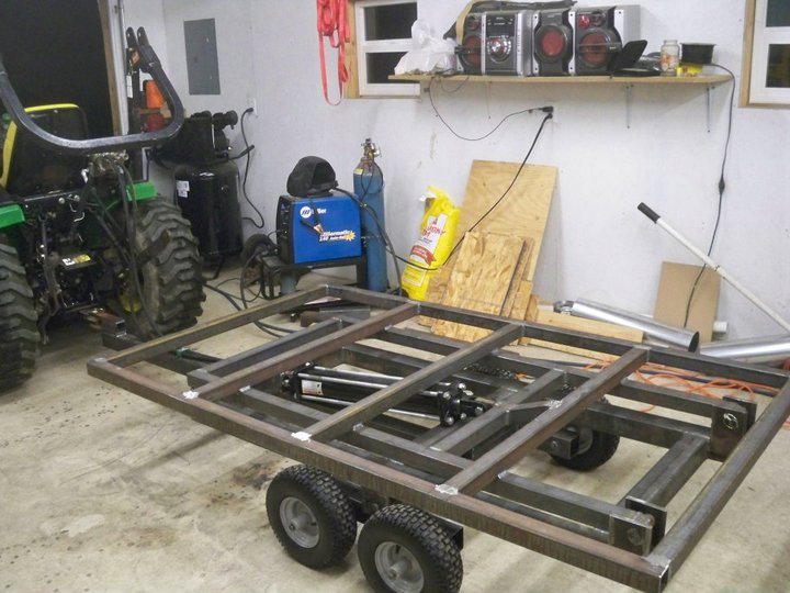

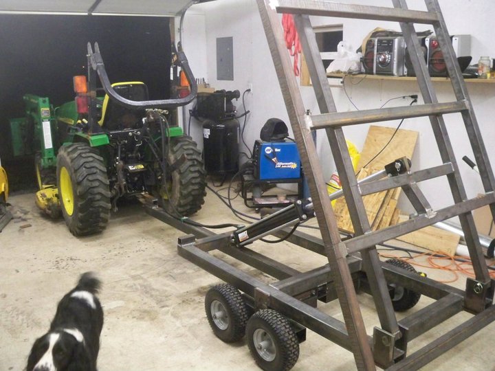

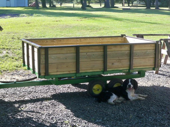

Heres a link to my thread on my dump cart. Maybe it'll give you some ideas, maybe not. http://www.tractorbynet.com/forums/build-yourself/211560-my-dump-cart.html If I was going to do it all over again, I would have put bigger tires on, but it looked good on paper at the time. I have since, put a jack on it. Even though the tires look a little small, it's still holding up great. That's many loads of top soil loaded heaping full and also a few loads of logs. It has stake pockets on it so I can take all the sides off or just the front and tail gate which makes it nice for hauling logs up to 12 feet long. The hydraulic dump is by far my favorite part about it, I probably could have went with a shorter cylinder at the time, but the 70 degrees of dump angle I get assures me nothing gets stuck while dumping. haha Hope this helps, any questions, feel free to ask.

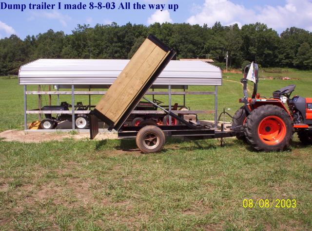

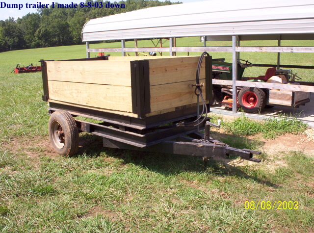

Get cyl. set to at least 15 deg. otherwise if you get the front filled to much it can lift it, it takes alot of force to get it started up. I found out the hardway on my bigger trailer. Here is a couple pictures of my bigger one that I made for L3010 kubota 30HP. I still have it and use it all the time, it has moved many yards of gravel and clay.

Thanks nyen, The inside of the bed measures 50" by 84" and the sides are 16" high. The cylinder is 3.5" bore with a 24" stroke. I'm not sure what psi my tractor is, all I know is the valve flow is 5.1 gpm. I think the total flow is around 8 gpm but I'm not sure. As for the auxiliary hydraulics, I followed a thread here on tractorbynet. You basically need to just buy the parts and bolt them up. There is a hydraulic block that bolts on the side of the transmission where the oil goes to the loader spool valve. You have the loaders in and out ports, but there is also 2 more ports coming out the bottom that are plugged off. These are the ports I used for the auxiliary hydraulics. To use those ports you need to take the block off and there is a set screw you can get from john deere that screws into the inside of that hydraulic block that lets the oil flow to the new ports, while still supplying oil to the loader valve. I'm not sure if the 2320 is the same, but I can give you my parts list of everything I ordered to add the auxiliary hydraulics if you want. I have right around $250 in everything including the 2 spool valve and fittings and hoses. As opposed to john deeres "power beyond kit" that supposedly costs around $300 and you dont even get a spool valve, just a line to connect the in and out ports.
