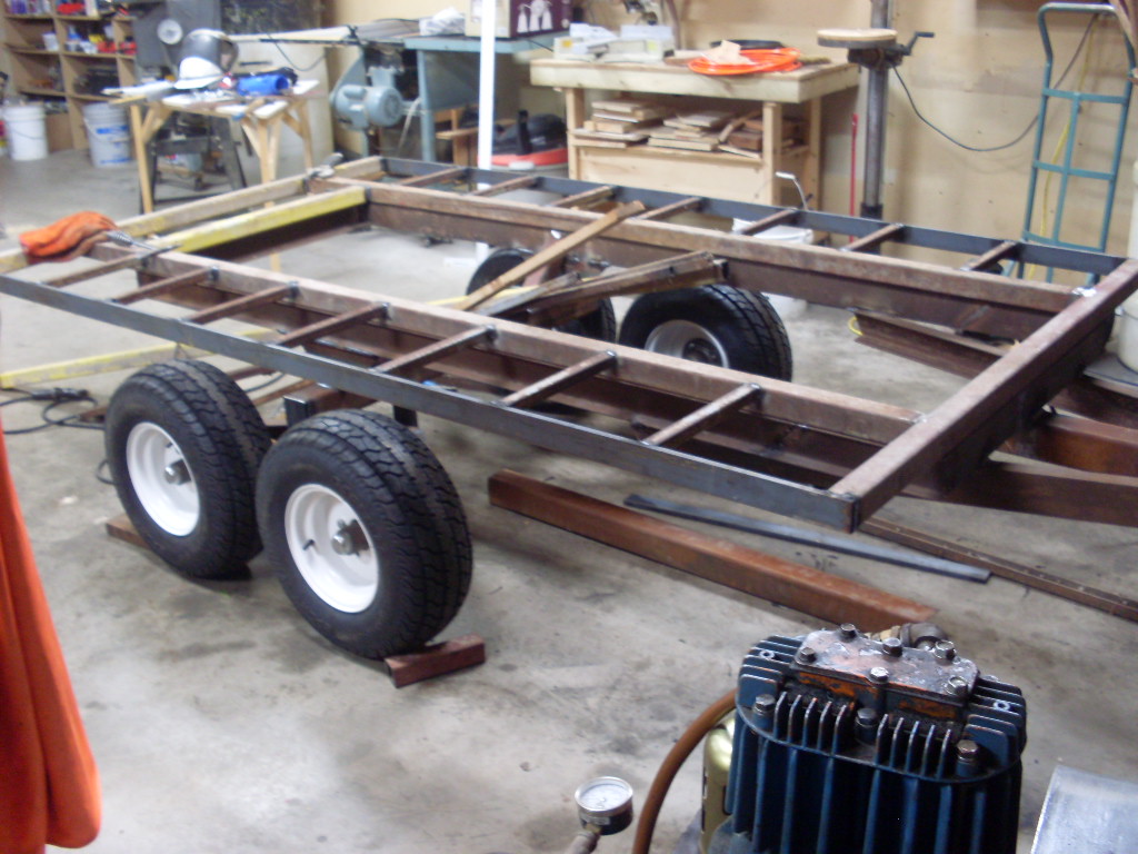

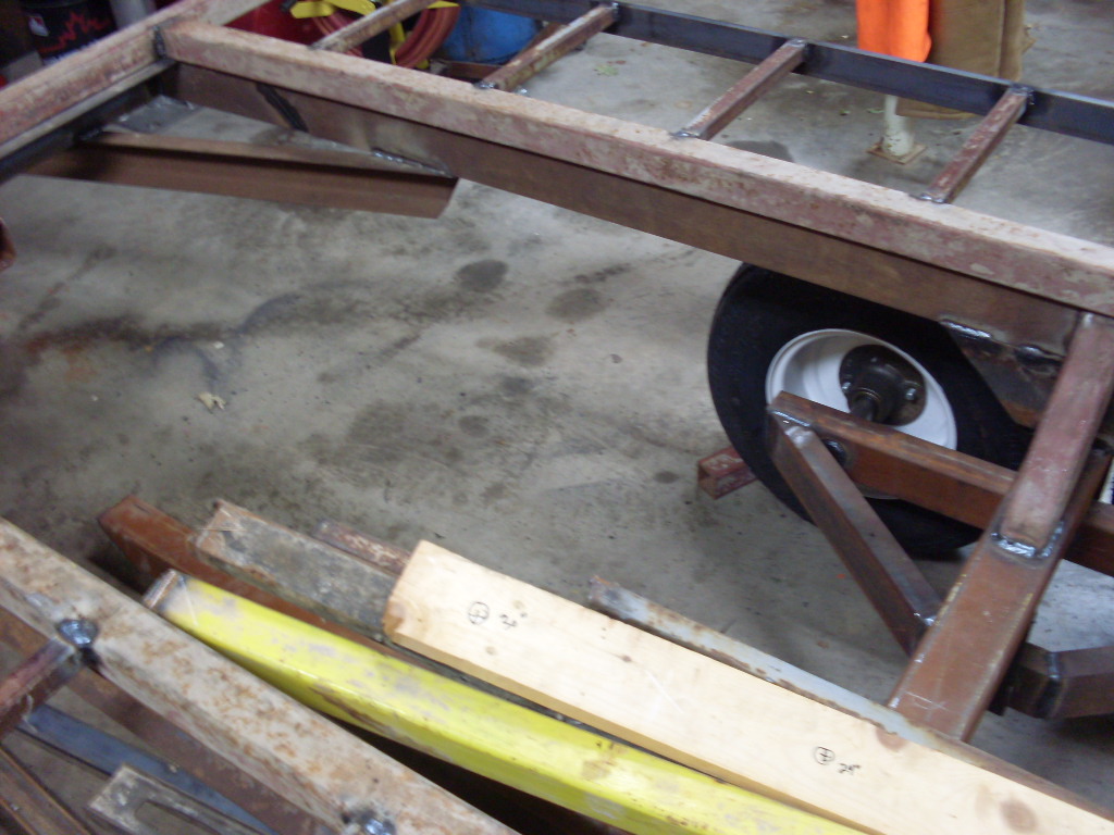

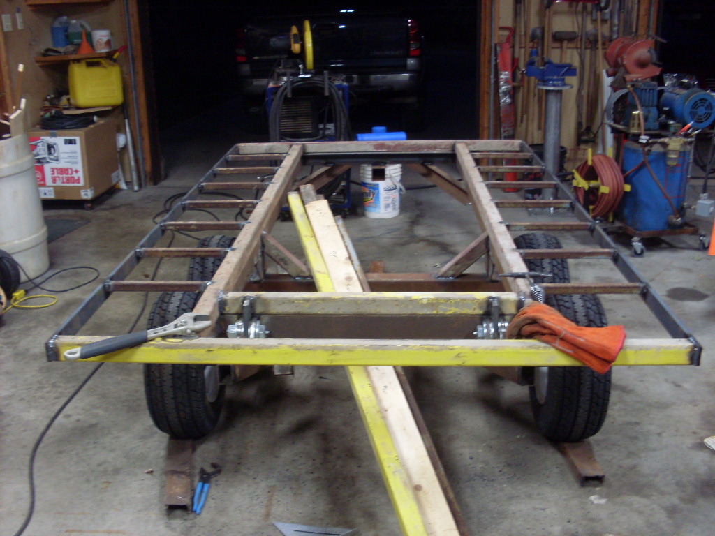

I'm in the process of building a dump trailer and I'm not convinced a three inch cylinder will dump what I have built. Is there a calculation that I can use to figure out the starting force I will need at the bottom end? If so, I can post a few dimensions and pictures to help figure it out. Any help would be appreciated. The cylinder I want to use is 3" dia by 30" stroke (gives me approx 55-60 degree dump angle), the bed is 61" wide by 102" long, the hinge is centered 10.5" from the back, the pivot for the cylinder is 53" from the dump end of the box and 9" vertically lower than the box frame. Did I miss anything? My tractor produces about 2500psi, so that equates to about 8 1/2 tons of force on a 3" cylinder
Thanks a million
Steve

I think so. A 3 in cyl with 1.5 in shaft, at 2500 psi will have a push force of 17,671 lbs
At 45 degrees, the push force is still about 12,496 lbs

Thanks J_J, the starting angle will be about 10 degrees, what force would that equate to? Do you think it will push up a two ton load?
Steve
   / Dump Cylinder sizing #4
You will have about 3,069 lbs. of push force You could go up to a 4 in cyl, and at 10 degrees, will have about 5,455 lbs of push force.

J_j, is there a chart or calculation that would tell me what force is available at certain angles? I could lower the cylinder pivot to get a better angle?

Is it possible to use a trunnion mount cylinder, to get a more advantageous initial lift angle.... a 30" stroke cylinder is taking 36"-38" of space...personally I would go with a trunnion mount teleskopic cylinder.....long stroke, short retracted....but I assume that wont fit in the budget.....LOL...

I saw a dump trailer at a local trailer store today, that somebody had overloaded, and tried to dump. The twin cylinders appeared to have moved something, but it wasn't the load. Instead of lifting the load, they just pushed the frame away from the load. So if your going to increase the lift strenght, make sure the frame will handle what they cylinders are putting out.
