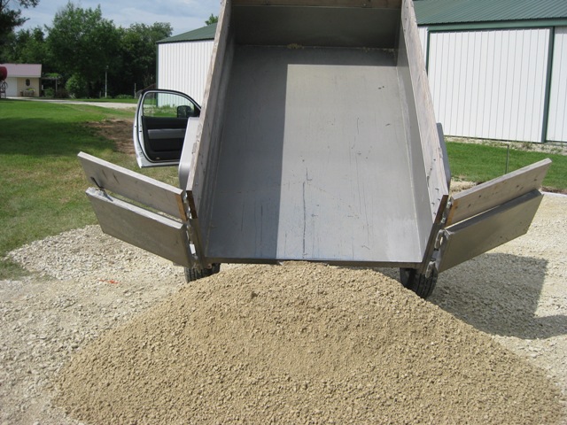

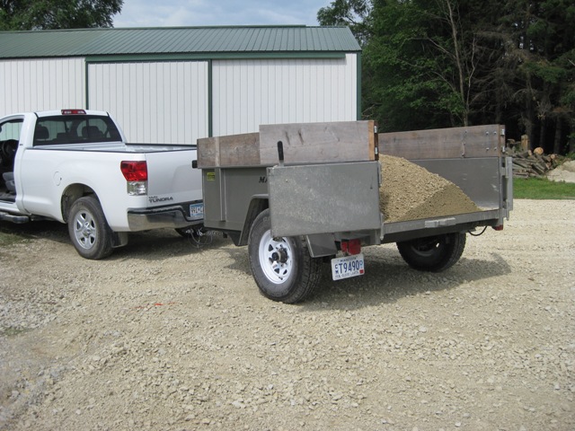

I hear ya. All though, I reached that stage a few years back. So I bit the bullet and bought one. I wanted one that I could safely pull with a half ton pick up. So I bought a 5x8, single axle, 6,000 lb. gvw. I also opted for the double rear swinging doors in the back. And I'm glad I did. The standard option was a spreader tailgate. I couldn't quite see the usefulness in that. Since a spreader gate is designed to be used while in motion. You can't run the dump and drive the pick up at the same time. The swinging doors also allows me to load the trailer with a fork lift for loading pallets. I have to say that this has been one of the most useful trailers I own. Forget the dump feature for a moment. I use it to haul almost everything else. From seed corn, to fertilizer, pallets of anything can be loaded straight in the back. And with a 6,000 lb axle, I can easily haul a couple tons. Got a big load of sheet rock or plywood to haul? You're not going to overload this trailer. I added a 2x12 all the way around the top for hauling things like wood chips, mulch, or lawn clippings.
As far as the hyd. They couldn't be simpler. Electric over hyd. with a single acting cylinder. Power up, and gravity down. The battery on board also is used for the break away break controller so you don't have that little battery that always seems to be dead to deal with.
This one happens to be a Maxi-Dump out of Janesville, Wi. I am not affiliated with them in anyway. I'm just letting you know what brand this one is. I ordered it over the phone and they delivered it to my front door. It has been a wonderful assets here for the farm and gardens.
