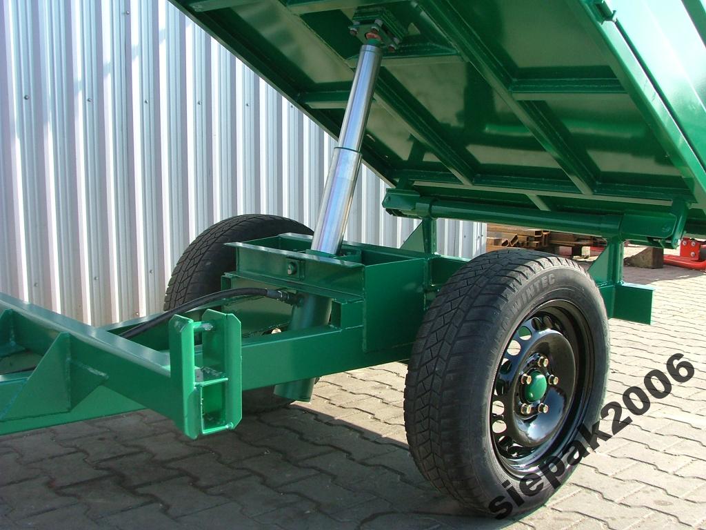

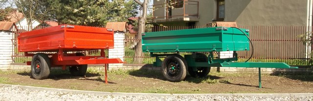

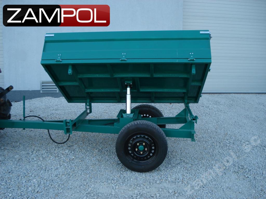

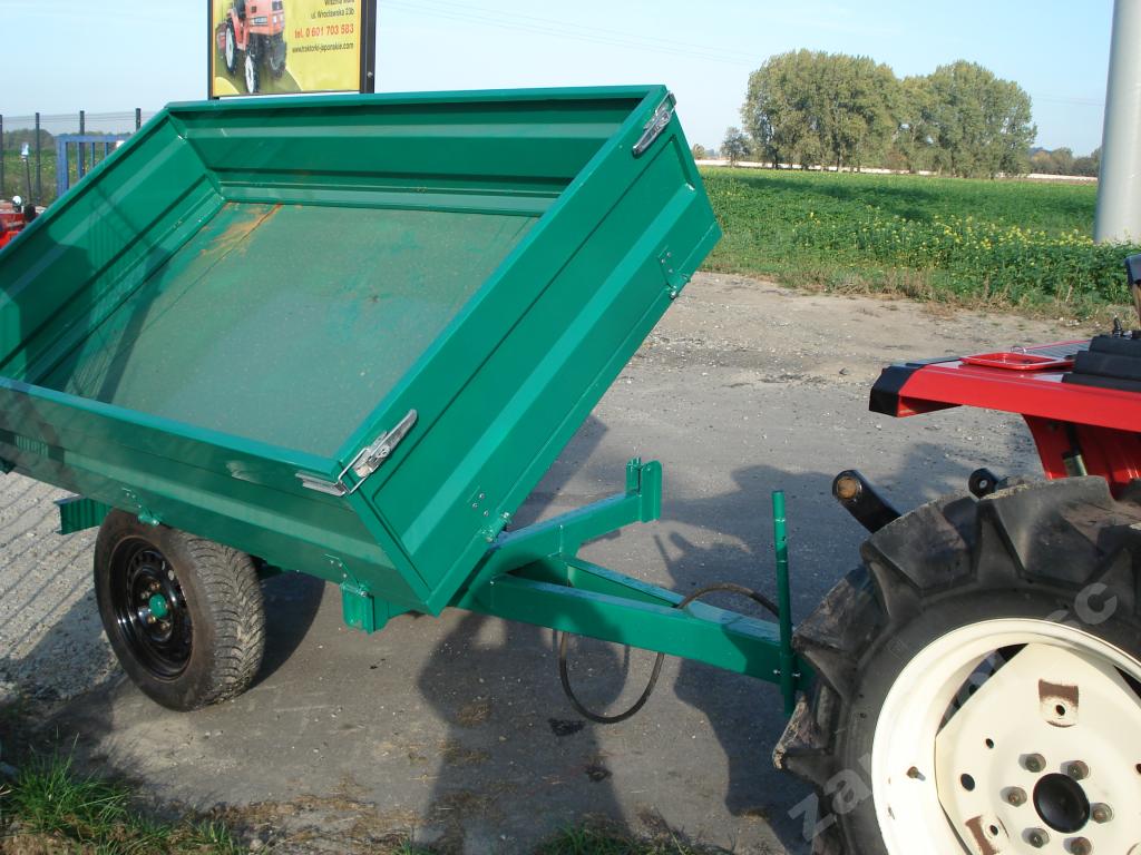

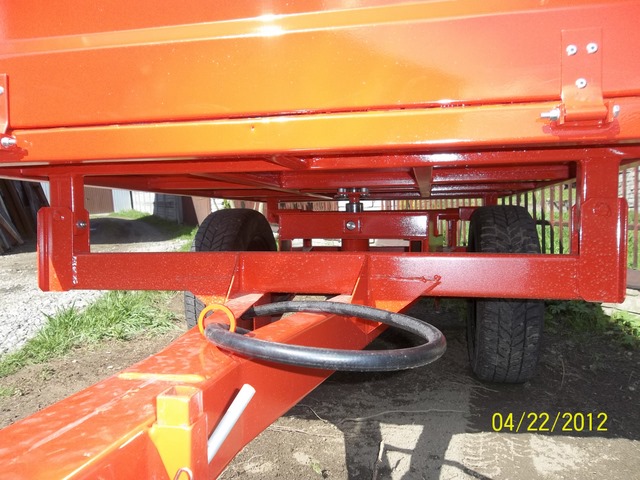

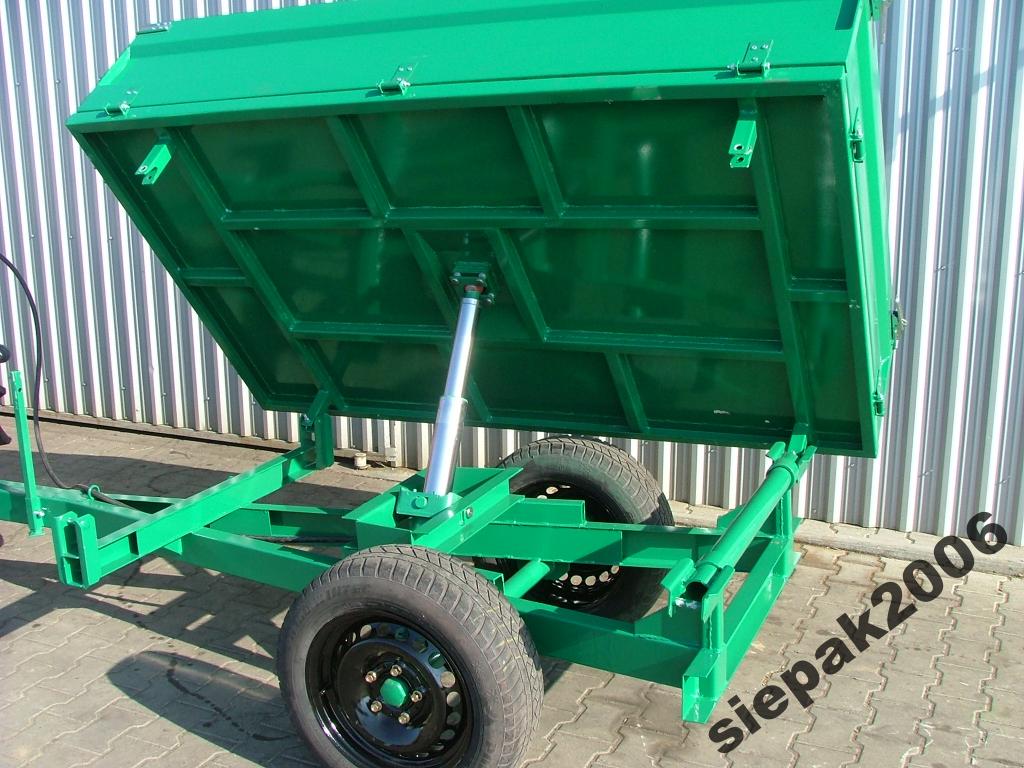

That was not my trailer--it is a trailer that is for sale here on a site similar to ebay. It is pretty cool and utilitarian, but to get it you would have to build the trailer higher than I wanted my trailer to be. Also, because the sides and ends fold down it is not as strong as one that is all welded together. It all depends what you like.
The one that I pictured earlier has round balls at each corner and special sockets to fit them. I do not know where you would buy those. However, there is another trailer for sale here also that is similar, but a little bit smaller. Its construction is such that the 2 way movements is achieved with simple elements. I include pictures to aid your fantasy. :D
One thing to note is that the cylinder has to have a ball or some sort of construction so that it can pivot in 2 directions. My cylinder had this at both ends and I made the sockets to fit on my lathe.
Here is the link to where they are on sale.
Mike
I forgot to add to buy one here costs about $1200. ;)

NICE! Thank you Mike...Very cool, inspiring it is. Looks like the
"balls" in the first pic are just trailer hitch balls.

I thought that you would like those orange ones. :D
The "balls" in the first trailer probably are 50 mm (2 in) but they have holes drilled though in the middle so that they can be pinned in place for dumping which ever way you desire. That is the dimension that the balls on my cylinder are.
If you want the option of being able to dump to the side then you have to locate the cylinder in the middle of the bed and vertical.
I do not know the company name of the trailer, but it is a small Polish metal fabrication shop. It is being sold by several different tractor sales firms. The pivots in the second trailer are pretty simple and easily fabricated.
