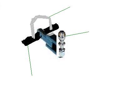

thought this adapter might work if you can understand this crappy drawing I through together
I figure if the trailer has a standard 2 in ball tongue. you could take a standard slide in put a 2 inch ball on it and weld a steel plate across the bottom, put a heavy duty U- Bolt on it and hook the U-Bolt on one of the teeth on the back-hoe and tow it away.
I admit it seems to simple to work but it just might do the job

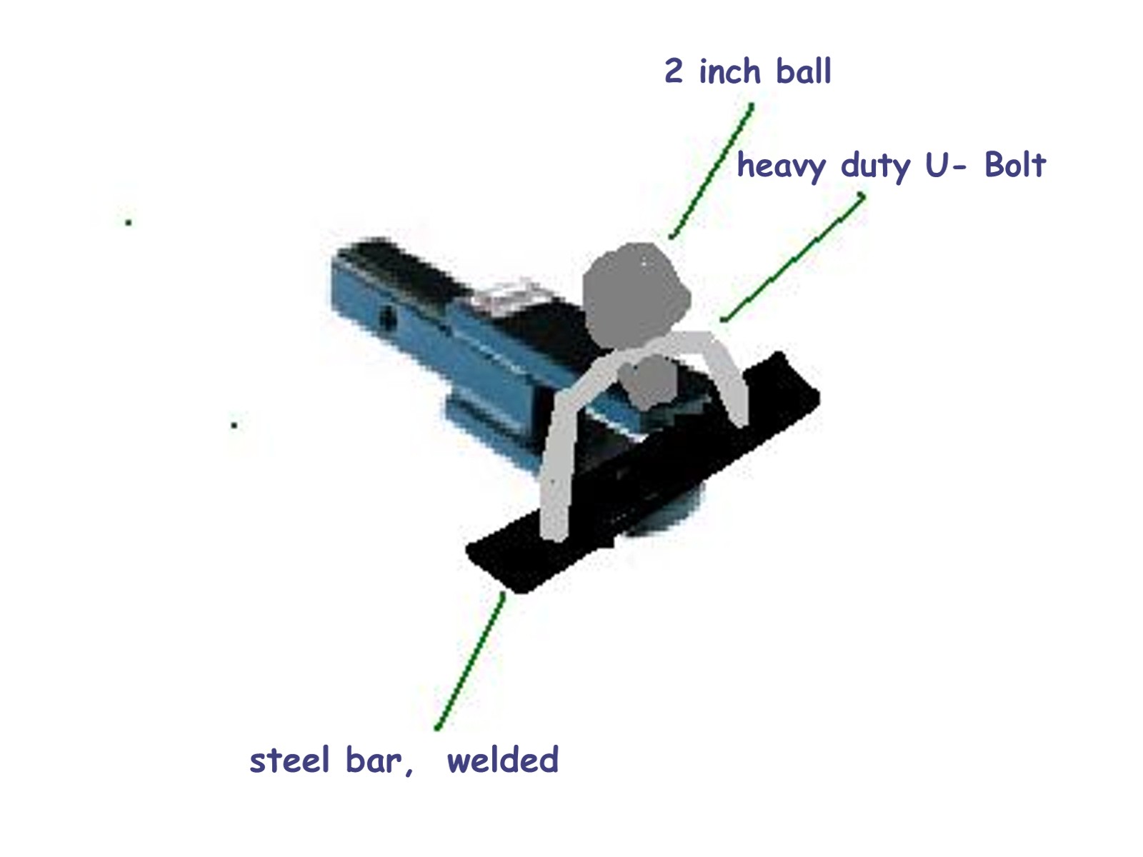

   / Dump Trailer / Backhoe Conunbrum #24
oops that drawing was backwards Try this one

I think the concensus is that towing a heavy trailer (7-8,000lbs) with the backhoe dipper stick is not considered a good idea. The forces on the hoe without the stabilizers down will be too great. The guys who do it currently claim it's pretty easy and the jack-knife potential is low. ALSO...I can tie into the front hydraulics and dump the trailer from the seat so I don't wear the battery down. I guess the battery is good for 12 dumps per charge.
The latest idea (I posted the same question in the General Discussion group) is that the trailer is to be pushed with a quick-attach ball for the loader. That way I can use the hoe to fill the trailer, then spin around and lock into the ball and push it to the dump location .
