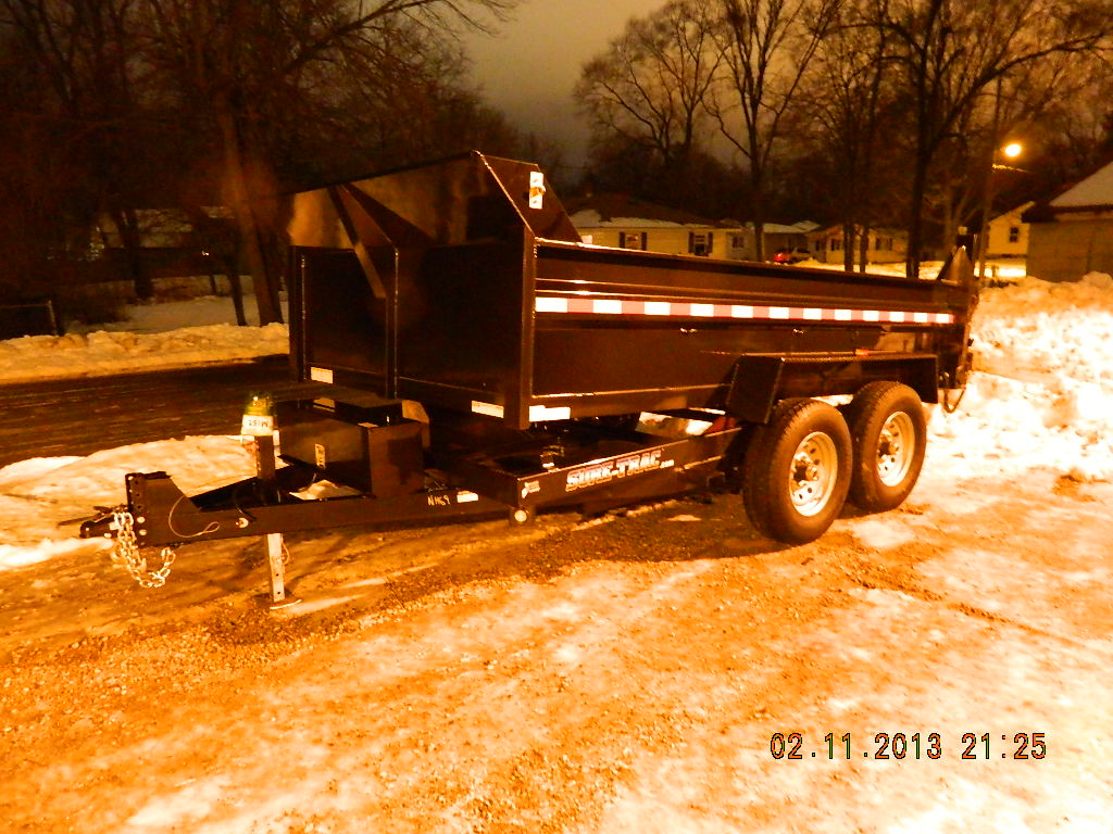

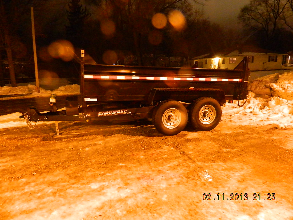

Well I took the day off and picked or the dump trailer.
Dealer didn't have the lunette ring so I had to use the 2-5/16" ball coupler.
I decided to order one off the internet when I got home.
The trailer had white spoke wagon wheels but the dealer didn't have a spare to match.
So I had them swap tires and rims from another trailer that had silver Mag Mods.
I like the looks of them better anyway.

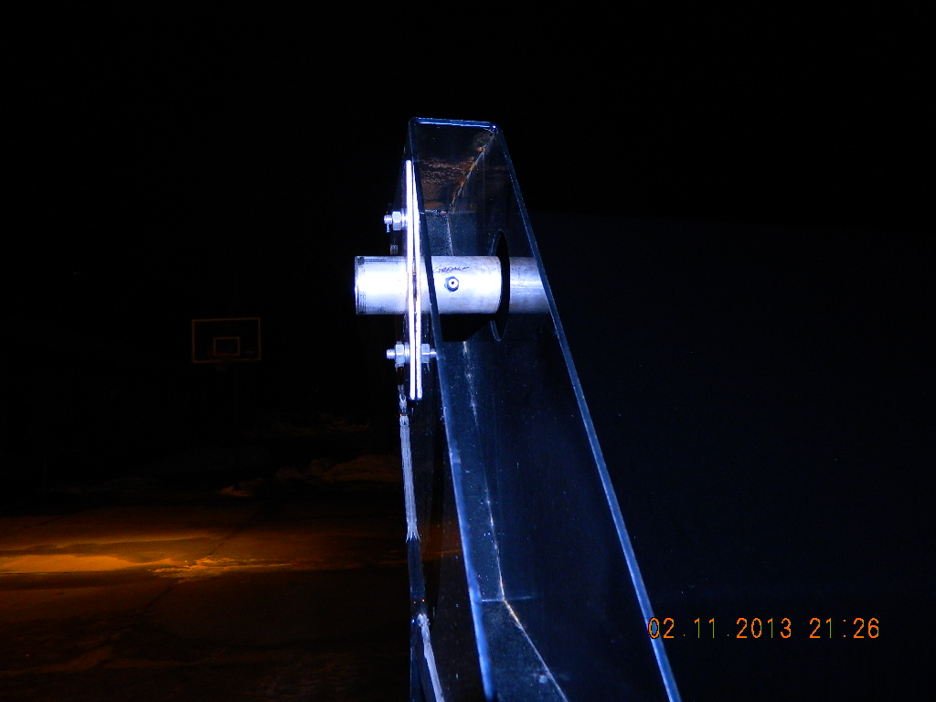

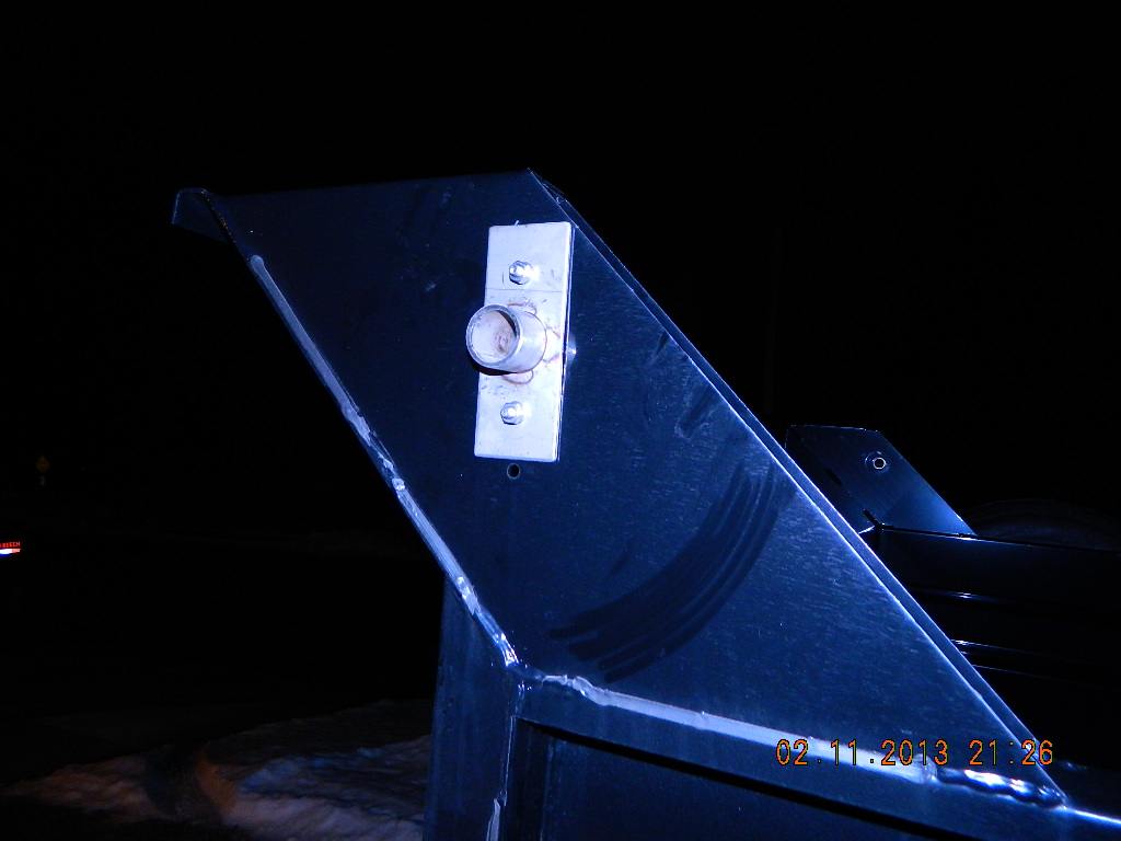

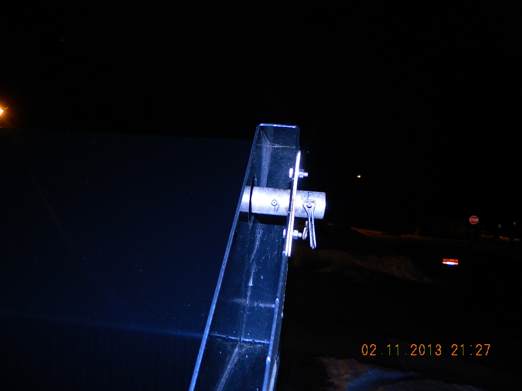

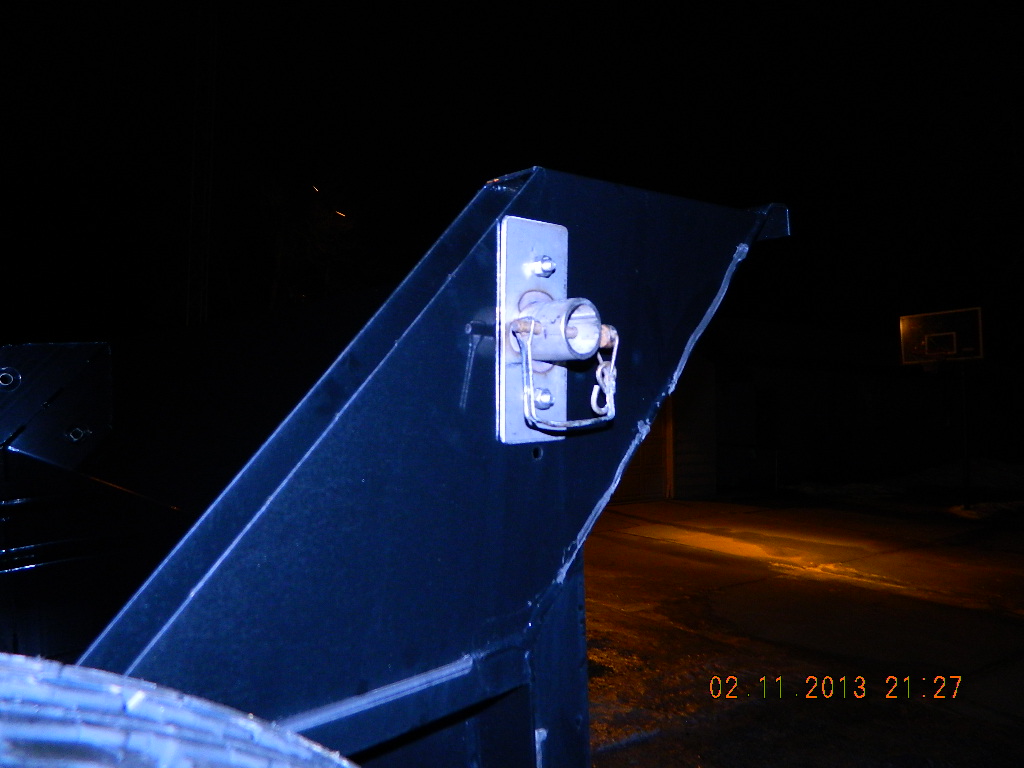

I was home just after lunch and started fabricating a tarp roller.
A replacement mesh tarp is around $75 - $85.
I can't see why roller bearings are needed for something this simple.
I am using 1" bar, pipe brackets and 1" sleeve collars to hold it in place.
The trailer has been sitting outside for awhile and the silicone around the seams is weathered and peeling so I will reseal them this spring.
Empty the truck didn't even know it was there, but there is enough tounge weight that it rode much nicer down the counrty roads.

It looks nice Tom. I like the silver modular wheels, they are favorite trailer wheel.
