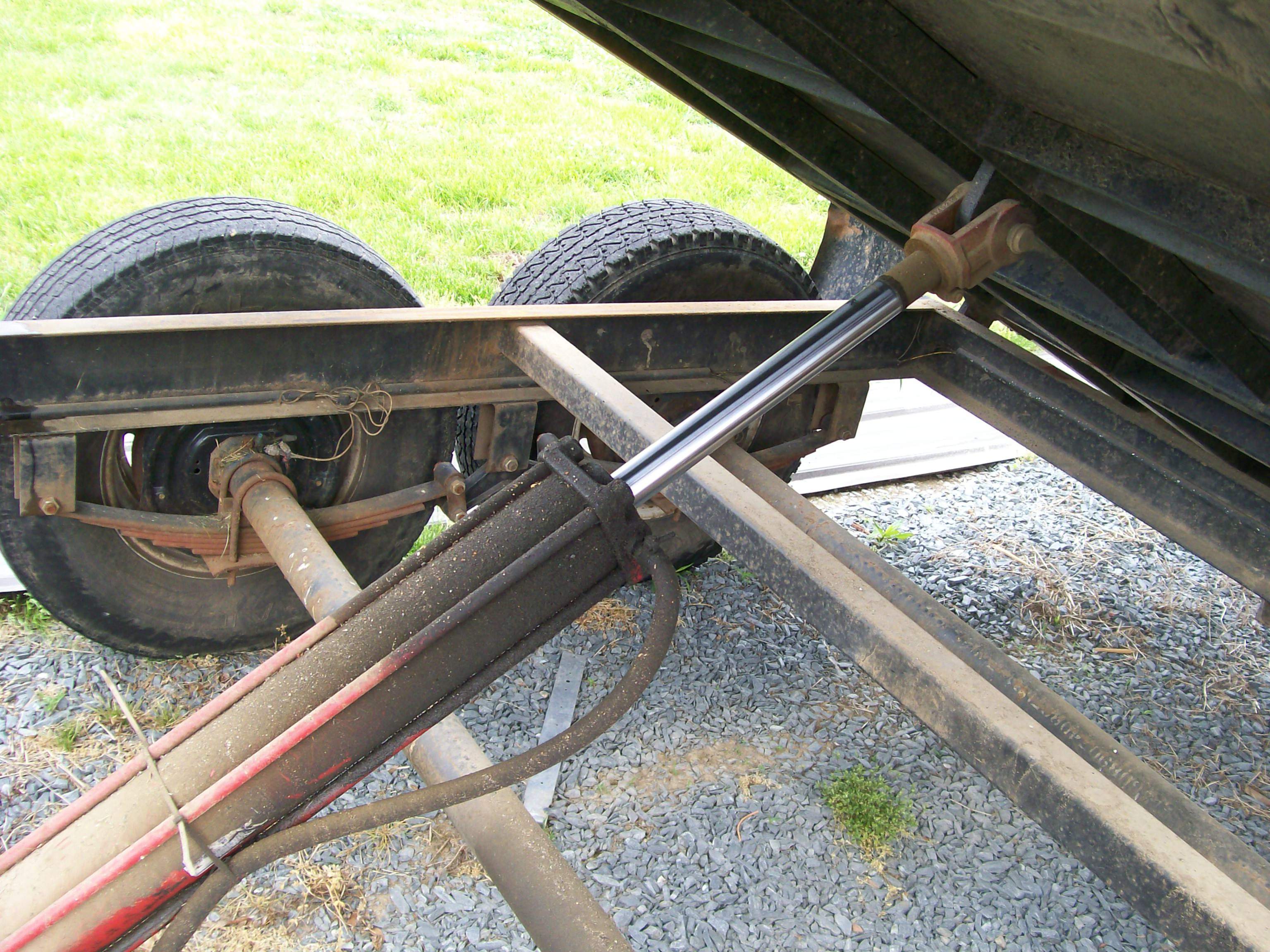

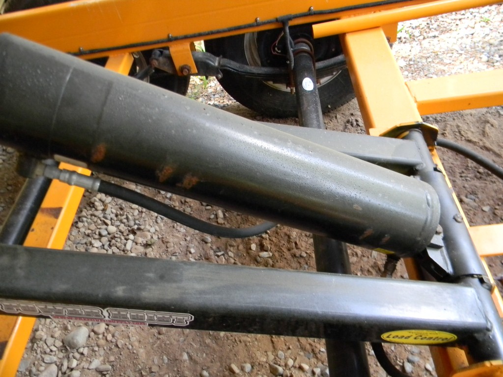

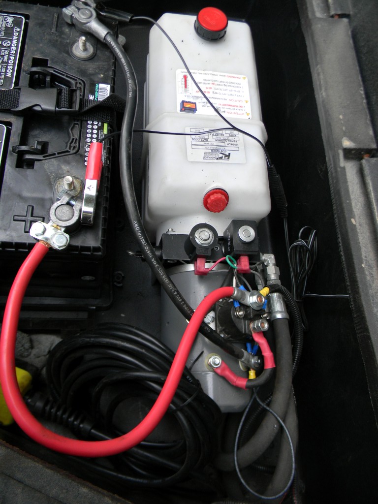

Here's some pics of my two systems.
The first two pics are on my tilt bed car trailer. It's a double acting cylinder but I'm only using the bottom port of the cylinder because it is power up and gravity down. The pump doesn't run going down, valve handle just releases pressure and fluid runs back into tank through the pressure hose.
Second two pics are my dump trailer. It also has a double acting cylinder but has a hose on both top and bottom of cylinder since the motor runs for power up and power down.
Since your motor only runs to power up yours is probably wired to release a solenoid when you push the down button. It's the same setup as my car trailer has except the previous owner ran an extra hose from the top cylinder port back to the tank. You should not need the upper hose as fluid would run back through the pressure up hose like mine does once the solenoid releases the pressure.

/ Dump trailer hydraulics #36
That is fine if your reservoir is large enough to hold all the fluid needed to fill the cylinder. If the reservoir is smaller it won't work without the second hose which can utilize the upper cylinder displacement.
