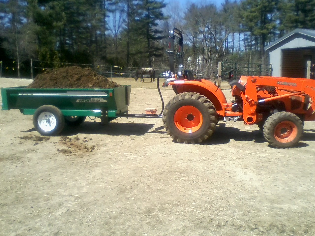

That''s a small trailer for your tractor , You can run it off the rear remotes if you have float you can run single action power up (gravity down ) or two lines power up power down like mine.. 0413161324-00.jpg
