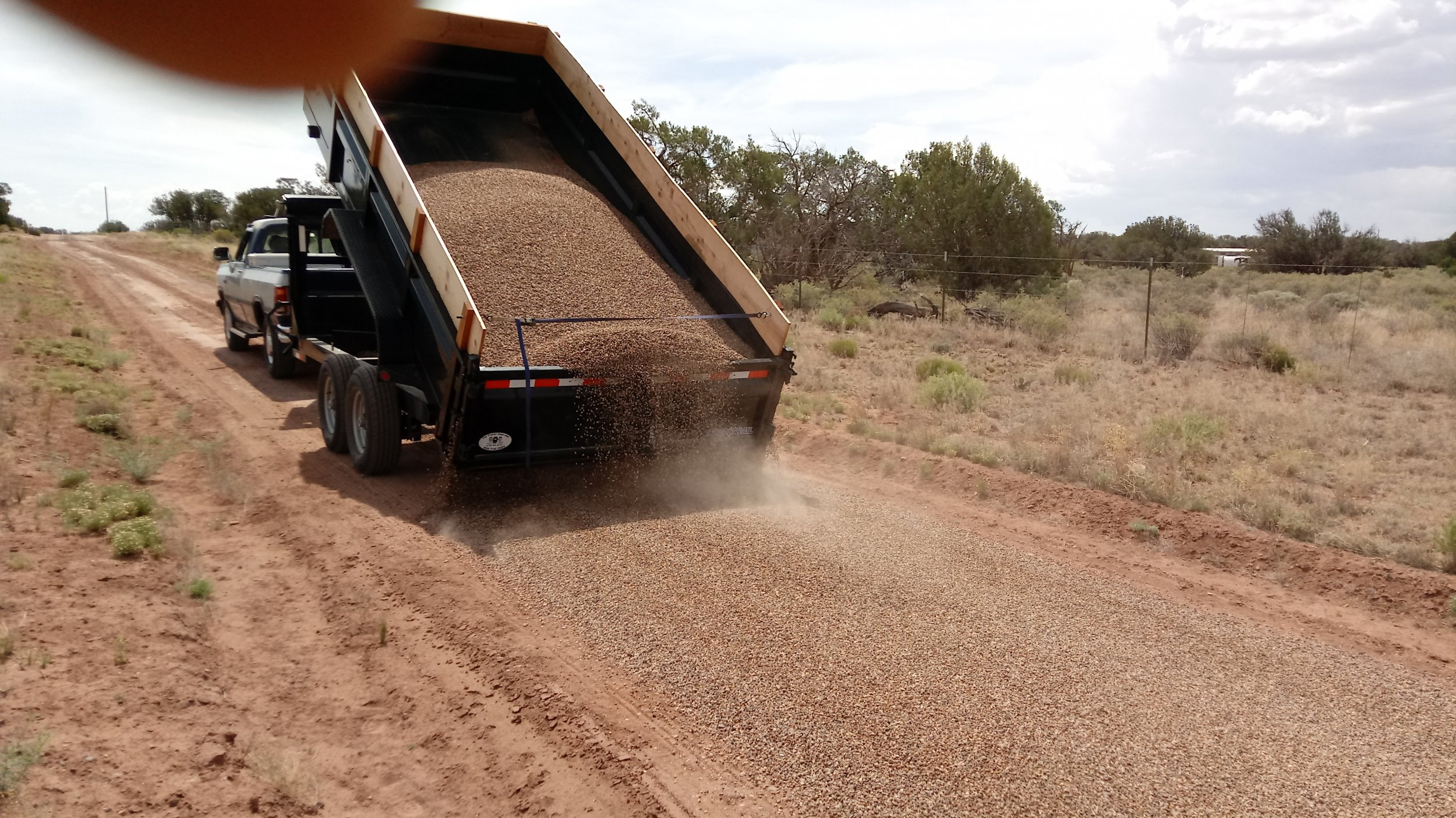

Can a dump trailer spread decently?

I agree with LD1, go 7'x14'x14k, perfect homeowner size. How high do you need the sides, what gauge, 7, 10, or 12? You will use it constantly, they are the most versatile of all trailers. Be sure to add ramps, tarp kit and 2-3 way tail gate. They do a real good job of spreading but it takes 2 people, one to drive and one to operate the hoist/gate. I haul commercial with no issues with batteries. I have two in the one I use the most. Always plug it in overnight.
Do your home work, they are all over the place with quality.

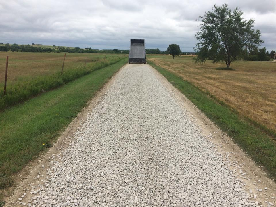

4th. may be a regional thing, but I'd let the dump trucks haul stone for the driveway. The trucking companies and quarries around me that work together.....can deliver stone to me for cheaper than I can even buy it for, let alone having to haul it myself a few ton at a time. Makes no sense to pay more per ton and put the wear on my equipment. I'll just take a bulk load, and always have gravel when I needed. But hauling bulk mulch, or a little topsoil here and there, thats a perfect use.
I suspect it’s that way nearly everywhere and people just have a false sense of saving money by doing it themselves. Locally I can get a 22 ton load hauled for $100 haul bill. Trying to haul it 4-5 tons at a time is laughable. You’re only $20-25 per trip at that point and having to buy fuel out of that. I can haul 10 tons or a little better on my truck but I still won’t do it for $50.
   / Dump Trailer Questions #10
From what I’ve seen, it’s very regional. The only dump trucks that even get close to hauling 22 tons (legally) are all in the big cities. In my area, if you want 22 tons, in one load, it‘s either coming from a semi trailer or a guy with no insurance running very overweight.
The nearest quarry is 26 miles, from my house. Barrel bed end dump semi’s are getting $110-150, per hour, with most being between $110-120, per hour. Getting one load is tough. They like to bill, by the day, or you get the “I don’t want to do it” price.
