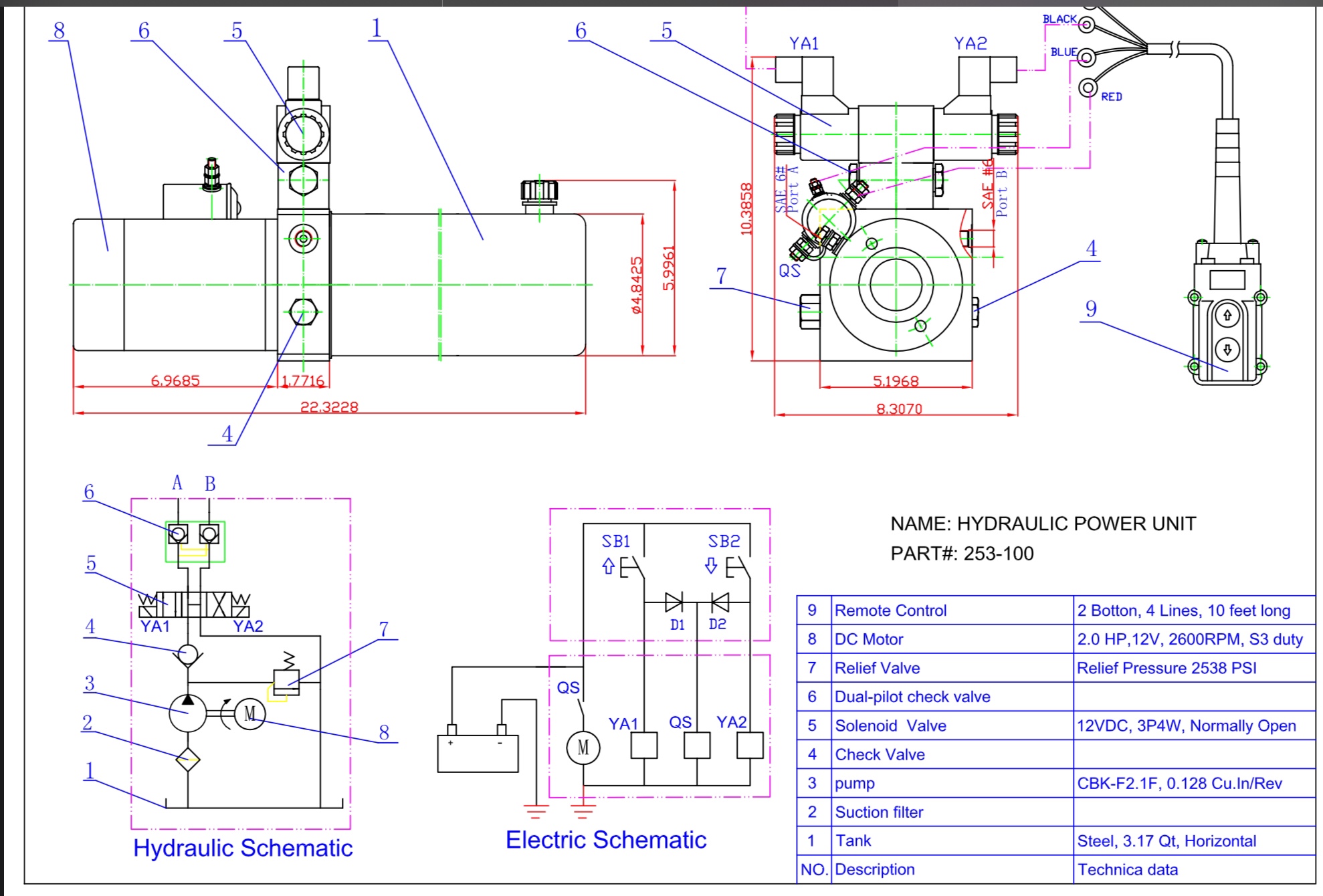

I don’t know OP’s unit, but my thinking is based on a typical like in the following. Unit goes up when path is though “YA1”, goes down when path switches direction through “YA2”, and hold when there’s no path like shown.

A lift system like this should only need a regular spool valve; when it's in the raise position it activates a switch that turns on the hydraulic pump, when it's in the lower position gravity does the work, just like a fel or forklift with the engine off. The top of the cylinder is usually vented with a sintered bronze fitting, or a vent hose.
If it has solenoid valves, like some kind of Bobcat hand control system, it would need some kind of electronic control to feather the inputs, and even so, a full scale downward deployment should be well within the engineered specs.
