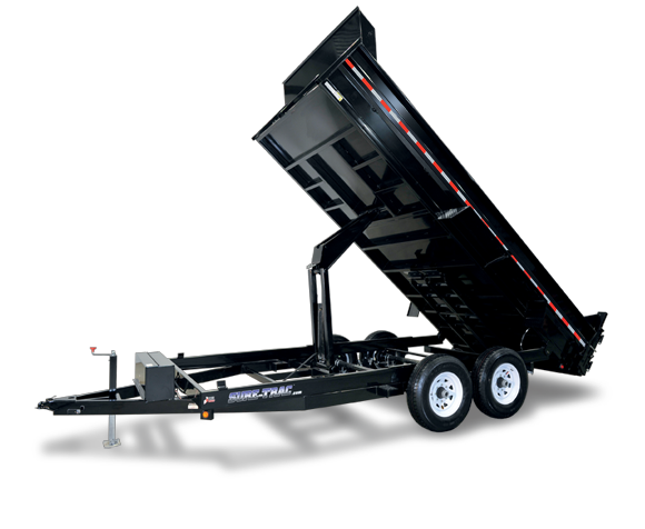

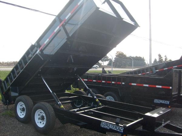

I am in the market for a dump trailer with GVWR in the area of 14,000 lbs. I'm looking at 'Sure Trac' and 'Bri-Mar' brands. Some trailers use two pistons to lift the bed and others have a center single lift arm. The SureTrac dealer advocated a "gravity assist"(?) benefit with their trailers that is supposed to be faster lift and drop time. Can anyone please explain pros/cons to the different lift systems?
The best of the two will be the 'hoist' type unit that uses a larger single cylinder within the operational confines of a cage to lift the deck. Reason why? The hoist removes lateral straight from the hinge points on the trailer and channels all of the energy produced by the hydraulics to lift the bed.
A dual cylinder system when first collapsed exerts some pretty ugly forces laterally against the hinge pins, when the pins resist this strain, the cylinders swivel upward, still pushing out until they have swiveled up.
From my experience, you will love the 'hoist' type unit a lot more in the long run.
   / Dump Trailer: Single lift vs Double lift #45
Very good point!
I never thought about that but it's true since the hydraulic pistons are laying flat when fully down so when they expand, that force before the bed lifts is completely on the hinges.
