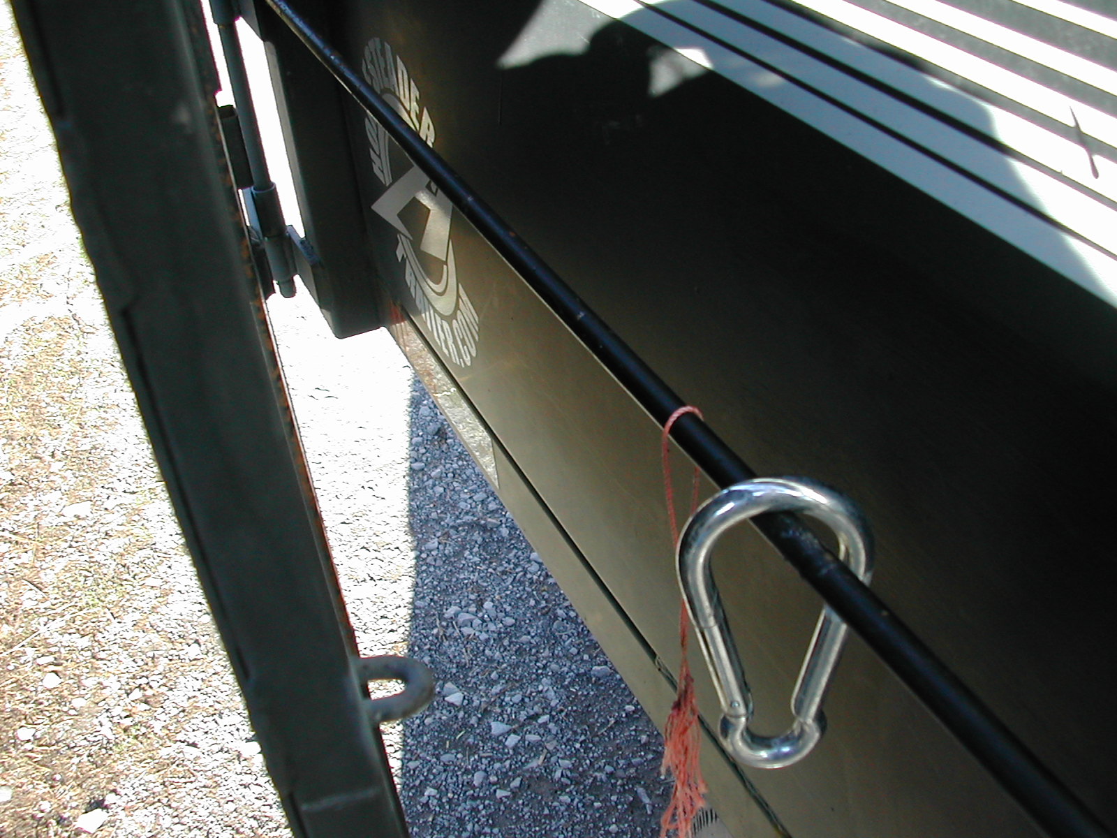

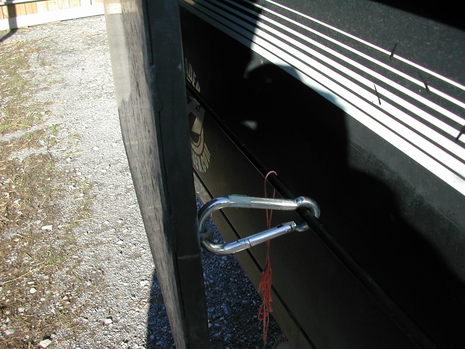

Did the tie backs a day or two ago, I am loosing track of time with this house project going on :)
Anyway, I guess it was not orange bailing twine,,,, she had some mason's line handy :)
   / Dump trailer tailgate, spread to barn door #14

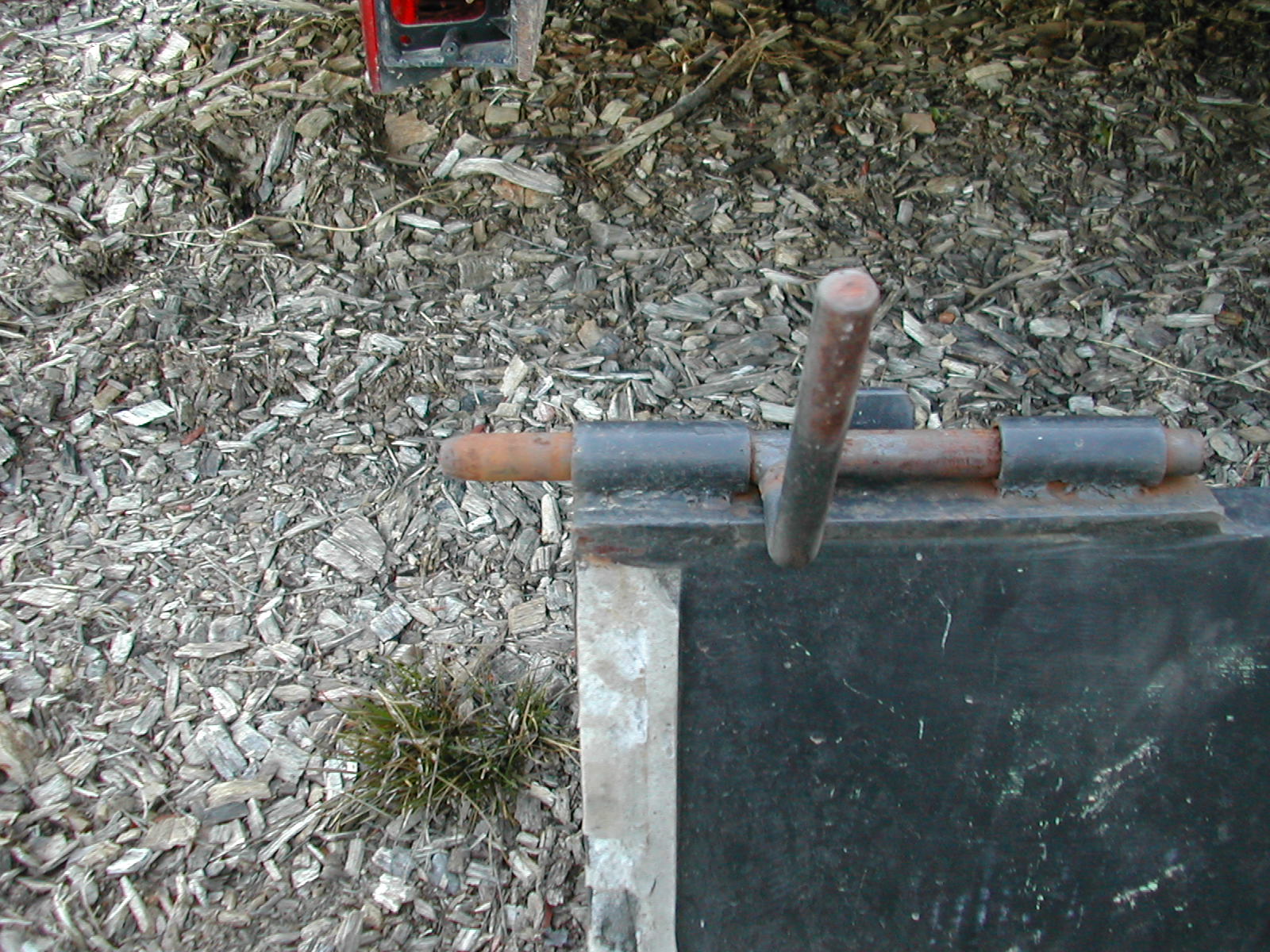

That is the same caribiners that I use. My trailer does not have the rod like yours so I had to install an "I" bolt to the flat stock that is welded to the side.
The caribiners are much easier to use and won't just come off when you dont want it to:)
