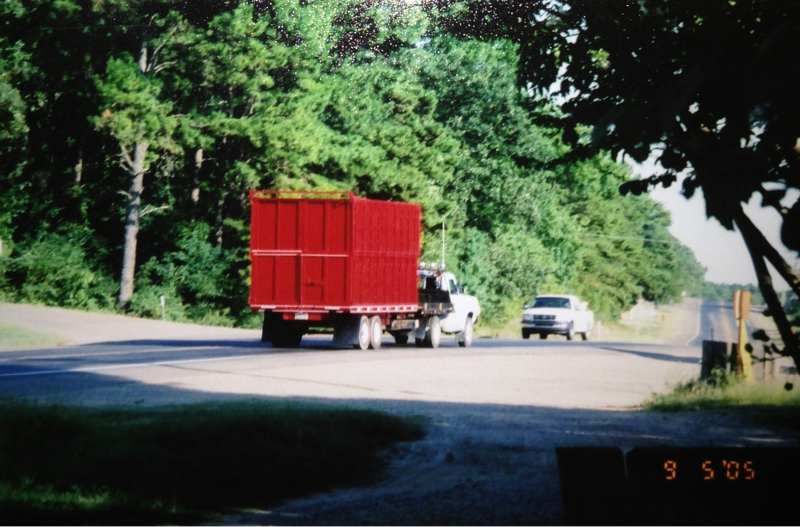

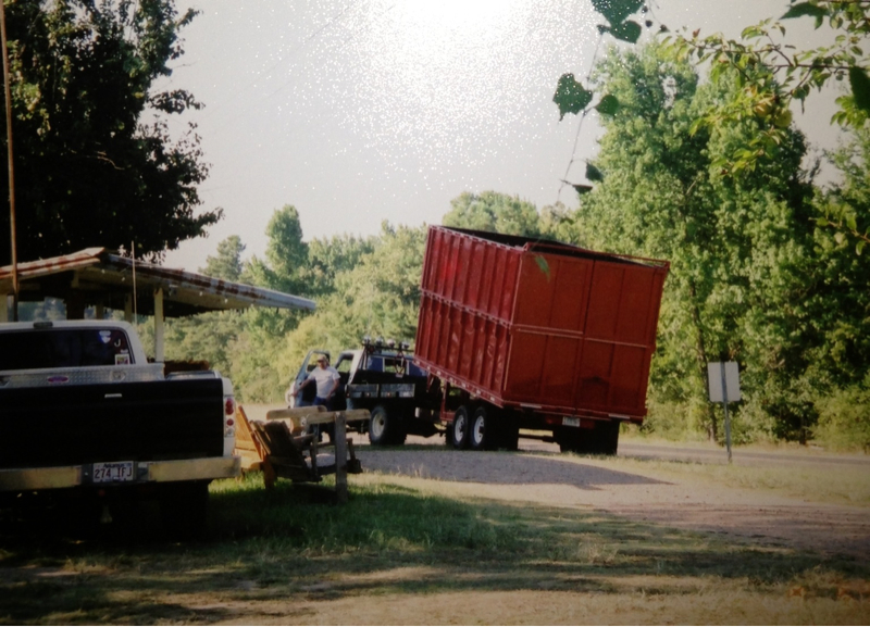

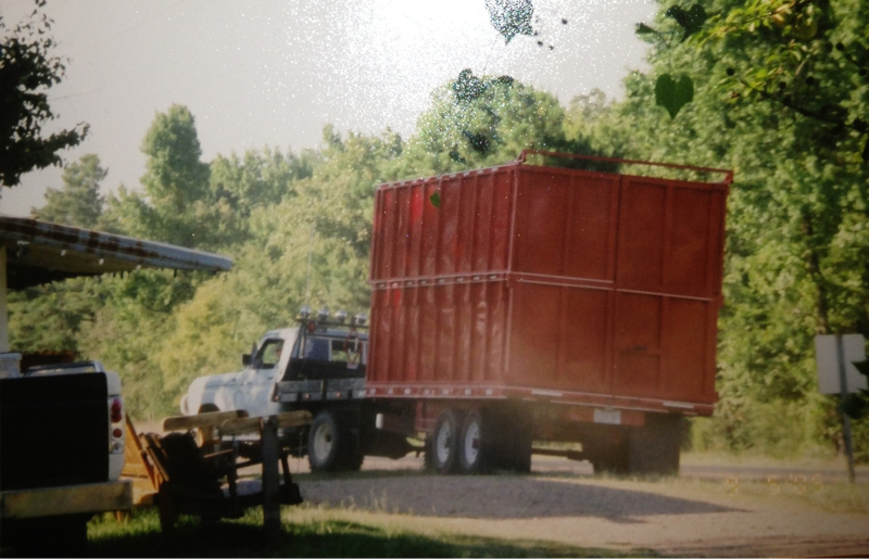

I have 2 a 16' tandem axle gooseneck and a 20' dual tandem gooseneck . ... My 16' the red one is a 1972 model we picked up for a steal . And we gave it a over haul and face lift . We bought it and the other to do hurricane storm clean up . They both have removable sides . Here's my 16' looking for pics of my 20' . I will say this get one with remove able sides . Weld side make them real narrowed to use .
The red one I have 1' , 3' , 4' and then another 4' that goes on the first 4' to make it 8' as pictured .
My 20' is the black one I run the 1' sides most the time . But have the stock 4' then another 4' to go on them to make 8'sides .

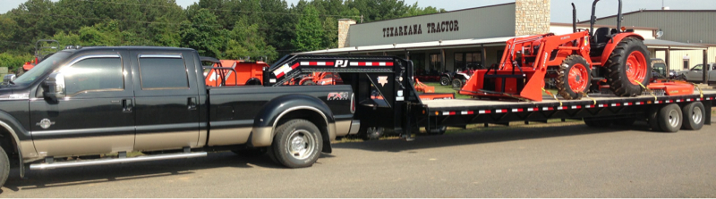

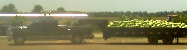

My black one is used to haul melons now more than anything else . It's a PJ brand they make the stoutest we seen that's why we bought that brand . I live about 1 and a half from 5-10 different company's and it was the one we liked .
Buying removable side ones make them able to be used for any thing .
I have winches mounted on both on the necks also that I use to haul old rigs I buy that don't run . There's just tons of uses for them .

My pj 20' cost $10,500 new 2005 I believe. . It's a great trailer the powder coating is holding up great . I have dump over 20,000 pound loads with . No problem . I did have to go to 14 ply tires for it hauling melons .
