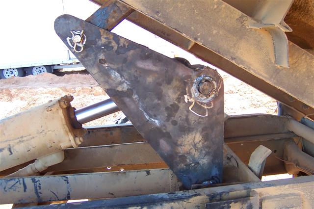

I picked up the bracket on Tuesday, but didn't get a chance to put it all back together until this morning. The bracket had to be tore apart, straightened and the welded up perfectly square with the other one. The welder I used did this and also line bored the bushings to make sure it was perfect.
Cost was $421.
It went together with quite a bit of effort, but after about five hours, it was done. I greesed it up realy, realy good, then started hauling dirt. I put ten loads thought it without any problems.
The pics show the brackets back together and in place.
