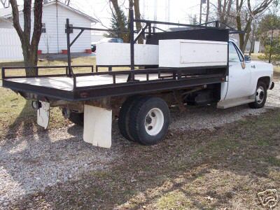

Here's an update. I've spent some time learning to weld. I bought an ac/dc stick welder. I've welded stake pockets to the bed and a c-channel to the headache to hold 2x12 side rails. I made the stakes from 2 pieces of 1/8" angle iron wrapped around a 2x4 so they'll be nice and strong. (That was a pain..) Next, I'll find a piece of metel to weld over the stakes so we'll have something to tie straps to.
The clutch is replaced, removed dash and replaced all the little light bulbs.
I'm about ready to give this thing a test haul... /forums/images/graemlins/smile.gif

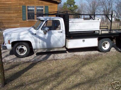

Was cruising the site and found this ole thread. Thought I'd give ya'll an update. The dump truck is looking good. After I taught me to weld, <grin> I''ve now got the stake pockets weled on, and sucker rod going down the side to tie to.
Best of all, I got some diamond plate and welded a metel bed over the existing wood. The bed is all painted up with side boards etc..
I took her to the shop yesterday to have the power steering leak fixed.
Ole beater is lookin good. When you load the 12' bed up with firewood, you don't even know it's back there going down the road. ha!
The next step is to figure out if I should weld a hitch on it somehow. Being a 12' dump bed, I'm a bit unsure how I'm going to do it. The frame sits back under aways.
And should I even try to trailer with a 12' beded truck??
Just having fun!!! (Well, I was until my wife made me paint the house) :(

There's no reason NOT to pull a trailer with a 12' dump bed. It's done every day. As to welding a hitch on, that's not a big deal at all. Just make sure your stinger/ball/coupler doesn't extend beyond a vertical line from the back edge of your dump bed floor when the bed is fully raised.
Also, make sure you know what you're doing when you're welding something like a hitch. You're dealing with, literally, millioins of dollars in potential liability if that thing gives way and your loaded trailer come free and knocks that busload of lawyer's kids off a bridge. :)
