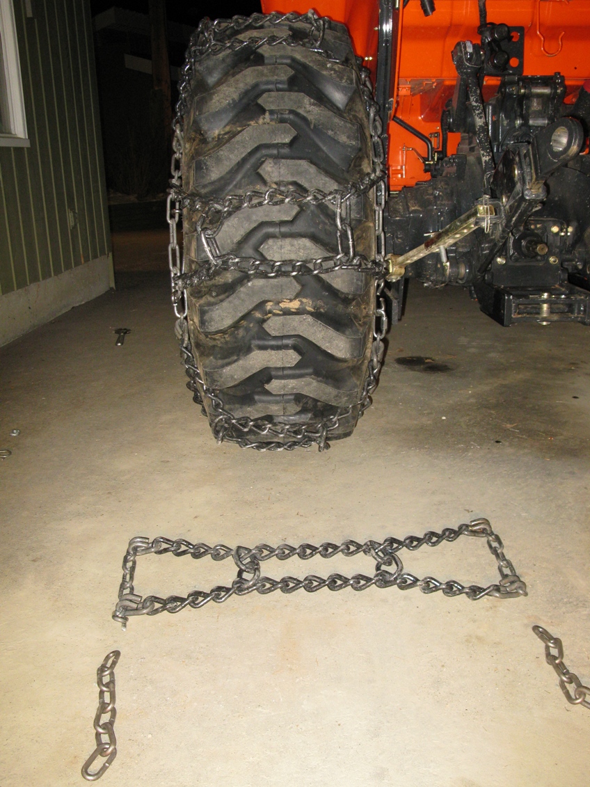

I finished the chains Thursday and mounted them today. They are MUCH smoother and will be more effective. Part of my original roughness is that the cross chains are a link longer than they should be, leaving a larger gap between the DUO patterns.
The modifications went much easier than anticipated, taking around 4 hours working time but with lots of breaks.
As hoped, adding 4 patterns to the existing 7 tightened up the end-gap. The DUO patterns end at the best possible location but I will still fill in the end gap with one single cross chain, where I required two cross chains before.
Photos of the original chains:
The DUO pattern gap was about 4 tire lugs and 2 cross chains were required to fill the end gap.
Photos of the new chains:
The DUO pattern gap is 2 tire lugs and I will add 1 cross chain to fill the end gap.You can see the gap on the right tire in the last photo.
The original chains made for a rough ride because the inter-pattern gap caused the tractor to go from on the chain, to completely on the ground, and back on the chain. With the new chains the tractor is always riding on one of the cross chains.

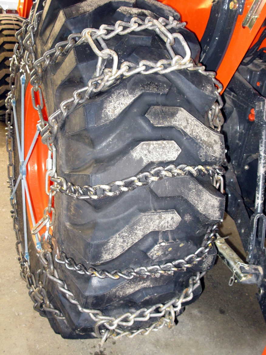

Since modifying my DUO's two years ago, I wanted a better solution to using a single chain to fill the end gap seen on the right tire of this photo:
The single chain worked, but after much use the patterns can shift as shown here:
I ordered a couple more DUO patterns and 10mm link couplers to rework the end gap as shown here:
I have not used the chains but I think it will stop the shifting around the end gaps.
Purchasing the pin couplers was interesting. CanadianChains.com quoted $15.00 and $16.00 EACH (including delivery), for 8mm(which I will use for some smaller chains) and 10mm couplers. I got them from a local shop (Western Equipment, Vernon) for $2.78 and $4.92 each.
