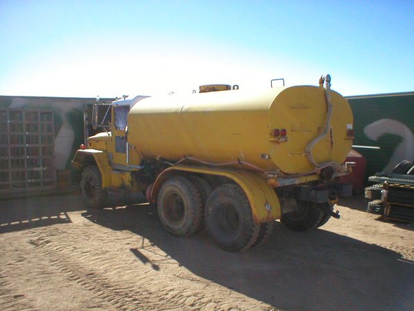

If you follow a water truck after it has just put down a load of water, I have found that there is little to no dust AND it is envioromently friendly :D unless you live where I do, then there can be a huge fine if you get the water on the pavement. :eek: :confused2:
