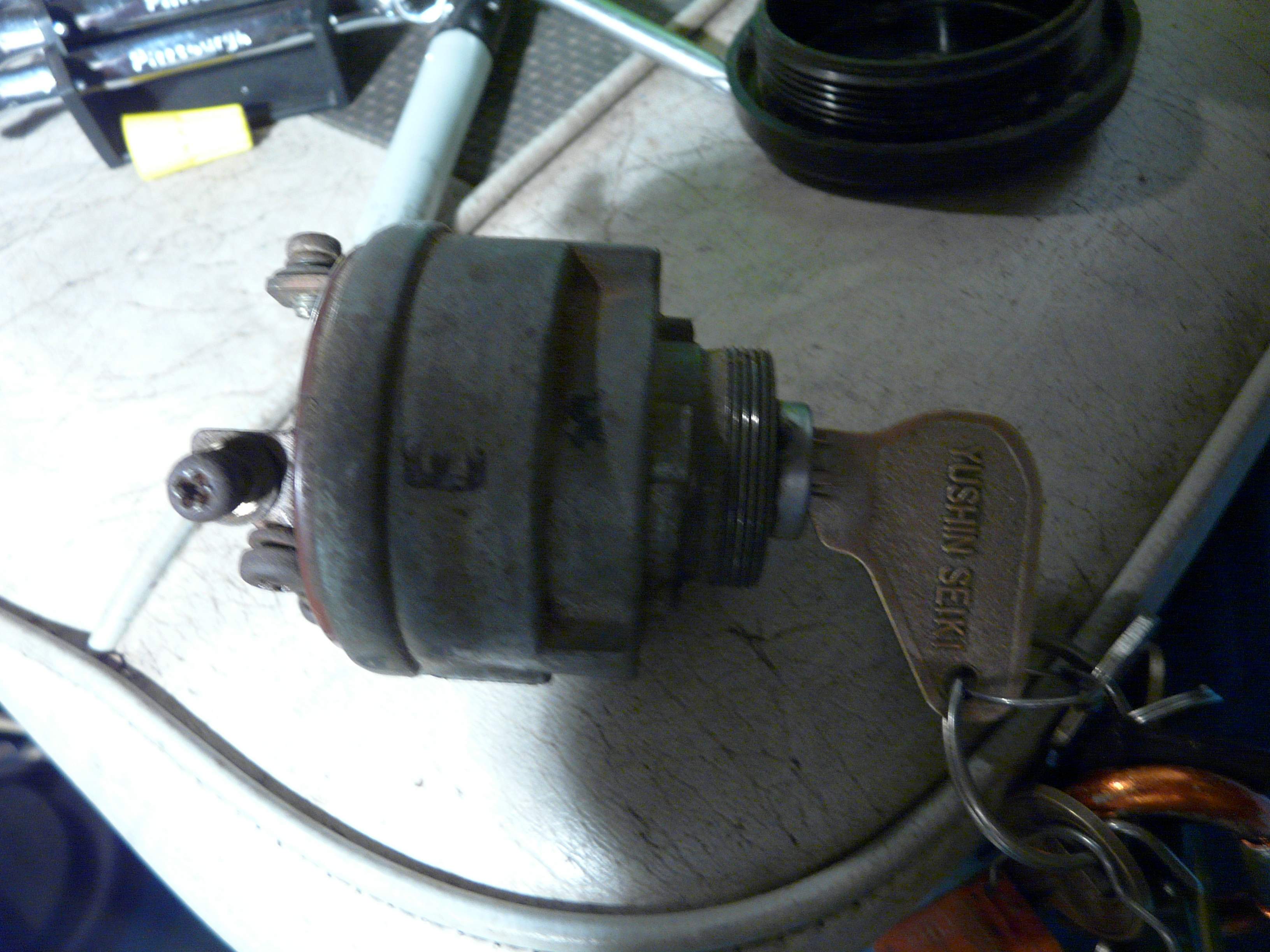

I am trying to attached photos of the ignition switch. I think it is the problem. If I jiggle the key the headlight come on.
However, the glow lamp will not.

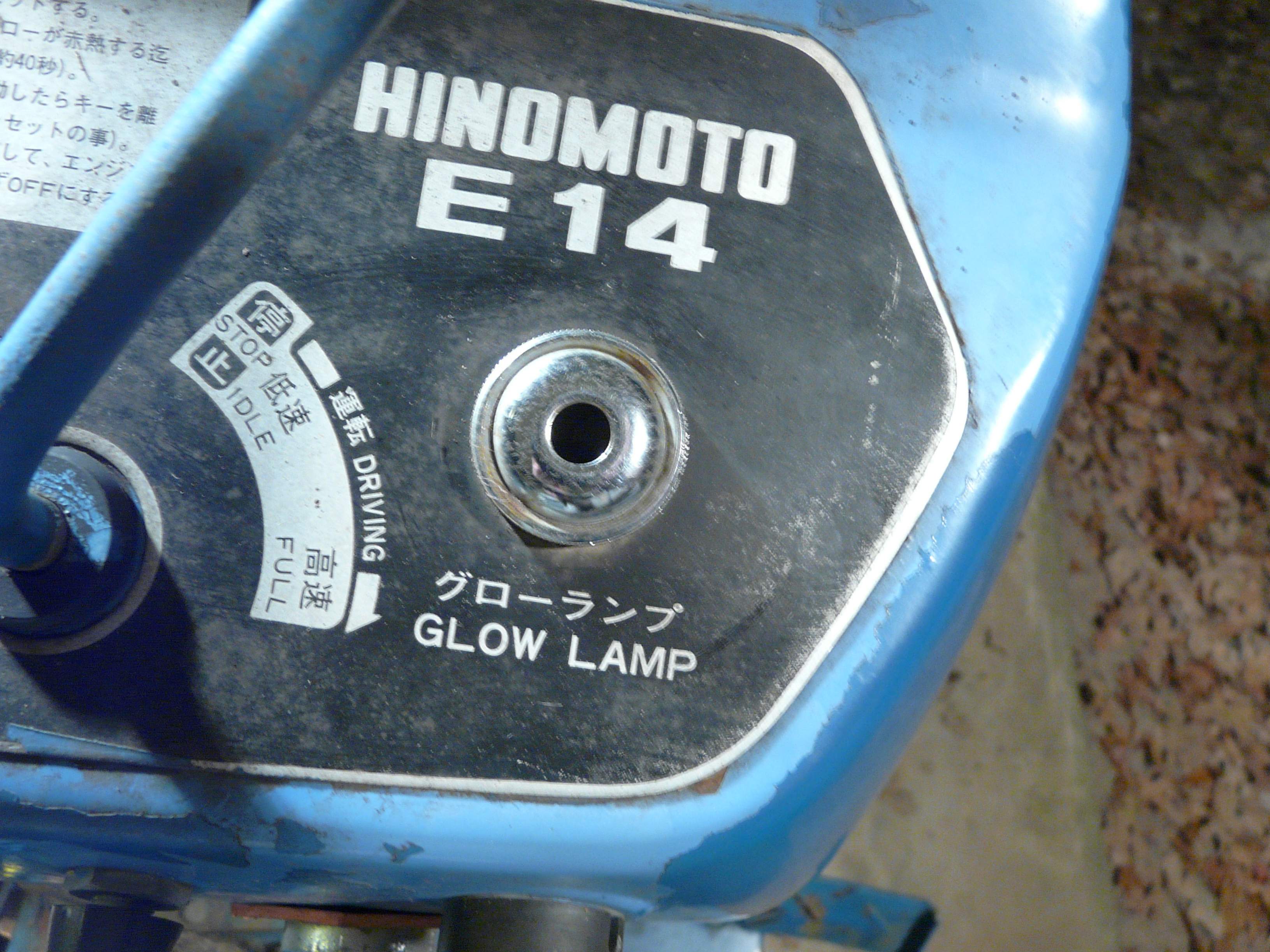

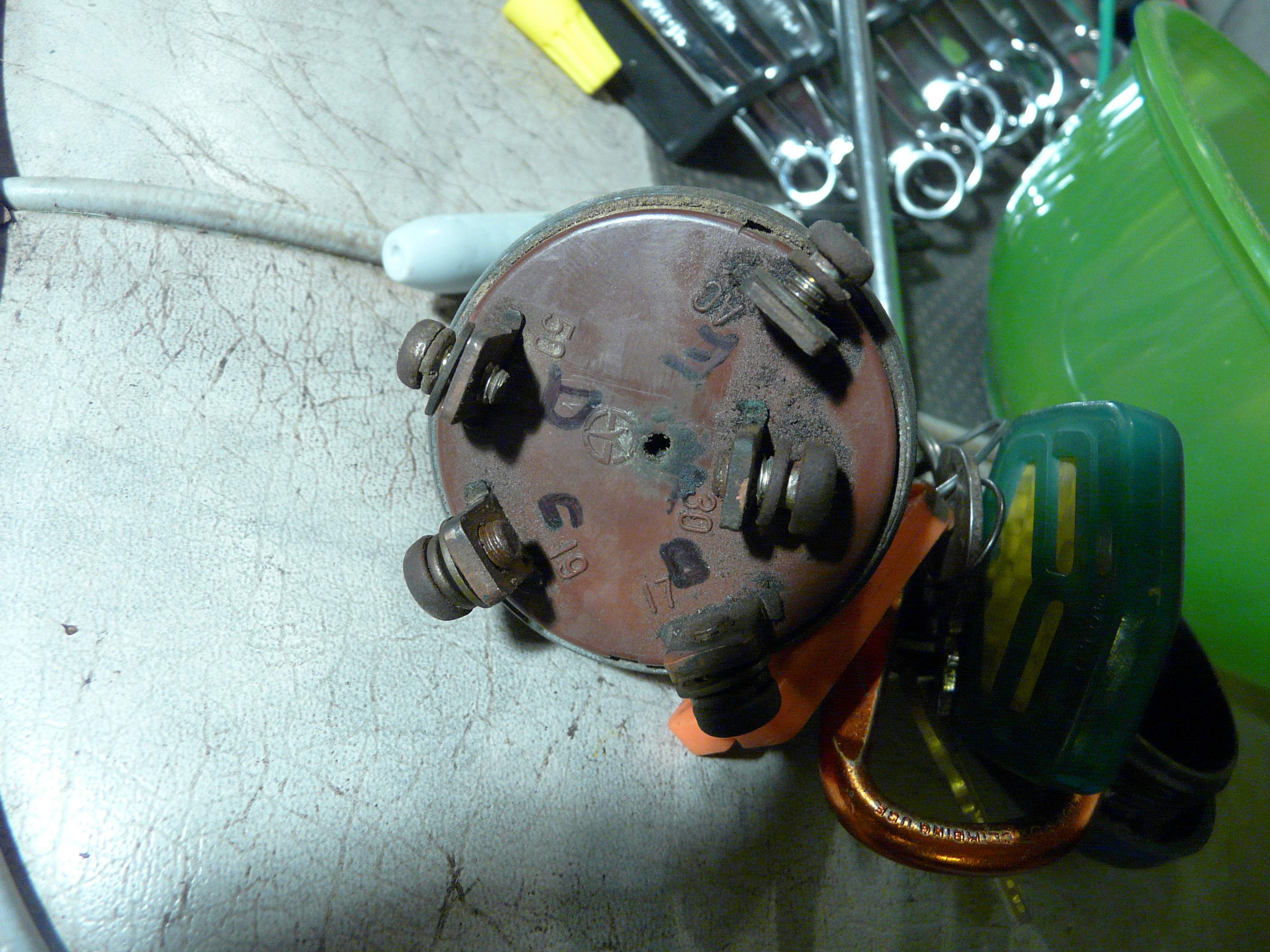

Here is the glow plug lamp hole and a shot of what it looks like from the under side.
No matter what I did with the key, I could not get the lamp or plug to heat.
Maybe that part of my switch has shorted out.

/ E14 Electrical problem??? #11
We had an old JD cotton picker that we could not get started and it turned out to be the ignition switch... bought a generic one off the shelf and it worked fine. Got it at just an auto-parts store... worth a shot.

I presume that the five terminal/leads on my starter switch are there for specific functions.
So far, the only thing I have found close to a switch that looks like mine, only has four posts.
How in the world will I know what can be combined? I'm afraid that I might short something out.
Any ideas on this?
Or better yet, does any one know where I can find a switch like mine? (5-terminals)

I bought an ignition switch from a Kubota dealer for my ISEKI it has the 5 terminals you need...... check your old switch with an ohm meter no need to be an electrical tech to perform this test....first take the positive off the main battery and remove the wire/terminal connection....then turn the switch to the glow plug the correct terminal should lined up with the key turned hard left...no ohm reading means the contacts are burned...you mentioned the battery self draining....I had the same problem while back....I blamed myself for this..as I replaced the old idiot lights with mini gauges and wired a small direct feed wire from the regulator to a semi ground connection by mistake....I know things happen...to trace a direct short take the positive battery cable off and with the key switch in the off position see if you can see a slight spark best to test this in a sort of dark area...as mine was not like a huge arc but I could hear and notice it....rewired it up proper and everything is fine now..... like the alternator is charging normal and no more battery drain....your glow plug indicater can be checked with an ohm meter as well... the ignition switch turned to glow plug heater sends dc voltatage to the indicater and the glow plugs....I think you also mentioned no headlights as well....hmmmm all points to a bad ignition switch as the accessories run off the ignitions switch..but also note you should have a fuse for all accessories not too sure on a fuse for the glow plugs...I think the glow plug indicator is some what like a fuse...someone correct me if i'm wrong.......hope this info helps....Ampa :):):):)

Jerry, Can you trace all the wires? To be able to use the 4 post switch, you would need to know what all the wire functions are to know if you can double up some wires. As a guess you just need to run the glow plugs through a toggle switch.
My Ford 1700 has a 5 lug switch and is likely to be close enough to work for you.
