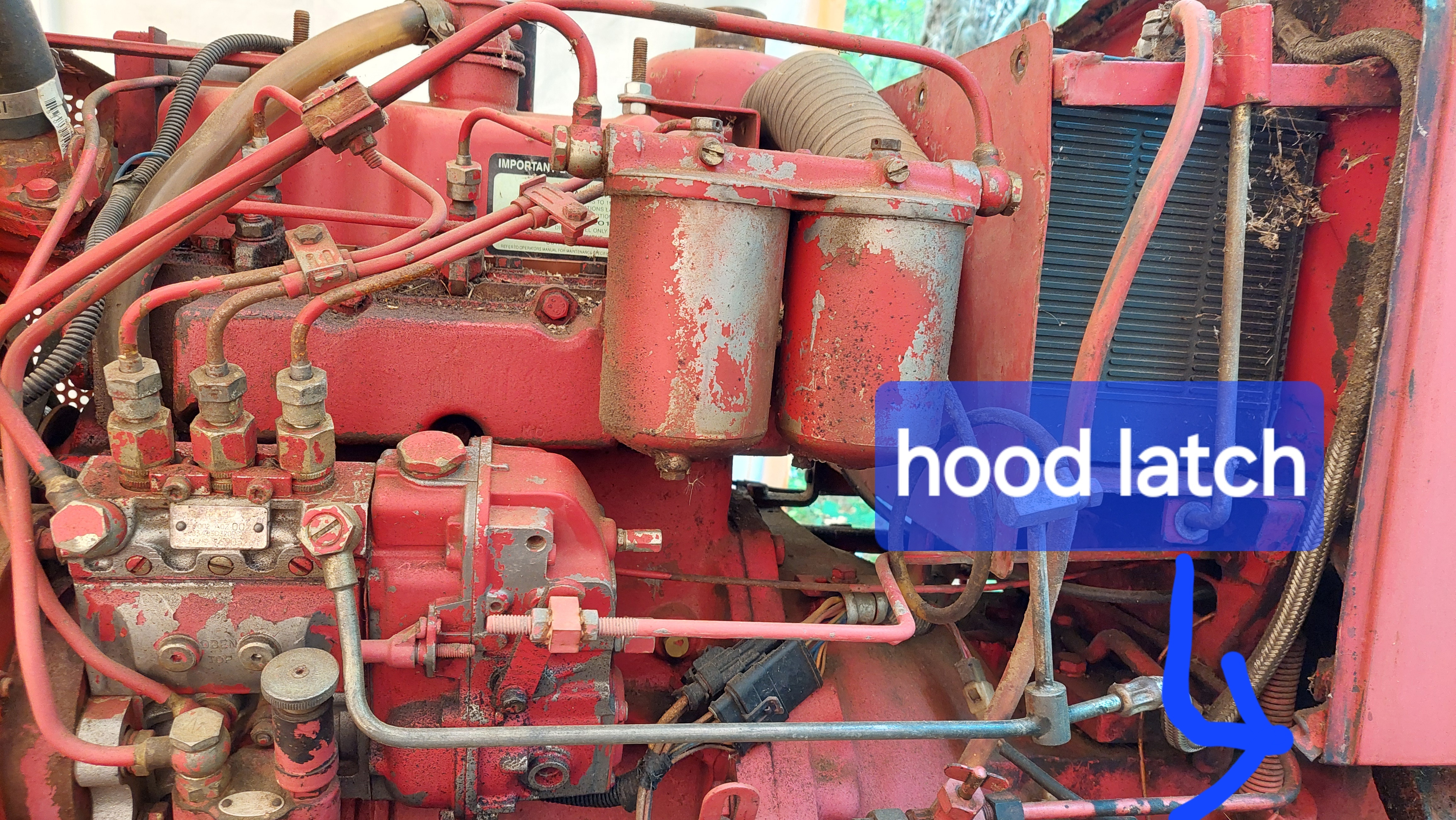

Sorry to hijack this post. Sounds like you have one. Just picked up a 350.
What’s the trick in opening the hood? Air cleaner coming through the hood keeps it from raising.
Thanks
Probably a day or a year late BUT...the air "pre cleaner" that sticks up thru the hood should pull straight up out of the hood. Then there is a little latch on each side down towards the bottom all the way in the back tucked up under just a little bit.
   / E350 Mahindra manuals #12
Tried to use a picture I had laying around to show the location of the hood latch/lock. There is another one on the other side too...if they haven't been taken off or broken.
