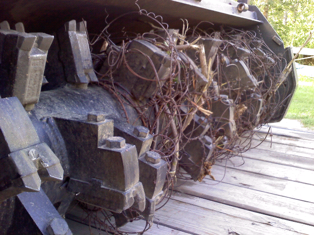

   / Eagle Claw Tooth #16
Who has the energy to drag an old mattress /couch box spring or whatever it was to the middle of nowhere.
   / Eagle Claw Tooth
#17
Just spin the heck out of it till all comes out. Been there with you name it including oilfield cable. Managed to pull fence wire in once and had to rebuild 150' of fence that really wasn't doing anything in the first place. Where's your gate? We couldn't run without the gate to spare adjacent houses, nosy onlookers and the poor surveyor staking the cut line. Plus we get a better mulch.
   / Eagle Claw Tooth #18
The gate won't work on the 320 so i took it off i learned real quick not to point it at houses or the highway but i put it back on when used it on the 268B kinda got use to it off tho.
